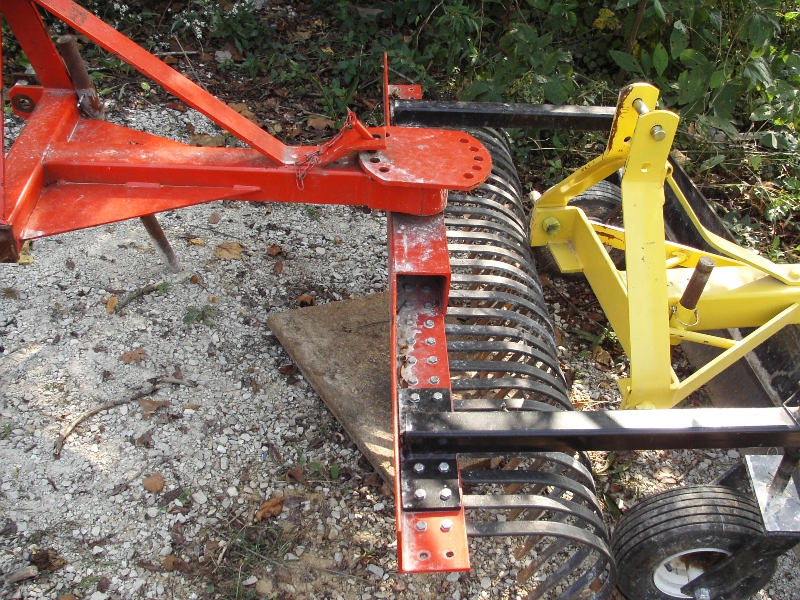

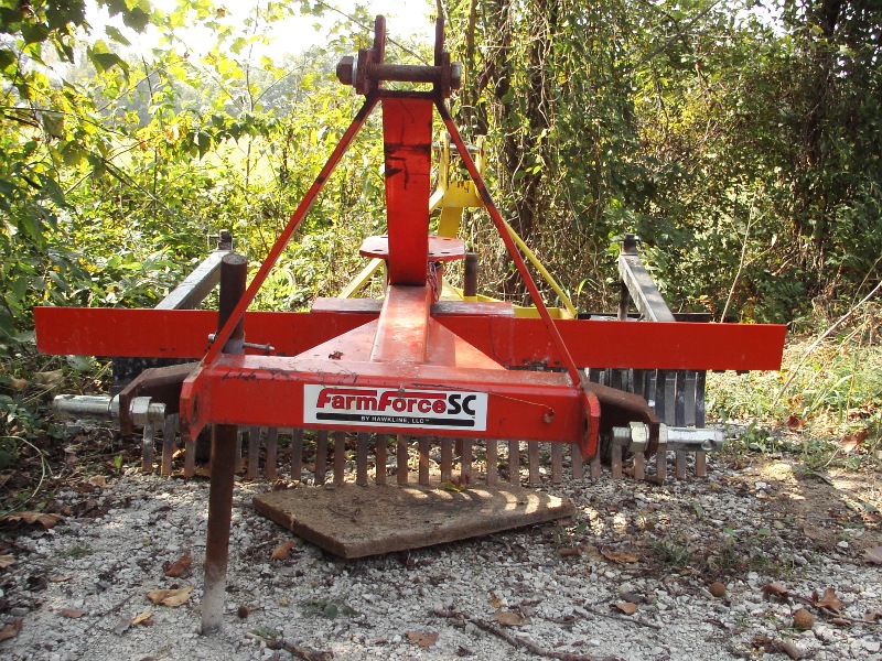

One more vote for 60". I have a 60" FarmForce SC with gauge wheels from TSC and it works great. One problem with this model is that it's made for CAT1 but has the pins narrower (20" verses the standard 26") No problem unless you want to use it with an Imatch or other quick hitch. I welded some brackets and a kick stand on to make mine hitch compatable.
The gauge wheels are well worth the money, really makes leveling an area fast and easy.
