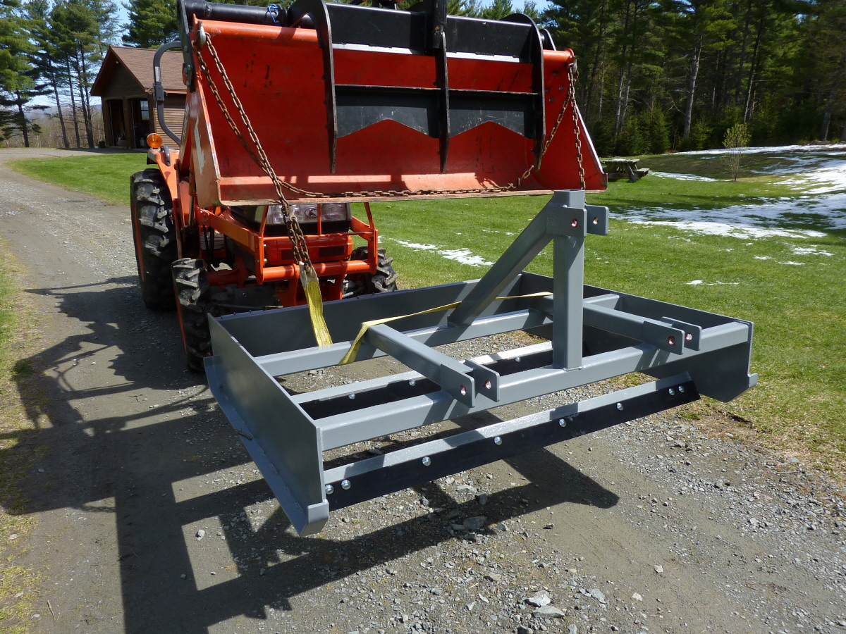

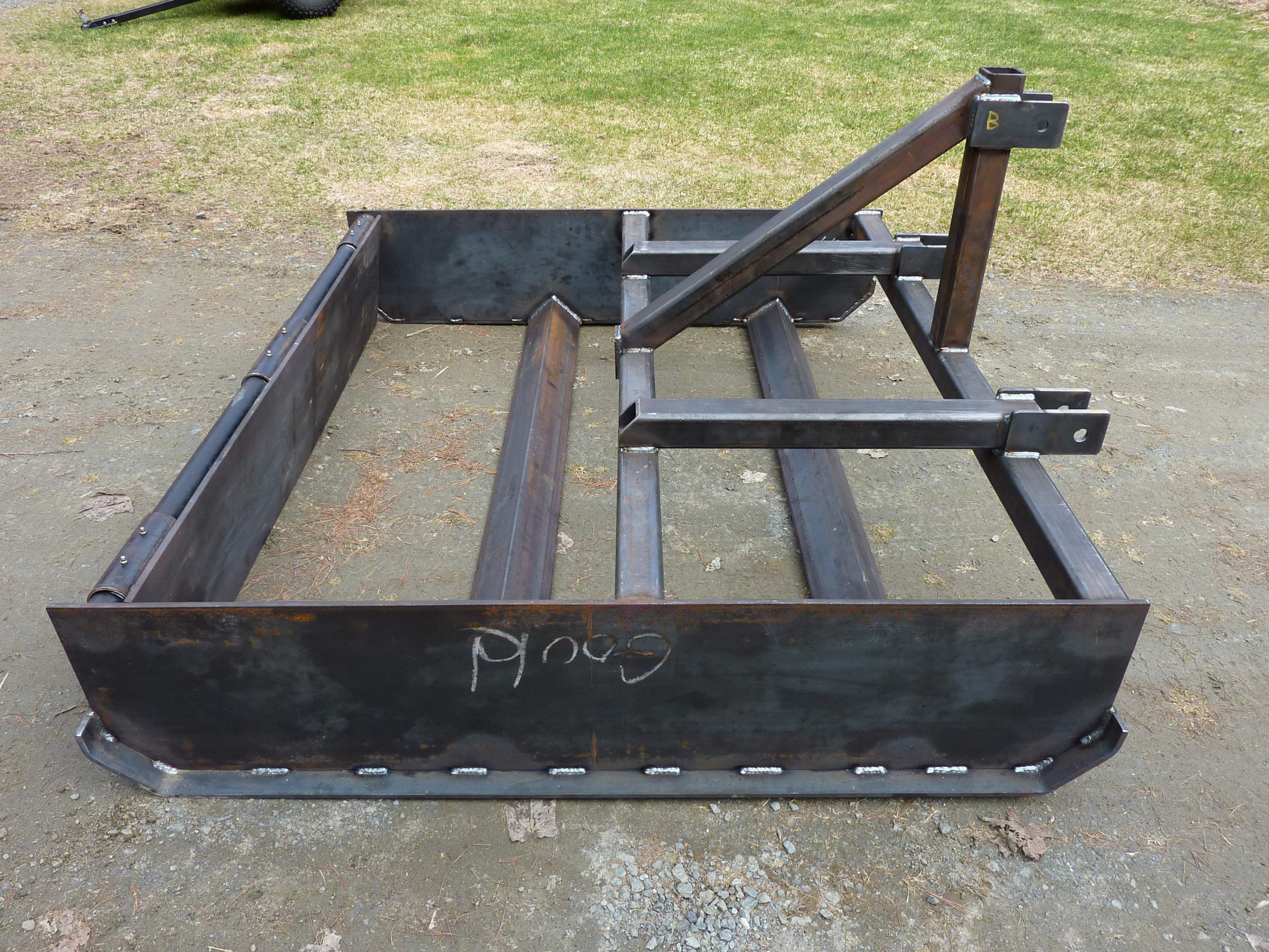

I can give you my experience with the land plane I built. YMMV
Body Weight. Make it heavy as possible for your machine....
My number one mistake. I wish I had made it a LOT heavier.
Body Length. Hmmm No one has really discussed this from what I have seen. Shorter would be beter for hilly roads, right? Longer better for flatter roads? And what is that longer / shorter measurement? Mine will probably be based on available steel but....
When I made mine I felt like a longer base would give a smoother grade. Worked out good for me.
Top Link... It seems to me that you would want the drag to float, I see all of the designs except one that the top link is solidly connected to the body of the plane. As I think about this, I wonder why. Wouldn't you want it to float, be able to angle up and down with a hilly road? I am thinking of a post that could bend and chains going to the rear of the plane. Anyone have thoughts on this?
I thought the same thing, and used chains when I first built mine. It was a mistake in my instance. The plane would ride up over the material instead of pulling it forward. I ditched the chains and added solid support. Worked much better for me.
Adjustablity of depth. Man, there is a couple of builds that are amazing, spin a lever and one end of the blade goes up. But at the end of the day, do those of you with fixed depth blades wish for adjustability?
YEP! If for no other reason, the blades will eventually wear down, whatever depth you decide. If I could just turn a crank it would solve a problem I am now facing after a couple of years use. There have been a couple of occasions I could have used another half inch depth on the blade also.
Final leveler blade. On two designs I have seen a final blade (usually just angle iron) at the very back that is straight. I guess as a final finish? Needed or not?
Has worked well for me putting a smooth finish on the road. The front balde digs up the dirt, the back one smooths it off.
FInally, I can pull a 6ft box blade pretty easily. Get it loaded, going uphill, and I drag down. I am debating wether I could do a 7ft blade (I would love an 8 to cover my tire widths but). Does a landplane take as much juice to move as a box blade?
Another one of the things I really wish I had done differently. I had read about the maximum width for a box blade for my size tractor, so I built mine to the same limits. I didn't realize at the time I built mine that a land plane does not pull as much material as a box blade, and my little tractor could easily pull the land plane if it were a foot or more wider. Would have made dressing the road easier.
Hope you find these comments useful.

My .02 from my experience with a 5' wide X 4'6" long 575 lb unit pulled by 30 hp.
Angle or no angle blades. -
Angled blades lead into the cut better but straight blades work fine. If I was to build another I would angle each blade the opposite way.
Body Weight. Make it heavy as possible for your machine....-
Absolutely !!
Body Length. -
I think my 4'6" unit is fine for road work. If I was making tennis courts I would want it longer. If it is to long managing sharp curves would be interesting.
Top Link... -
I have plenty of hills and curves. I have used a solid top link first then a chain on the final pass. It worked very well. But the chain was just icing on the cake. The solid link was OK by it self if you made the necessary adjustments.
You cannot use a chain until the road surface is loose. It won't sit flat. If it is not flat it is not a grader.
The absolute best solution is to get yourself a hydraulic top link if you can. I have one now and it is great. You just keep your skids flat on the road by adjusting the hydraulic top link as you go.
Adjustablity of depth. -
I put that in the very nice to have but not necessary catagory.
Final leveler blade. -
I have a swinging tail gate on mine that I also can lock to capture material.
It does not provide much additional leveling. By the time the material passes over the second blade it is pretty much distributed evenly across the unit. My tailgate does capure clods of grass which makes it nice. When I get to many I just push them off the road.
Graders take about the same power/traction to pull. Sometimes more.

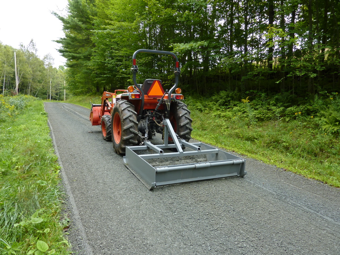

gg
