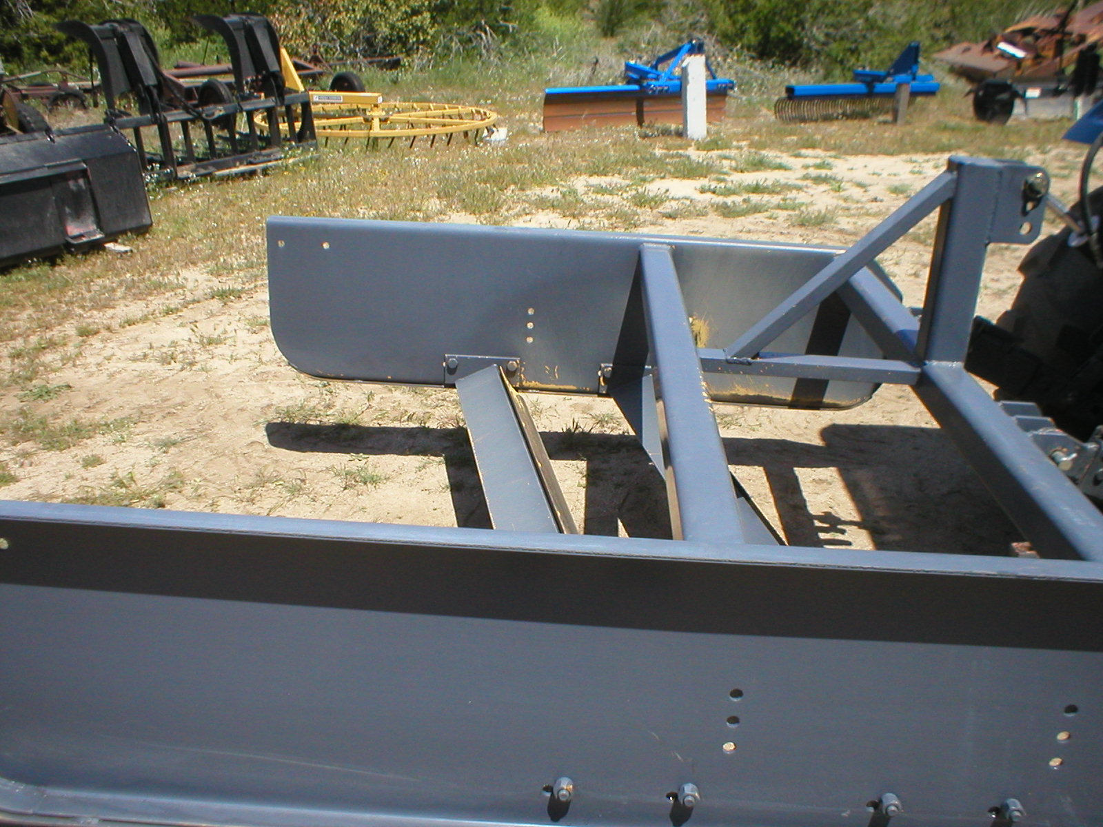

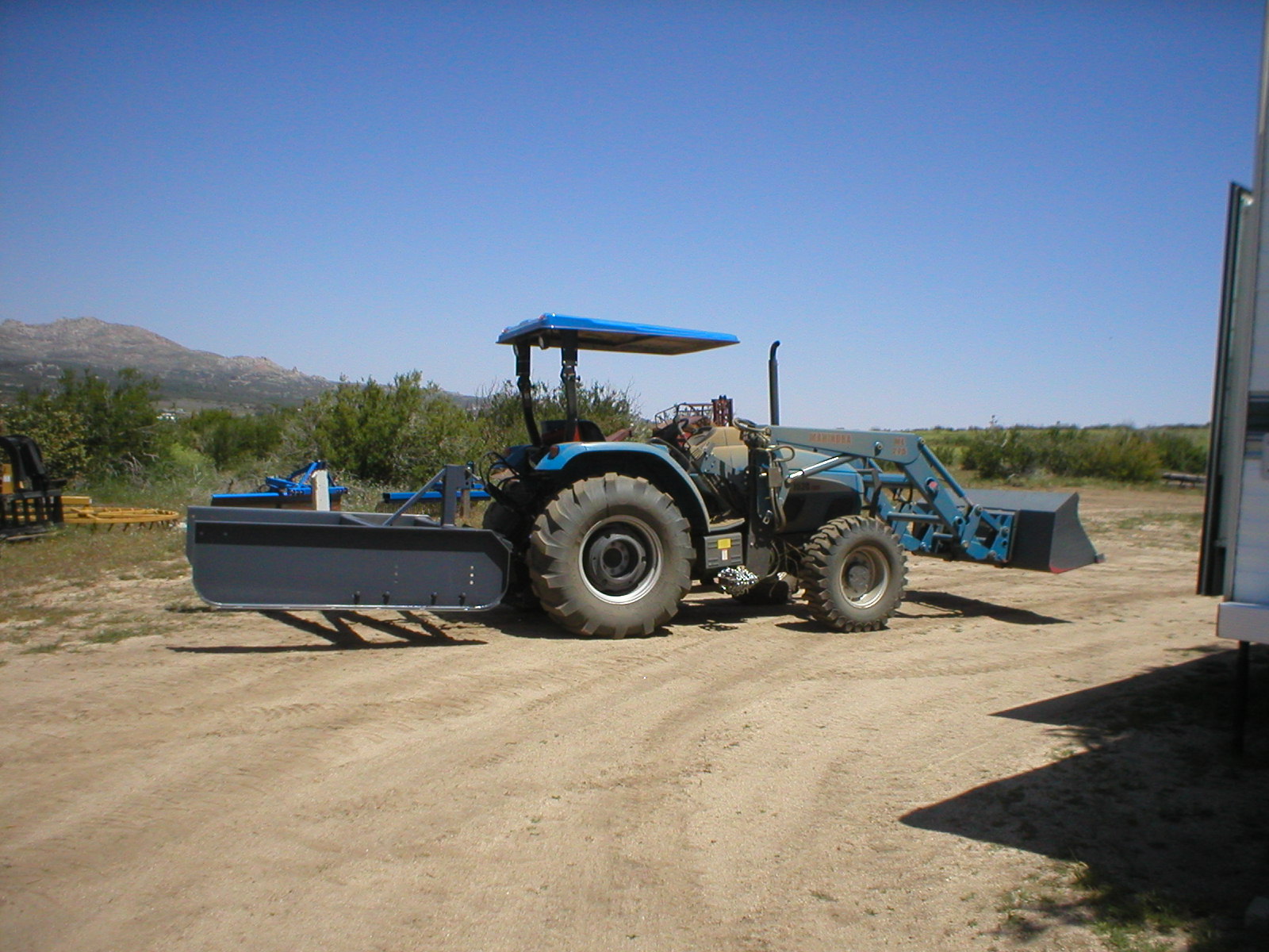

David, Three questions for your build
Why are there so many holes? Clearly you had other plans, would love to hear what you were devising.
Second, how deep is your blades set for? I am hearing 1/2" to 3/4" max...
finally do you wish you did the / design instead?
Oh, and a 4th, do you raise one side of the blade higher than the other?
I am working on a way to do all 4 ll, //, , / hopefully without over engineering the darn thing. I am dropping the idea of a third straight blade at the back as I have only seen one manufacturer do this, all the others use a 2 blade design.
I am going to assume the "extra holes" are the ones in the side plates, which were in the metal prior to me getting it (note the mention of scrap metal I had on hand to build this).
I am extremely happy with the // blade position, and even if I had to do it over again, would still go with the //.
Blades were positioned 3/4" below the runners. Never quite sure why that measurement was picked, probably copied from somebody else. Due to one aspect of my use, I might had gone a little further, like up to 1" if I had to do it over, but that might change things on the flat road use, so I doubt i would change it.
When doing the roadway, everything is kept level, but when I want to do the ditch, bringing dirt back up to the roadway that has washed into the ditch, I raise the side that the blades are further back on. That doesn't quite work the way I wanted it to, because the runner on the lower side rides on the bottom of the ditch and the blade doesn't touch because the other side is so high. (hard to explain). I am considering adding a blade in front of the runner to cut a small trench so that the runner will drop down, thus allowing the grader blade to touch and cut and bring dirt back to the roadway. It won't take much to cut a groove for the runner to sit in, but this hasn't been a priority, since the road I maintain isn't my own.
I considered adding a rear blade or rear wall to the grader, and even thought about a hydraulic one, so I could move dirt like a boxblade. First time I used it to spread dirtpiles, I realized I could move more dirt than my 70 hp tractor wanted, so that wasn't needed. Due to the weight of my grader (remember, all scrap metal I had on hand) the one thing I kind of wish I had added was a hydraulic set of wheels out back to make it a longer "land plane" and give my tractor some help when transporting it. Not required but the 7,000 pound tractor knows it's back there for sure.
The multi holes in the 3pt links connecting plates are just so I can get max height or max lowering should the need ever arise. Didn't think they would hurt since I have different tractors with different tire sizes. Easy to add, harder to fix if I made a single hole and missed the height mark.
