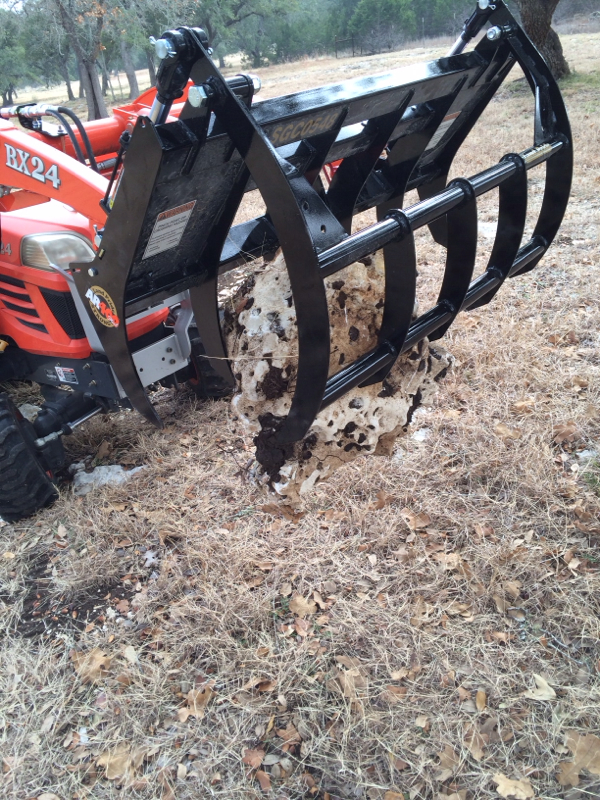

Well, I could not stay out of the cold and managed to wire up the valve this afternoon. I put a quart of hydraulic fluid in as I worked the grapple to fill the hose. CHDiinCT aka Chris - the buttons work great and the action on the grapple is not too fast. Of course nothing is too fast on a BX as there is not a lot of flow available. You can clearly feather the closing onto something. I took a short video which I'll send you if you want. Notwithstanding the cold I took the tractor out of the shop and picked up the first rock I could find. A guy has to play with a new toy.

We have a winner! Congrat's on getting it all together and working. I'm jealous. Would love a video if you can post it. I'm interested in how fast it actually moves.

Here's what I found on the female QC: 251-6FO
Did a google search on that and came up with:
Parker - SM-251-6FO
Per the link, it's 1/4" "body size" with 3 gal per minute flow.

Ron, sorry to hear you're laid up. I came down with a wicked cold today myself. Anyway, the LP grapple I think uses a different series than what's standard on the BX. I left it out of what I posted above, but the full model number on the Female QC states SM-251-6FO (o as in o-ring seal, not 0). So I think LP provides SM series couplers. I think, LOL.

I do not know how to post a video. HELP! I just have a short 21 sec of the jaws opening and closing so far. It's still cold in my area but tomorrow it's supposed to be about 65F. I'll try to get my spouse to show me "working". I'll put it on YouTube but need help there also.
   / Landpride grapple for SCUT? #120
OK I was able to upload to YouTube. It's under Land Pride SGC05. I'll add some working videos tomorrow.
