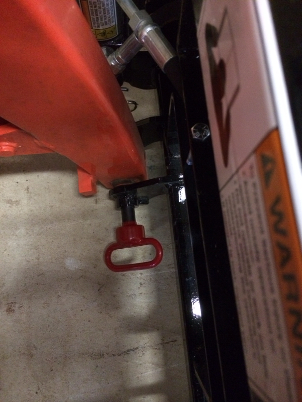

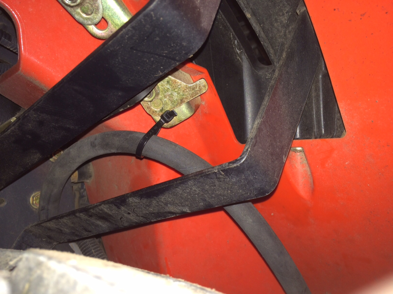

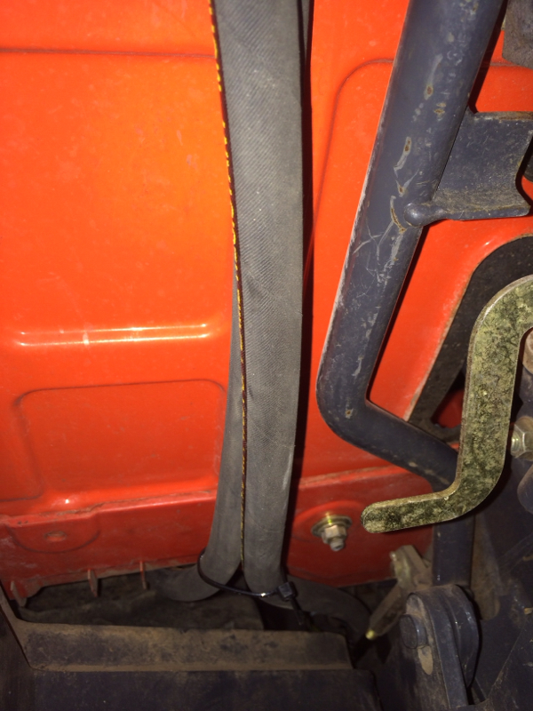

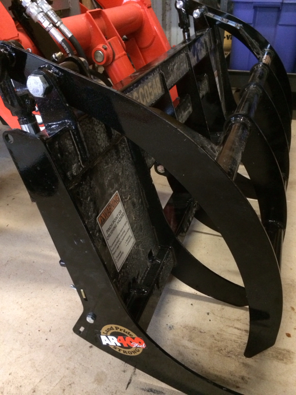

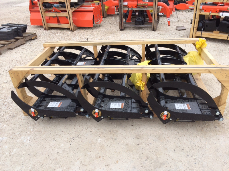

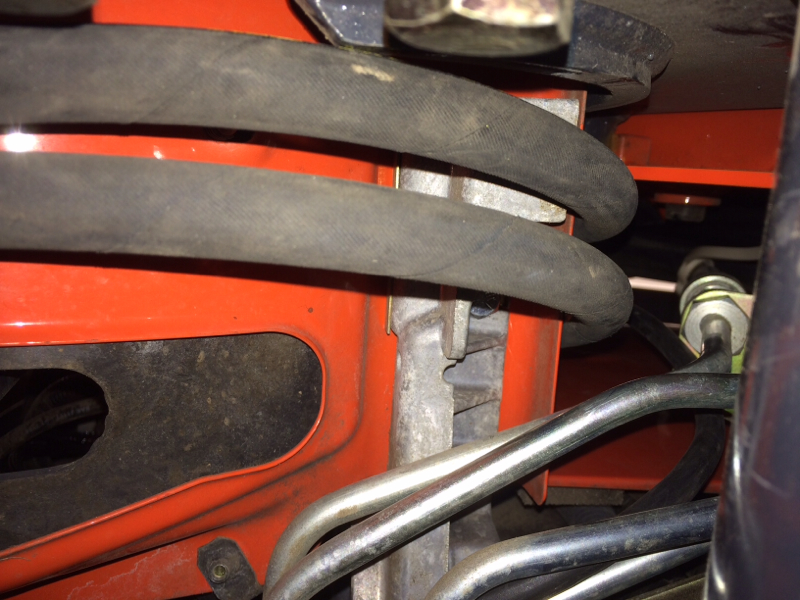

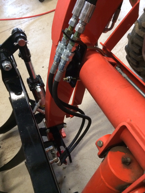

I have not found any paint flaking or rust spots. Here's a picture of the 3 my dealer got on their pallet and my grapple from several angles including the too long hitch.pins I used to attach it instead of the LP pins. I also attached a couple of pics of the hose routing under the floorboard and the tie up of the loop of the long hose under the rear fender. I think the ties provided are a little weak. I am going to look for some that have a metal inner core just for their durability.
Lowellw2, great pic's. Thanks for posting. Have you used yours yet for any real work? How do the joystick switches work? Momentary, or push once for on/off? On the rust/bad paint, guess I just got lucky again just like missing the male QC's (which are still not here - yeah, I know, I complained about that just a few hours ago). Years back, I received some bad hoses from Kubota related to the front mounted quick hitch for the plow. Messick's had Kubota drop ship replacements and I had the new ones in about 2 days. I would have thought LP would have sent the QC's priority shipping, but apparently not. Anyway, let us know what you think once you actually try it out.
Oh yeah, on the zip ties. I used some slightly larger ones I had on hand. I also think I used about twice the number included in the installation kit.

Aren't the connectors you need just 1/2 inch AG's? You can get them and the dust caps at Tractor supply if you have one nearby. I am sure there are also hydraulic supply houses that would have them too.
