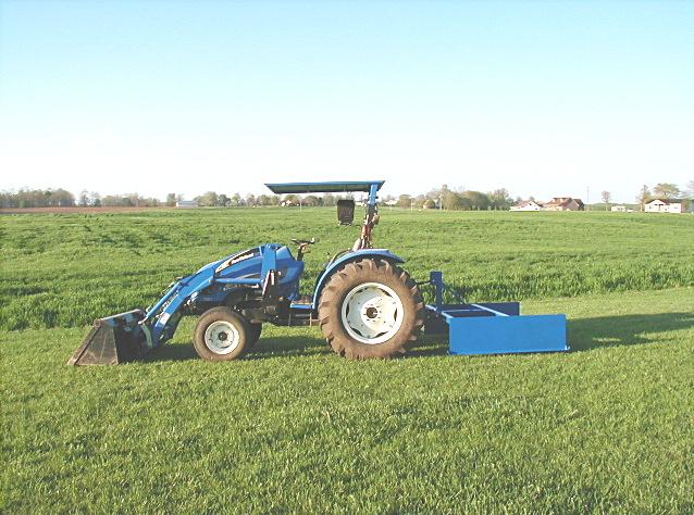

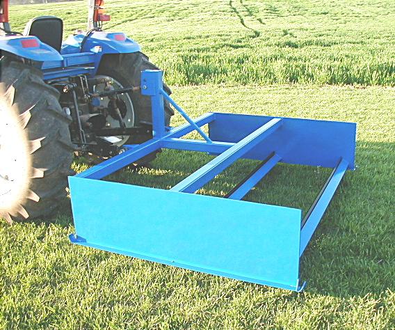

MtnViewRanch said:
Show me a single edge blade that removes wash board as quick and easy as a good twin blade road blade and I might change my mind, but I doubt it.
Here you go...lol ~:D~ Actually, mine has two blades, but the front blade does all of the cutting. The second blade does only the smoothing.
By the way, I built mine for $600. The OP might consider building one before buying one.

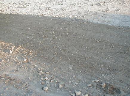

Before

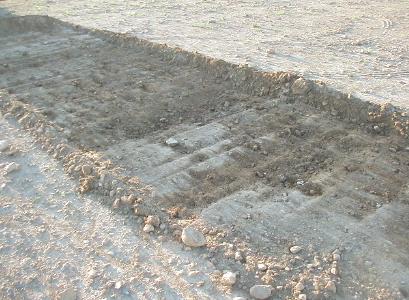

After
Another After
i thought that was the norm for the leading blade to be some fraction of an inch lower than the rear which was basicly flush. ( i thought the really good ones allowed you to change the setting of one (the front) or both)

By the way, those pictures are from a customers driveway that I did. My road grader cost me $600 to build. To date, that road grader has made me over $8000. :cool: Money well spent on material to build it. :)
Steve, some have both blades hanging down. I got my idea from the duragrader. Mine is heavy enough that it does not need both blades to cut. I can change the top link length (hydraulic cylinder via rear remote) and the front blade will only smooth. Also, mine will cut a pot hole with no problem. My grader weighs a little over 1200 lbs.

The two pictures are of hard dirt.
