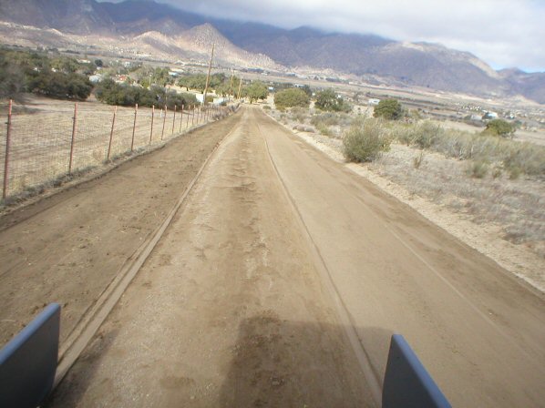

Just my 2 cents, but if you are looking for a primary road maintenance implement, then you are looking in the right direction. The Land Pride unit might be a little on the light weight side, but there are many manufacturers of similar implements. I usually recommend either one of these. Road Boss Grader - Road and Landscape Grading, Surfacing and Leveling, and Material Spreading and Reclamation or GradeMaster Grader Blades. I have over 2 miles of dirt roads that I maintain and have a box blade, a rear blade, a landscape rake and a Road Master road grader blade. While each and every implement excels in its own right, if I could only have one implement to maintain our roads with, it would be my road grader blade. If you intend to use the implement for many uses, then another implement might work out better for you.
Again, just my opinion and trying to give some info on what has worked good for me.
Good luck

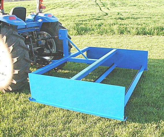

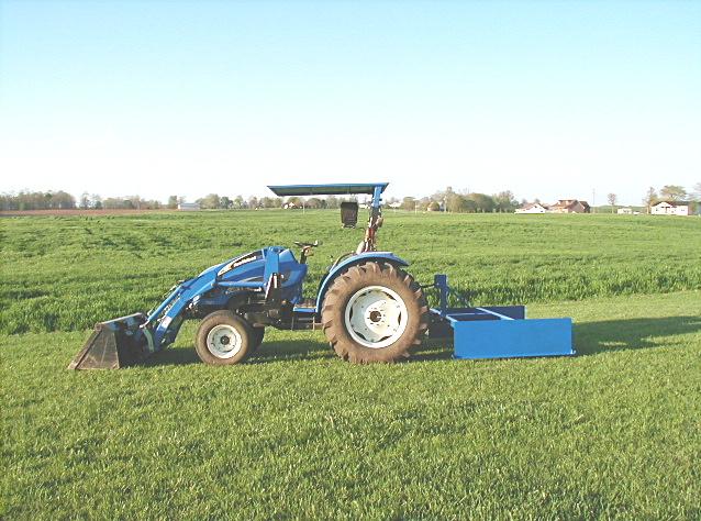

Here you go...lol ~:D~ Actually, mine has two blades, but the front blade does all of the cutting. The second blade does only the smoothing.
By the way, I built mine for $600. The OP might consider building one before buying one.

i thought that was the norm for the leading blade to be some fraction of an inch lower than the rear which was basicly flush. ( i thought the really good ones allowed you to change the setting of one (the front) or both)

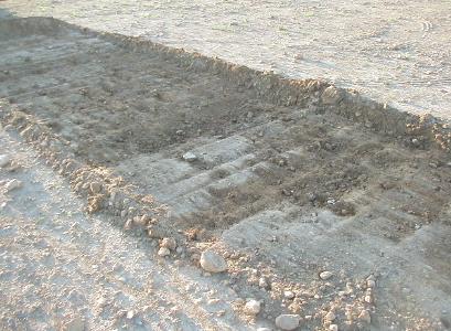

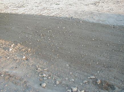

By the way, those pictures are from a customers driveway that I did. My road grader cost me $600 to build. To date, that road grader has made me over $8000. :cool: Money well spent on material to build it. :)

Steve, some have both blades hanging down. I got my idea from the duragrader. Mine is heavy enough that it does not need both blades to cut. I can change the top link length (hydraulic cylinder via rear remote) and the front blade will only smooth. Also, mine will cut a pot hole with no problem. My grader weighs a little over 1200 lbs.

The two pictures are of hard dirt.
