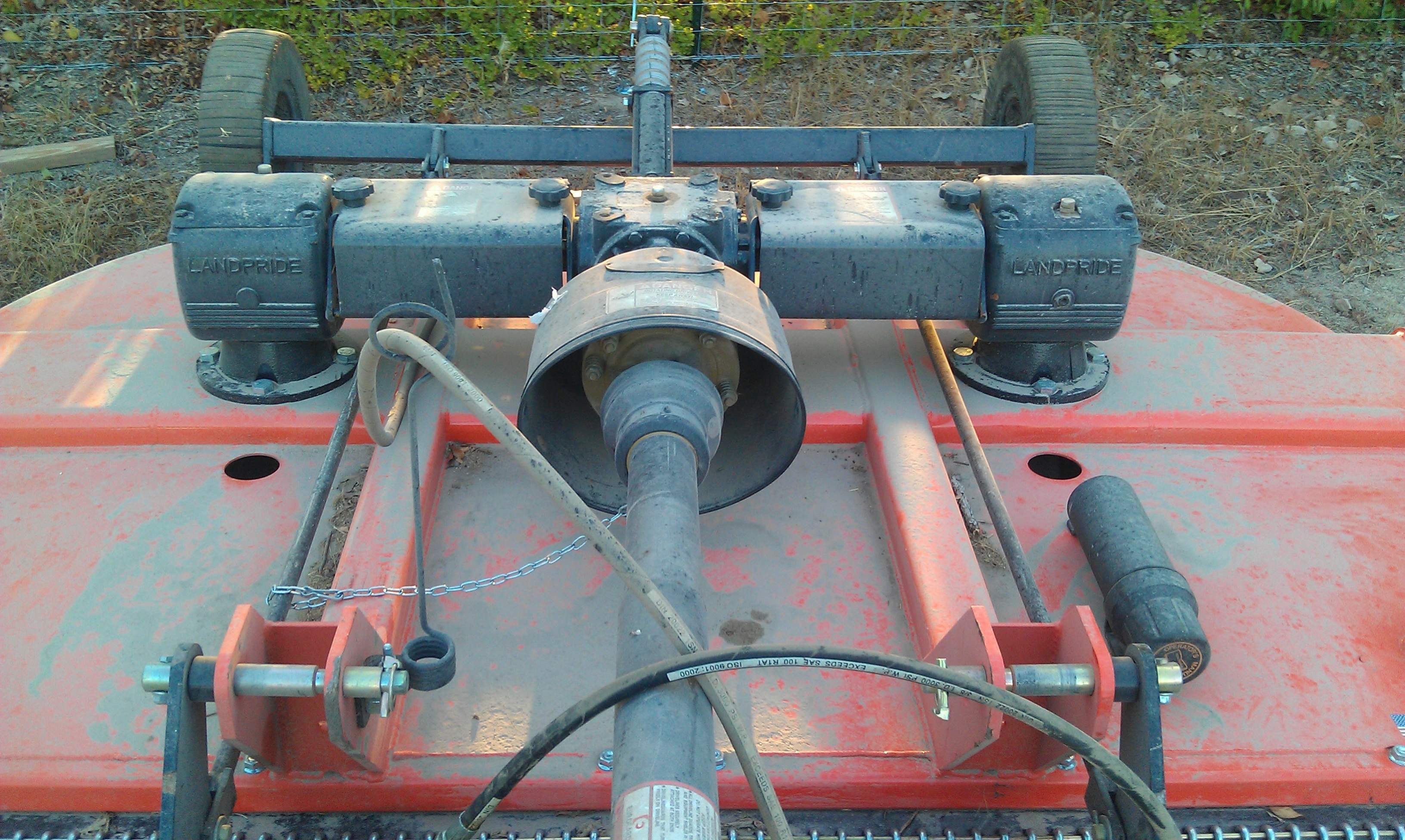

Have had really liked my 8ft Landpride(RCR3596) tough shredderLP3596.jpg No vineyards here just brush,small trees,goatweeds,etc.Hope it helps!!
