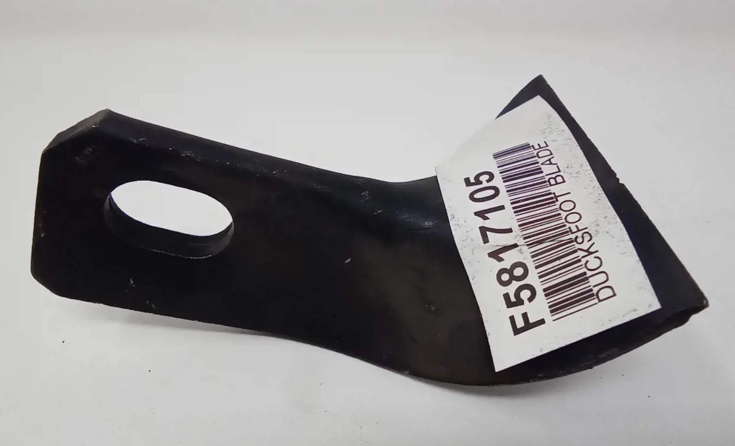

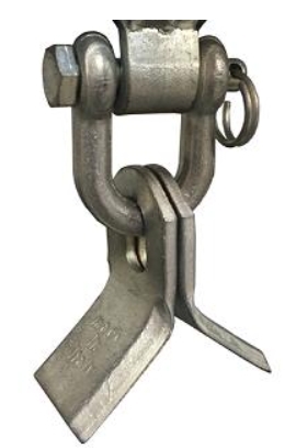

I bought a used Land Pride FM2160 flail mower and it's time for new blades. It uses a scooped "duckfoot" blade when I'd prefer something like a Mott/Maletti style rock blade (two Y knives hanging from a swinging D-ring) but the dealer says there's only that one option available. Has anybody tried to adapt another brand or type of blades to this mower with any success? Either equivalent aftermarket or a system like the Y knife picture attached. I'd prefer to adapt to the Y knife setup if possible but a cheaper duckfoot setup would also work, but the blades are stunningly expensive to be wearing quickly on rocks. I've attached two pics- the one with the "F" part number is the stock Land Pride blade and the other is the type of blade I'd prefer.

My experience with Landpride flail mowers is with the FM25xx series not FM21xx, so this may or may not apply. On the FM25xx mower line 3 blade types are offered: Duckfoot, Y blades and hammer blades. Y blades and hammer blades will mechanically interchange, however, Landpride does not recommend doing so because of potential rotor balance issues and excessive vibration. I swapped the factory installed Y blades on my FM2584 flail for hammer blades successfully with no balance problems. (YMMV) The Duckfoot blades use a different mounting pattern and are not interchangeable with either Y or hammer blades. A Duckfoot to Y blade swap according to Landpride requires a rotor replacement besides the blade change. Since this post is the usual un-helpful internet reply, I will add that if you are successful in finding Y blades that are mechanically interchangeable you may experience balance problems or have poor cut quality due to insufficient number or improper placement of blades. Sorry I could not pass on more helpful info.

I don’t have a Landpride flail rather I have a Ford 917.
And I have swapped between duck foot and Y type knives with no issues.
As long as each station/mounting point has a knife or pair of knives (based on knife type) I don’t see how there would be a balance issue.

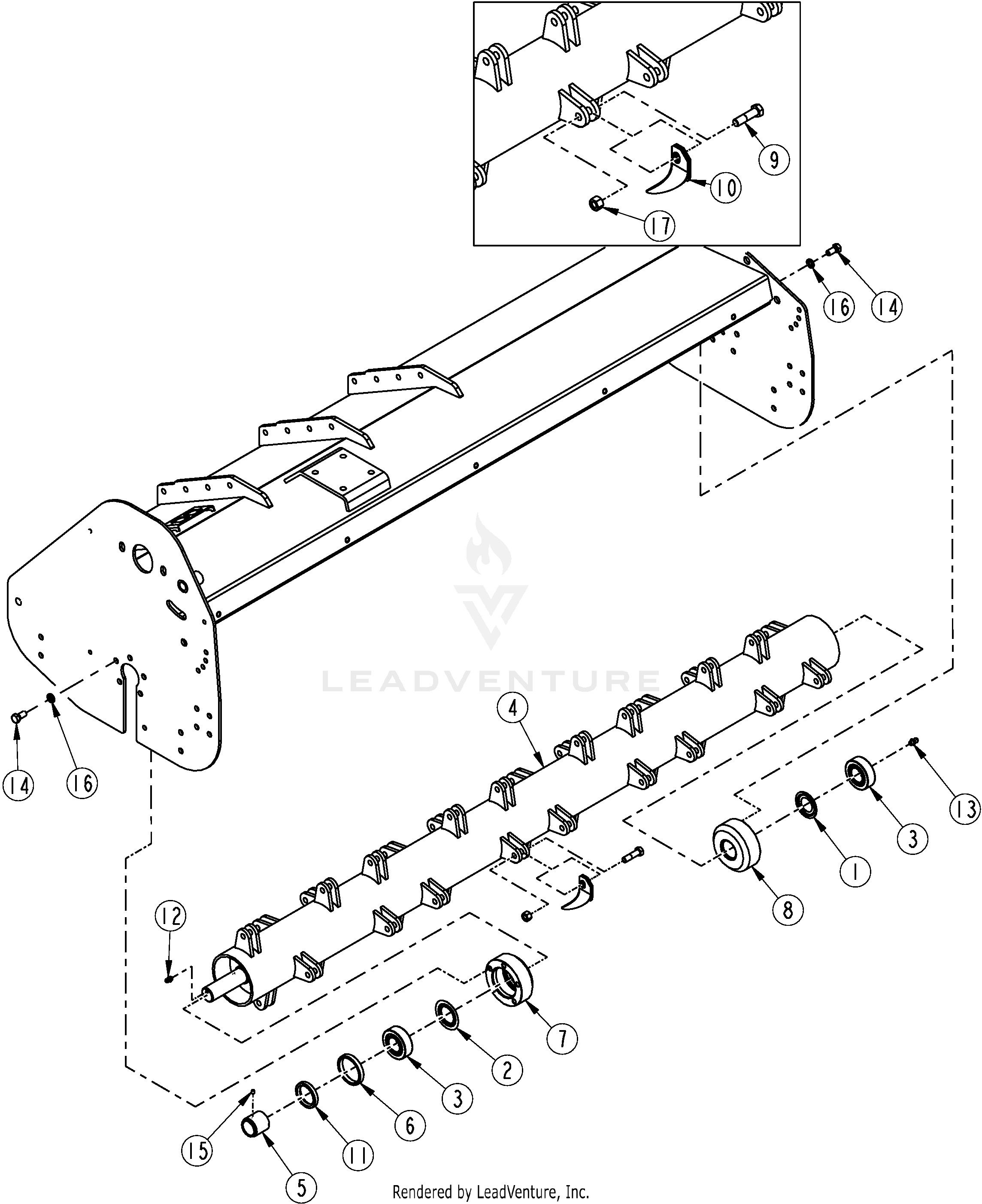

Looking at the Landpride parts manuals the FM2160 and FM2560 rotors are quite different.
FM2160 Rotor and duckfoot blade.
A Y blade replacement would have to be very short to fit. A Y blade with D ring might be too long to fit?

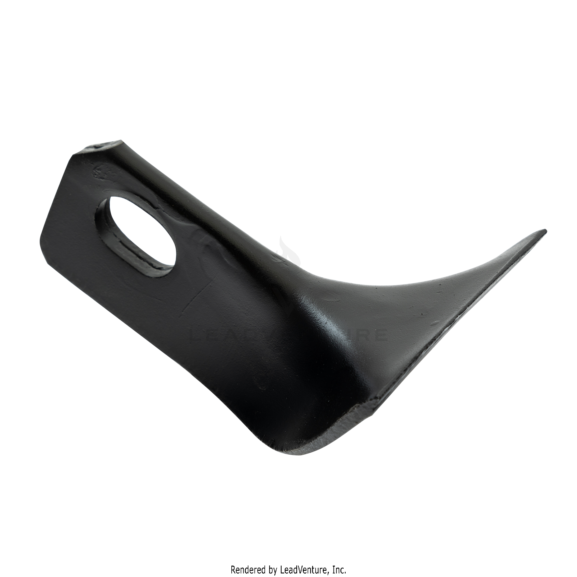

Thanks guys. I ended up finding an alternative duckfoot/scoop type blade that I'm going to try after they come in on Monday. Hopefully they'll work because the price of original equipment knives is insane ($37 Cdn each). It takes 30. I can redo a much larger flail mower for half the price with Y knives. We'll see if the P66945 knives will work. Hopefully the shaft is inherently balanced so changing knife weight still works smoothly. I still plan to try some Y knives when I have more time to play with it though.

Longterm update on knives for those with this Land Pride mower. The P66945 scoop/duck bill blades work fine and are way cheaper from my local Deere dealer than what the factory blades list for. It's a pretty crazy difference at about five bucks a blade from my Deere dealer in packs of 10 and Land Pride lists them at $37 a piece. I still haven't tried to adapt it to the Y knives but they probably won't work very well because they aren't listed as an option from Land Pride.
