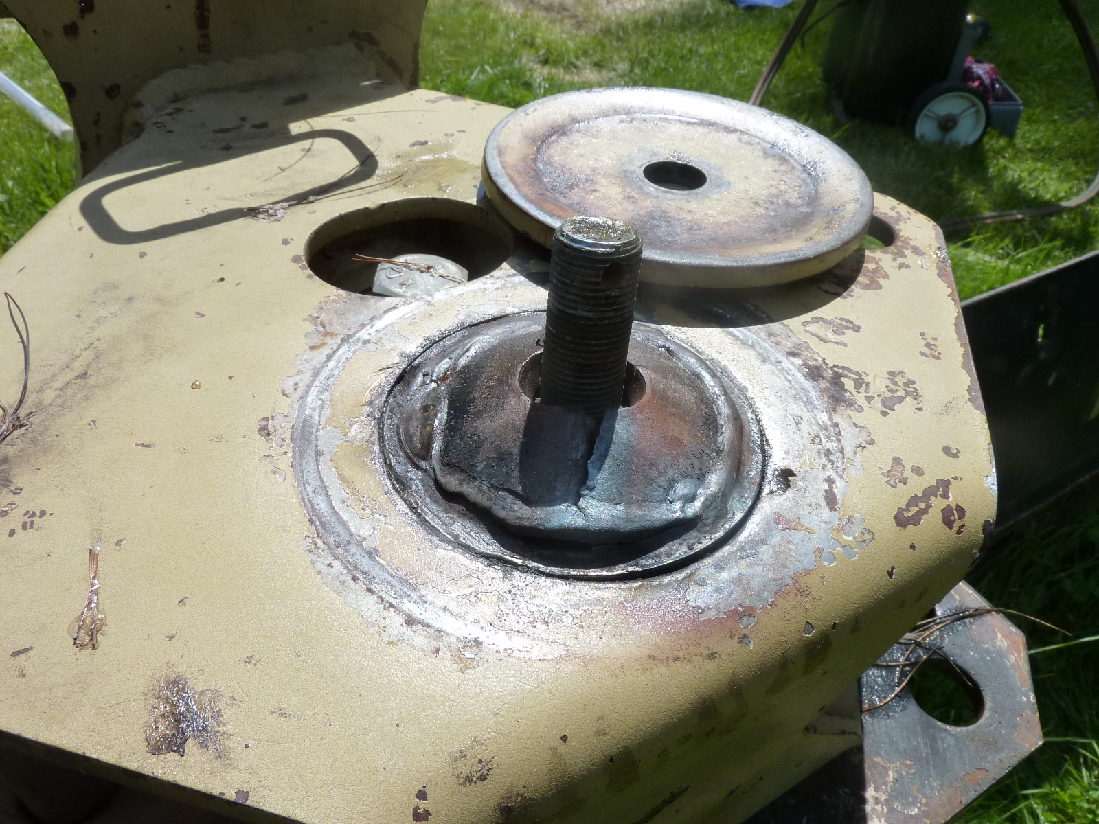

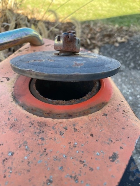

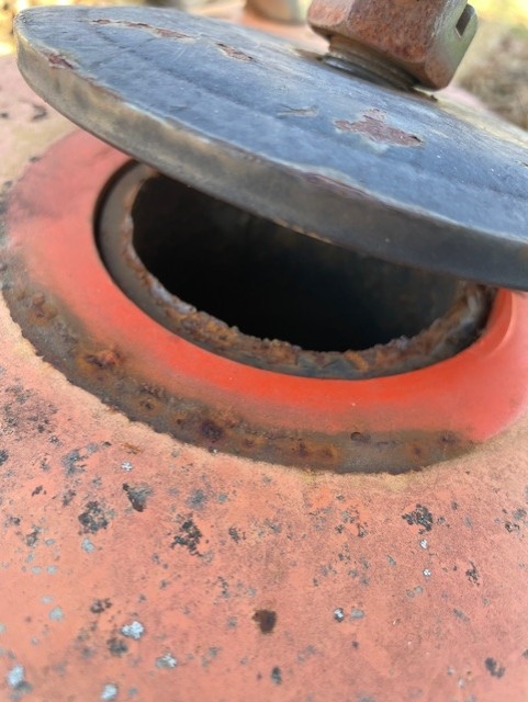

By blade is shot the weld at the pivot point where you switch from right to left has a broken weld. This blade maybe has 2-3 hours of use. It is setting on a concrete pad and the weld has let loose. Too bad it is about 10years old maybe 15 years old. Anyone else have this happen or just me.

By blade is shot the weld at the pivot point where you switch from right to left has a broken weld. This blade maybe has 2-3 hours of use. It is setting on a concrete pad and the weld has let loose. Too bad it is about 10years old maybe 15 years old. Anyone else have this happen or just me.View attachment 4640238View attachment 4640239
I had the same thing happen on my 5’ blade recently. It appeared to be tack welded in 3 spots. The cylinder was full of ice. That could have popped the top or I broke it when last used and put it away broken (not likely). My friend laid a bead all the way around the top. Everything else will break before that weld will, lol.

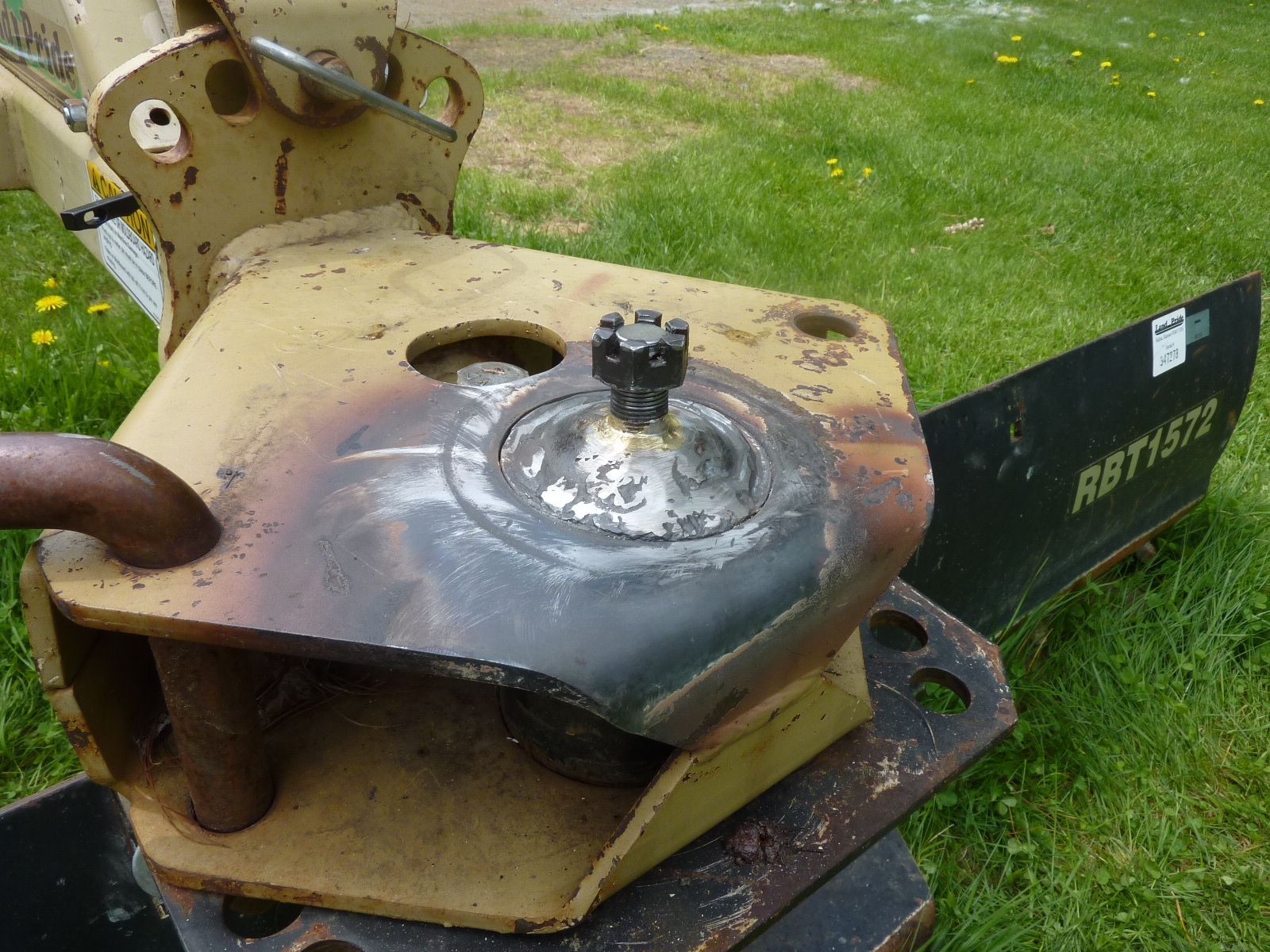

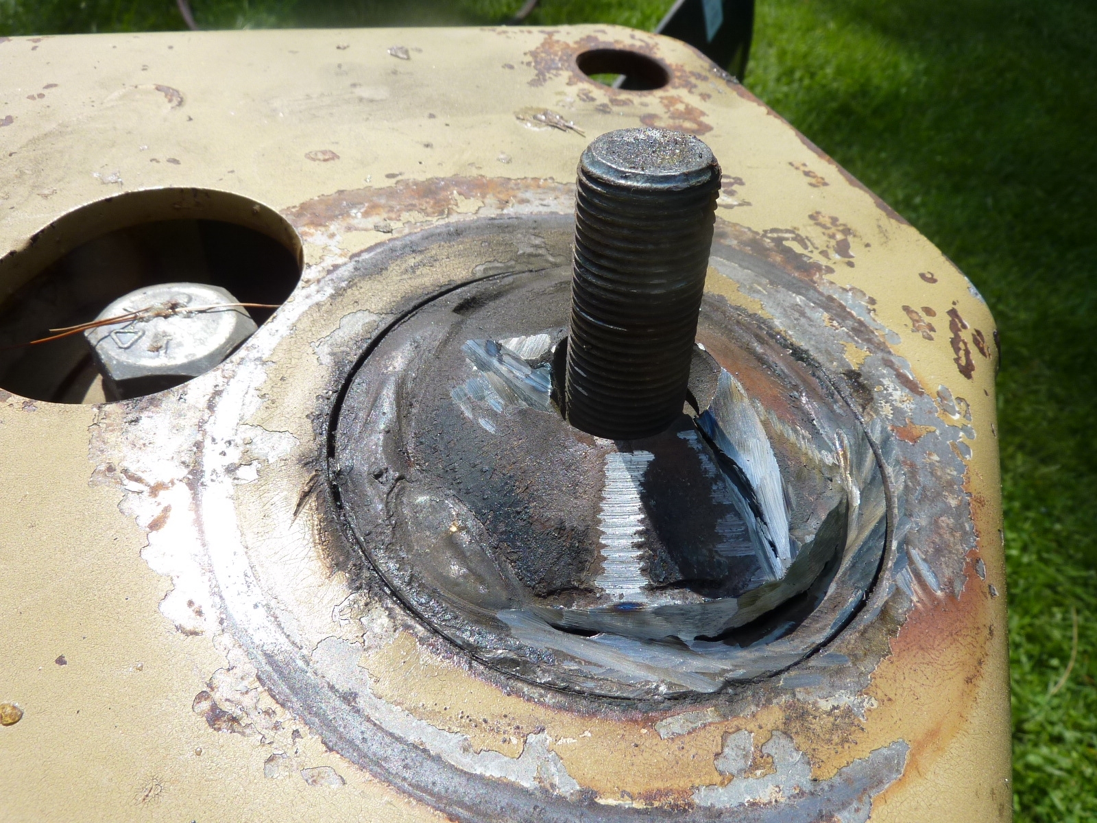

I have a RB1572 bought in 2000. It was my only implement to maintain a mile of rough road for over 10 years. After many hours it broke in 2015. Not a broken weld though - worse.
But I was able to repair it and still use it today.
