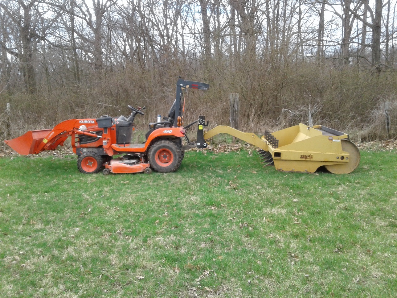

Hard to dial in the correct top link setting. The front V or the rear V is doing most of the work. I think a hydraulic top link would let me adjust it "on the fly". A box blade wider than the tractor, gravel is lost to drainage ditches. I also have Hoelscher rolling box blade.
Hoelscher Commercial Products - RB Scraper
Changing lift position determines if it's grading, transporting or spreading. It can't be lifted off the ground and next to impossible to back up on a hill.
Fun to P.O. neighbors during "roller season" and they are stuck with turf tires on lawn tractor.

Five years ago I bought a FitRite hydraulic top link. Able to make adjustments "on the go". A lot easier when changing and attaching alternate implements.
i7win7 - THAT is a very fine implement. I do believe a hydraulic top link would help a lot. Where did you ever come by that RB Scraper?
