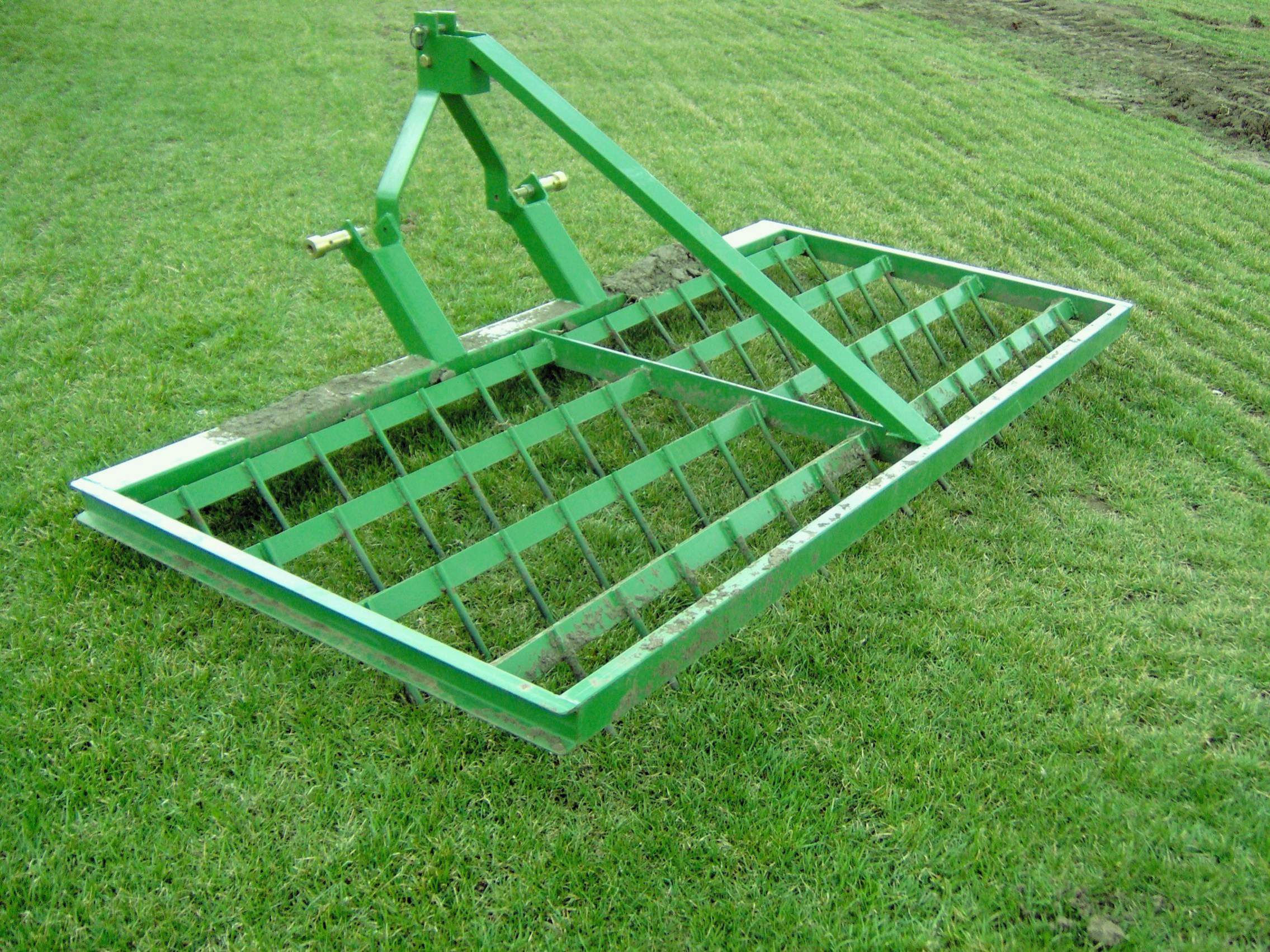

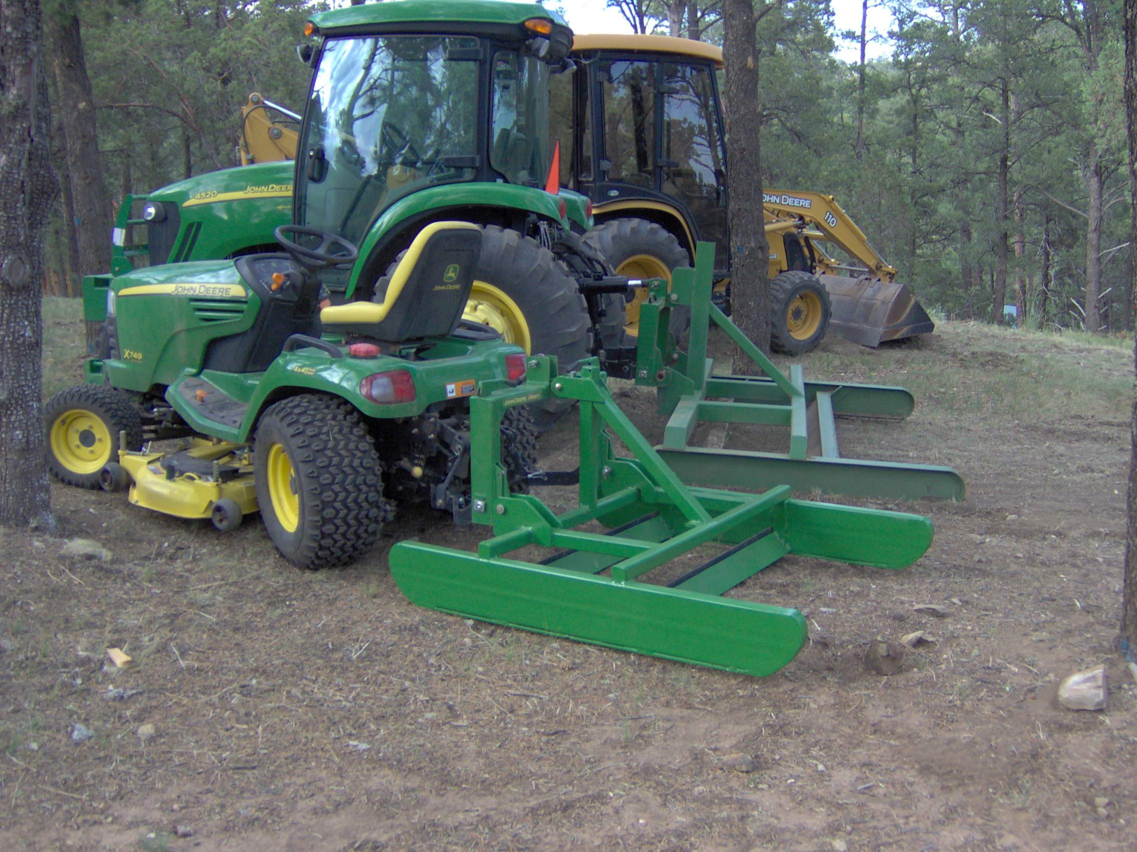

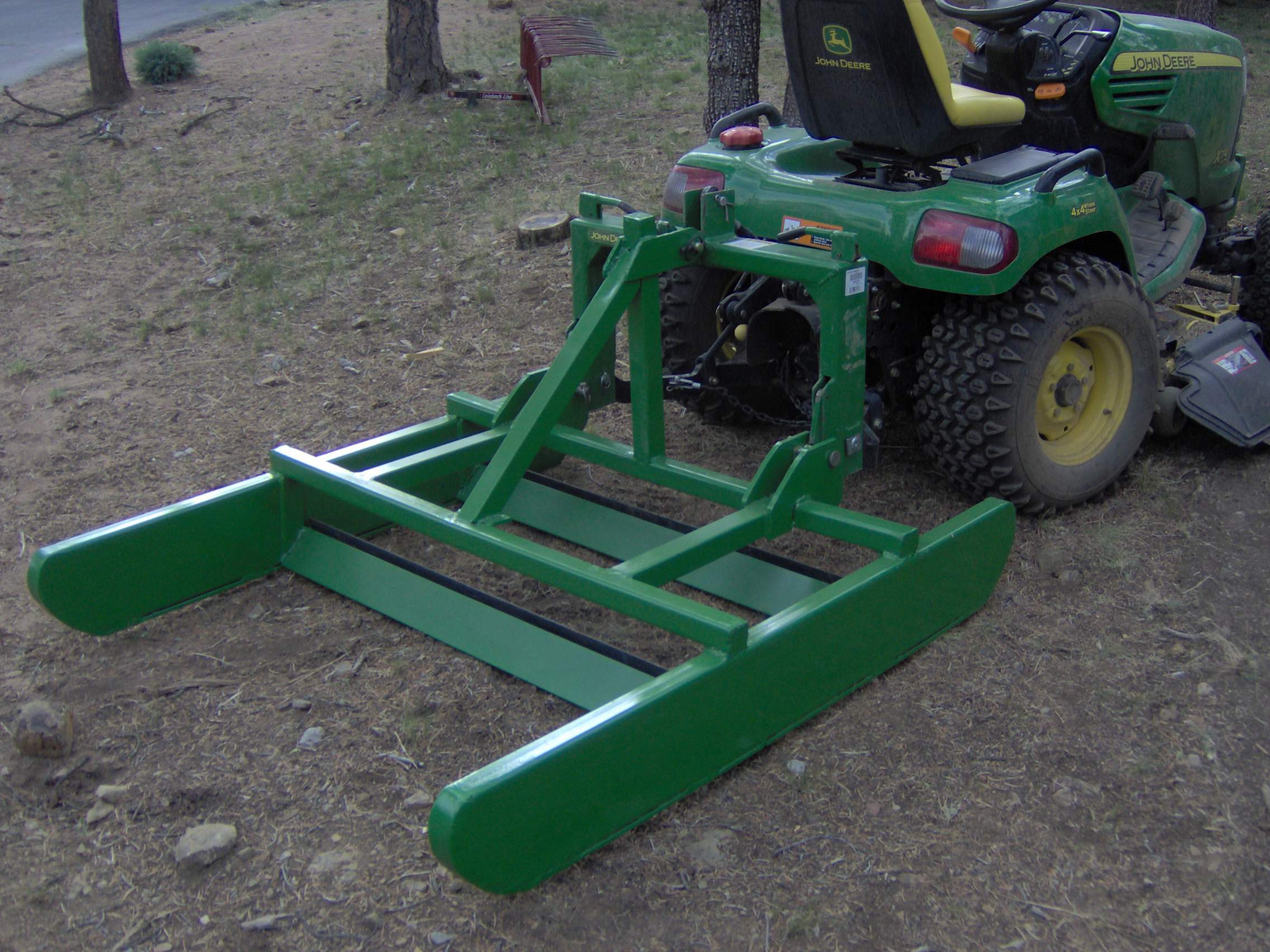

I would disk or till the land first then use a land plane grader blade to smooth it out. You can run a land plane across it first to see if it will smooth enough to suit you but in order to plant the lawn it is better to have the dirt worked up any way. I use the land planes and a tiller for most of the lawns I develop for my customers. I built my land planes for this purpose and smoothed out my lawn with it. I also built the spike tooth harrow for smoothing and covering seed.
