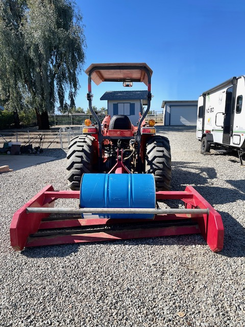

The landplane works best in areas without rocks. Mine needed a weight option for some jobs so I made this barrel rack. The full barrel doubles the weight to almost 1200 pounds.
If you had teeth on front edge likened to those on a box blade, it would loosen those rocks. Maybe no need to fool with water in and out your drum.

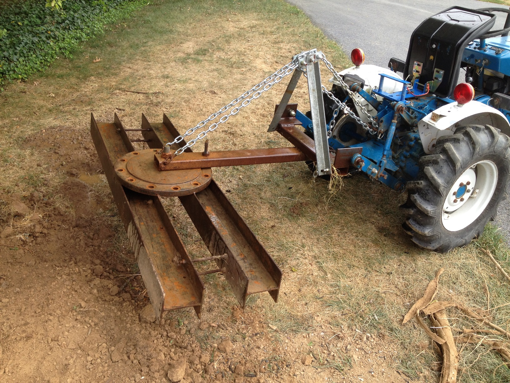

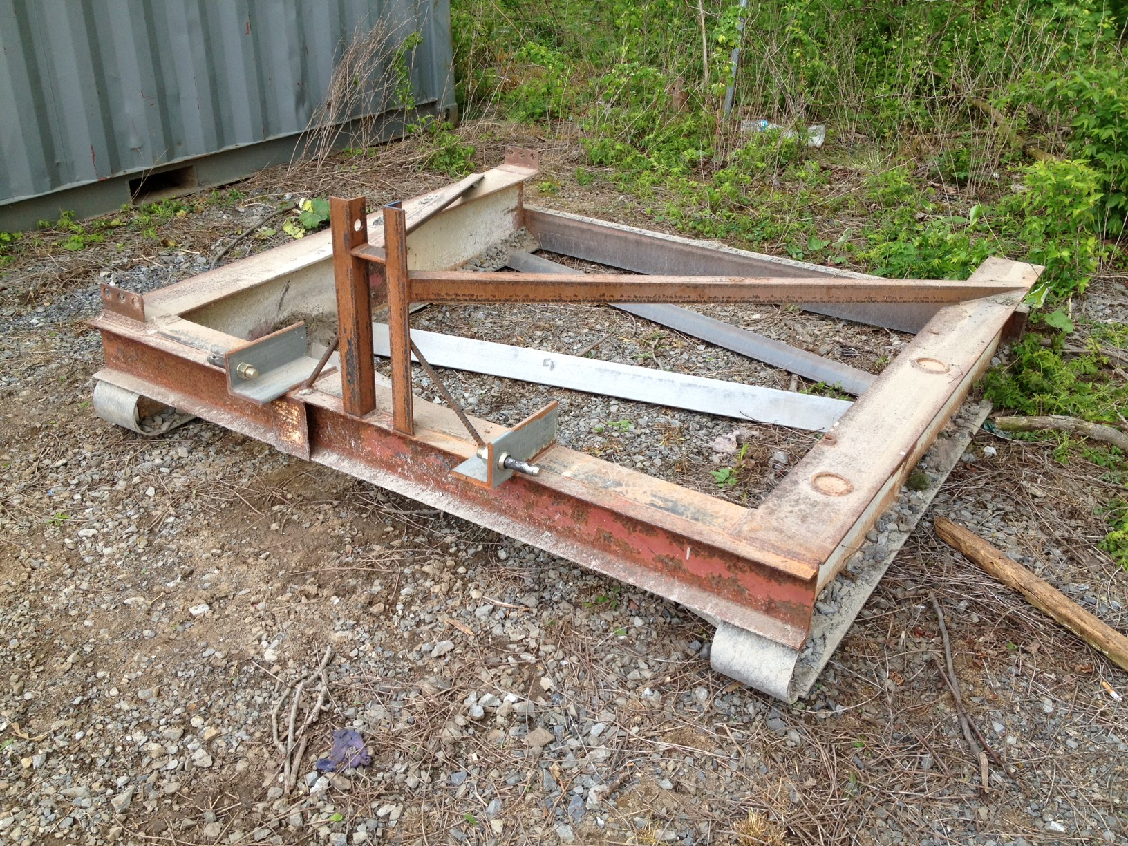

Here are a few pics of things I've done. All were used where they had a chance to pop some rocks up. None reliably brought any rocks up larger than a softball.
The first drag I built was for the B7500, and the original setup was simply a pair of chains to drag it. The adjustment for how aggressive it became was by selecting form the choices of holes for the chain attachment in the leading flange of the first I-beam. Angular adjustment was shortening one or the other chain. When it became apparent it would be nice to pick it up for transport, it was a simple matter to us the lift boom.
The latest version with the original I-beams uses a big old blind flange. The flange adds weight and makes it easy to adjust the angle by dropping a pin through different bolt holes. Aggressiveness is via top link adjustment.
The big one was sketched up by me and built by some guys in our shop. Three sides are I-beams we had laying around and the front has sections of pipe added to keep the ends of the I-beams from digging in.

I take it the last one works better?
/ Land Leveler #19
Correct, although it's a bit bulky. The weight helps when knocking the high spots off and the half-pipe noses on the I-beams help keep them from digging in.
I built the other one when we had a gravel drive and it did fine. Since making the pipe flange modification, I've hardly used it. The last time was several years ago to smooth out fill when I poured a sidewalk.
