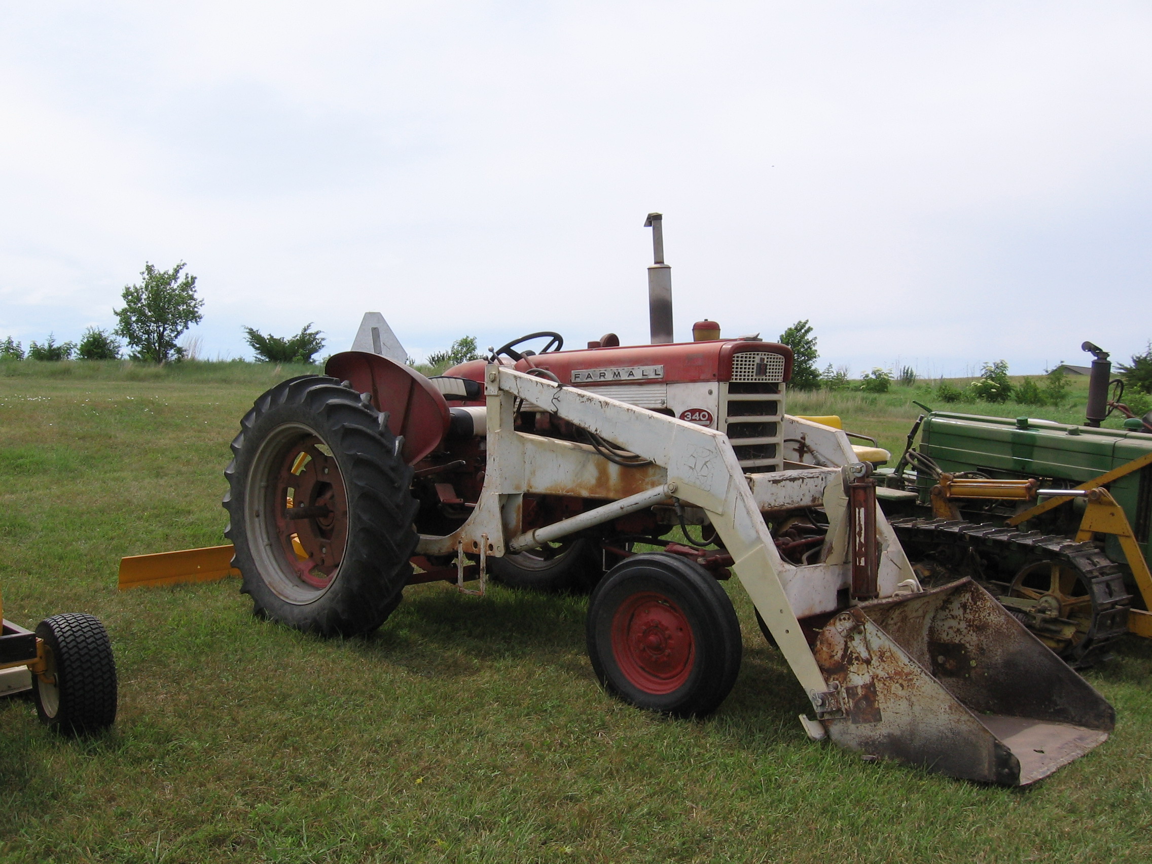

The Farmall 340 is not painted up, but the engine has been overhauled. While not rare, it is not common. I think they only made 7,000 or so of the Farmall 340 and International (Utility) 340s. It is my "modern" workhorse tractor.
   / Land Leveler/Grader Blade/Land Plane #8
Nice bulldozer, too...
#9
Yep, it is 1958 John Deere 420. It came down through the family. It has been completely overhauled, including new pins in the tracks. Kind of a money pit but it will do some work. Not a D7 or even a skidloader, but with patience and knowing its limits it will move dirt....and lots of snow. Someday I need to paint it and decal it.
