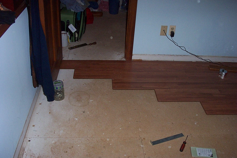

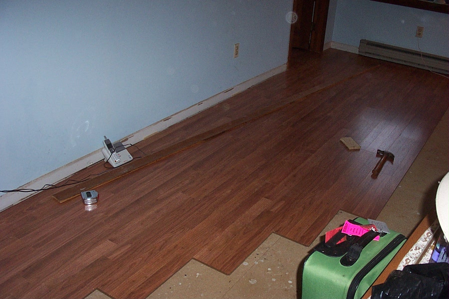

Good Afternoon Guys,
OK just to wrap this thing up a few more pics but I have to tell you, we lost power thursday afternoon about 3 pm ! :( We didnt get it back until a few minutes ago ! :) So the first few pics are where the project stood yesterday afternoon !

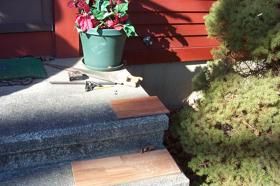

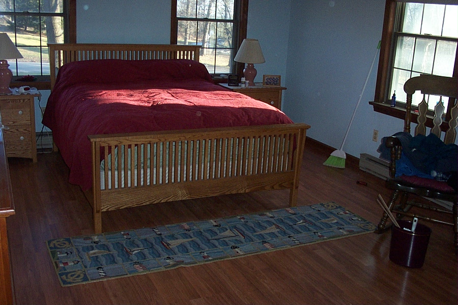

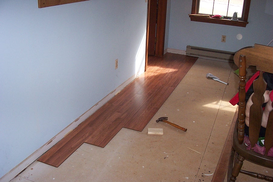

Ok,
So no power friday mornin :(, Im not wastin a whole day waitin for the power to come on ! :rolleyes: How did they build things before electricity ? :rolleyes: You betcha, hand tools ! :)
Anyways the closet and bedroom are finished, and just the hall is left to do ! :)
Thanks for all the help and suggestions !
BTW you would think that someone who could build that bed, and all the other furniture in the house, would be able to figure out how to put down laminate flooring, wouldnt you ? :confused:

Good Mornin Guys,
Ray and George thanks for all the suggestions and help !
Good Mornin 2manyrocks,
It went down fairly easy ! My problem was my back and legs took kind of a beating, closing on 58 and Im hurting today:(! Other than that fairly straightfoward after the guys on here got me pointed in the right direction. I used Pergo and went with Glendale Oak with the backing allready on the laminate, which is the way to go in my opinion. It was $2.97 per sq ft.
Ray and George,
One more question ! ;) I still have my upstairs hallway to to do yet. Going into the bedroom, the laminate male side is showing. My thinking is that I should use this spot to put a saddle in and reverse direction so the female end is going out towards the hall. Do you agree with that, and the other question, is since the hall is so narrow at the top of the landing, do you still stagger the boards for that small section ?
Thanks again ! :)
