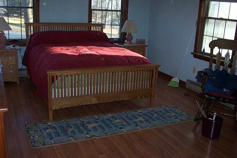

Good Afternoon Guys,
OK just to wrap this thing up a few more pics but I have to tell you, we lost power thursday afternoon about 3 pm ! :( We didnt get it back until a few minutes ago ! :) So the first few pics are where the project stood yesterday afternoon !

Ok,
So no power friday mornin :(, Im not wastin a whole day waitin for the power to come on ! :rolleyes: How did they build things before electricity ? :rolleyes: You betcha, hand tools ! :)
Anyways the closet and bedroom are finished, and just the hall is left to do ! :)
Thanks for all the help and suggestions !
BTW you would think that someone who could build that bed, and all the other furniture in the house, would be able to figure out how to put down laminate flooring, wouldnt you ? :confused:

It went down fairly easy ! My problem was my back and legs took kind of a beating, closing on 58 and Im hurting today:(! Other than that fairly straightfoward after the guys on here got me pointed in the right direction. I used Pergo and went with Glendale Oak with the backing allready on the laminate, which is the way to go in my opinion. It was $2.97 per sq ft.
Ray and George,

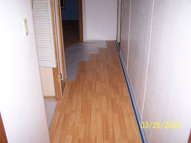

One more question ! ;) I still have my upstairs hallway to to do yet. Going into the bedroom, the laminate male side is showing. My thinking is that I should use this spot to put a saddle in and reverse direction so the female end is going out towards the hall. Do you agree with that, and the other question, is since the hall is so narrow at the top of the landing, do you still stagger the boards for that small section ?
Thanks again ! :)

You should be able to reverse the direction of the tongues if you want, though I am not sure if it will matter.
Yes a hallway is generally where you will put a saddle and break off from the room.
If the hall is narrow enough to do without any butt ends, and you want to eliminate the stagger, you of course can.
You can also switch to a more simple alternating pattern like:
1st row, seam on left
2nd row, no seam
3rd row, seam on right
4th row, no seam
repeat
Keeping them, uniform, and even, will be more important here as the walls will indicate any deviations. Don't assume the walls are straight and square. Use a laser, or chalk line down the middle, and measure off of that to the sides, for your seams.
