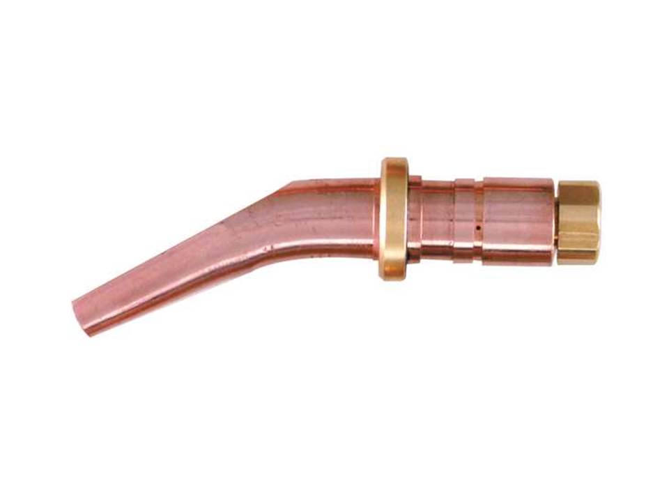

How could you possibly take pin on brackets off of a bucket..:confused3: Mine are in dozens of pieces of scrap metal..and metal dust...I can't imagine someone able to get them off in a usable condtion.. it boggles my mind.
Using an oxy-acetylene cutting torch fit with a riser/rivet cutting tip:
Been trying to find one of those tips to fit my Cutmaster torch for exactly this purpose for more than a little while now.
