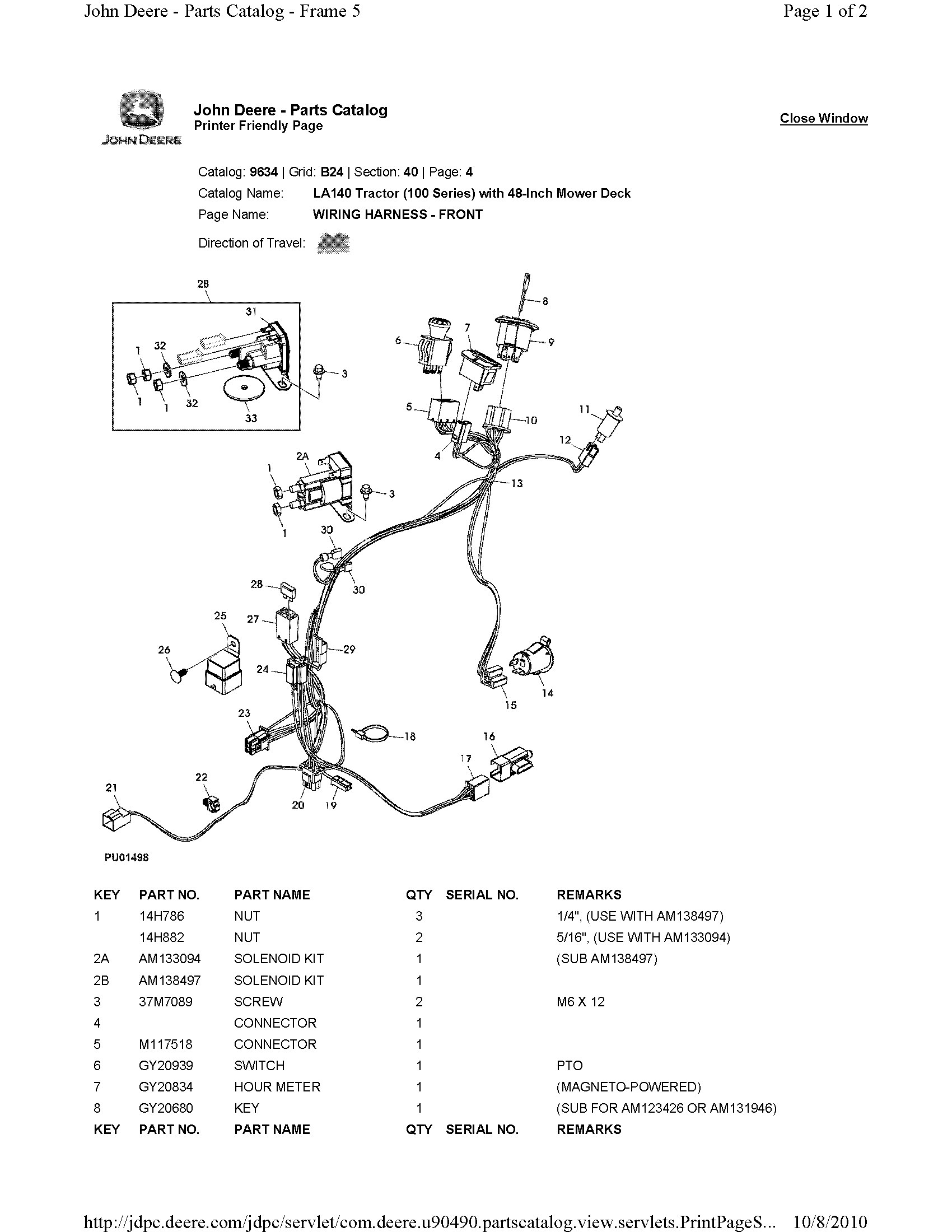

Hey Bill, this is not a schematic, but it may help. I've downloaded the wiring harness and parts diagrams for your LA140. They are attached below. There is one relay (Item 25 first illus - not sure of its function) that is a simple SPDT that is no more complex than a switch. My guess is that it is a high current relay controlled by a low current switch. . . not sure.

Wow! Thanks for the diagrams. They help alot. Number 25 is exactly what I was referring to and I can not figure out what that does either. I'm going to check a few other things today while I wait for the RIO switch to arrive. This shouldn't be so complicated, but I have yet to figure out what is wrong. Meanwhile, I'm mowing my back yard with my Mahindra and my front with a push mower. That needs to stop!

The good news is, I fixed the problem. It was the connector on the PTO Clutch. One of the black wires had broken off. I had looked at it before, but had never touched it. This time I touched it felt that the wire wasn't connected.
