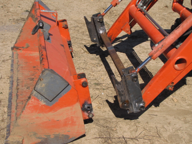

Nice Job! What is the final weight of your Q/A?
Well that's a good question! I have not weighed it but am sure it is less than 25#. I we take it off to paint and weigh it then, but not sure when that would be. I think the round bar probably weighs as much as the hooks together!
   / LA 302 bucket quick hitch
#23
I took it off to paint it today and weighed it up and it comes in at about 19 lbs. Even less than I thought!!! :thumbsup:
I couldn't wait for the warm weather so here it is with a coat of paint on it.
I might get a second coat on it Monday.

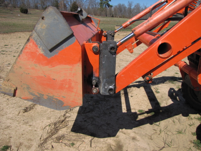

Leejohn, I don't under the extra set of holes on the bucket. Do You use the original lower holes to line up the pins for the middle holes to pin it on?

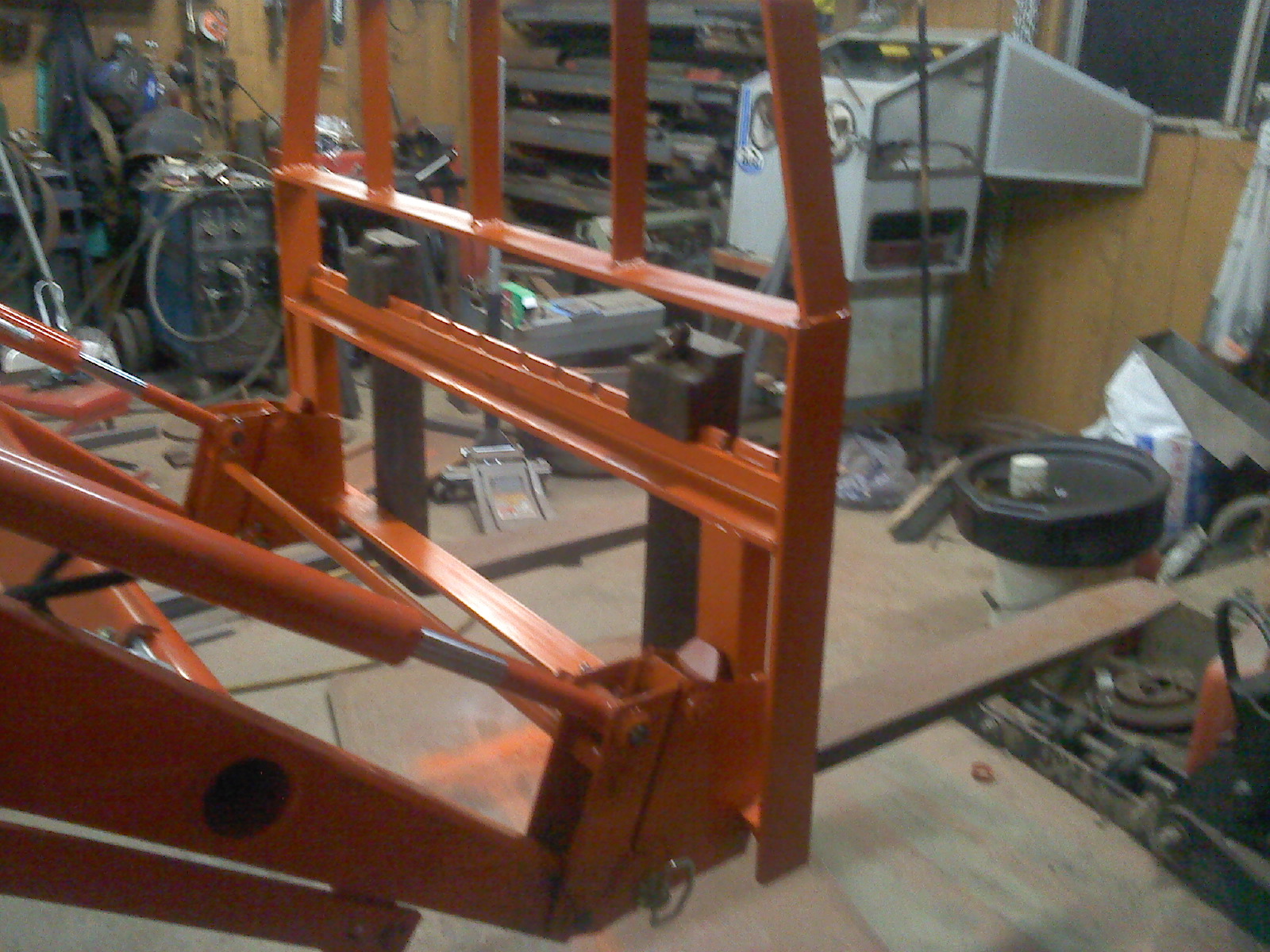

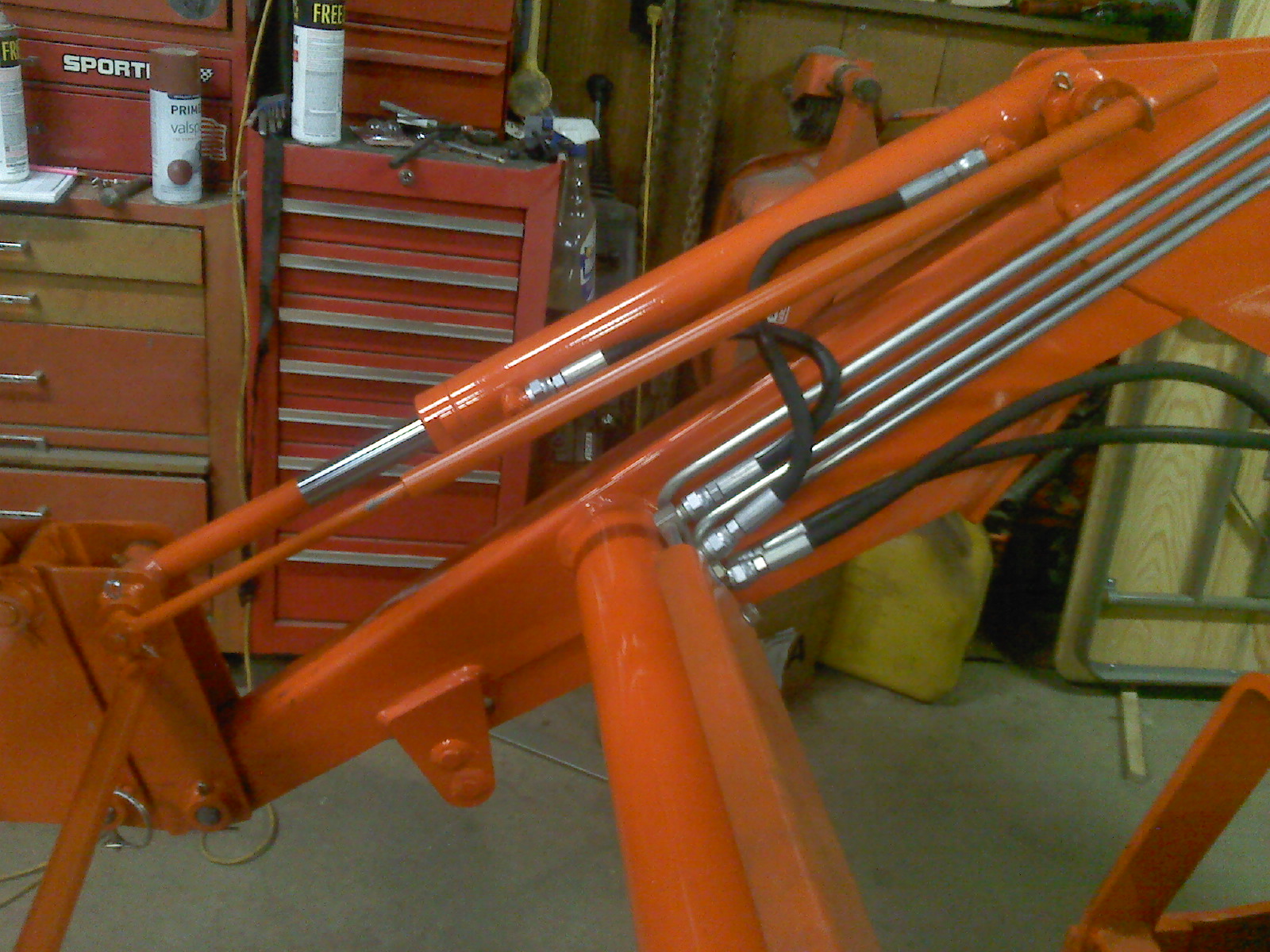

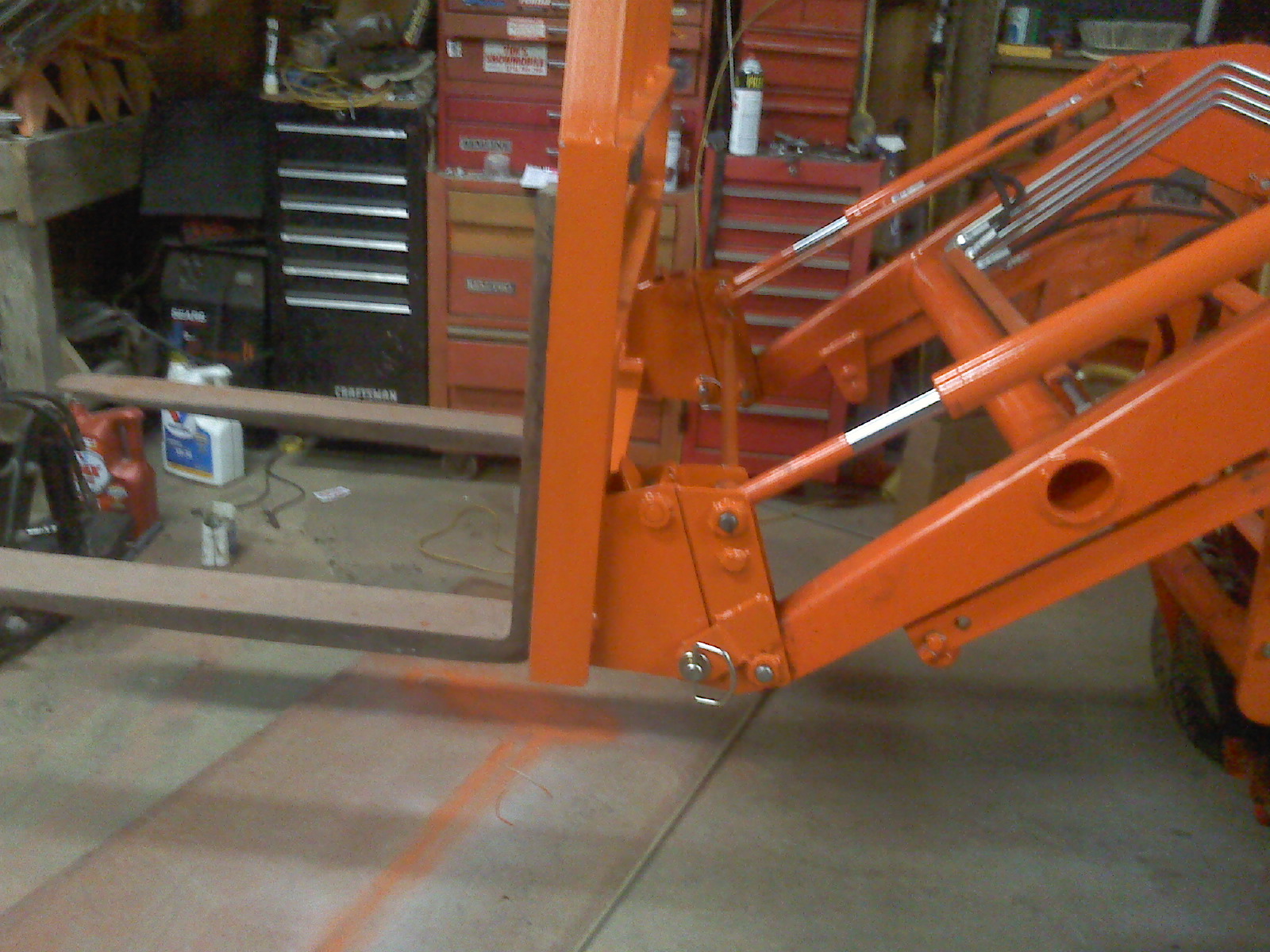

Here are some pics I took tonight after I re installed the QH, level indicator and fork frame after I painted them. :thumbsup:
I also installed the 36" forks I traded my 42" forks for.

   / LA 302 bucket quick hitch #26
Yes the pin in the bucket is what I use to lock it all together. The bottom pin is for pushing and it helps also on it moving up and down. I'm using 3/4" pins in the bucket for when I back drag, hoping they are strong enough (seem to be right now).

You did a great job!!!:thumbsup:... Having a "Quick Attach" on a FEL is great!!.. I think all tractors should come that way!.. IMHO!
Now you can switch from your bucket to your forks QUICK!!:D
