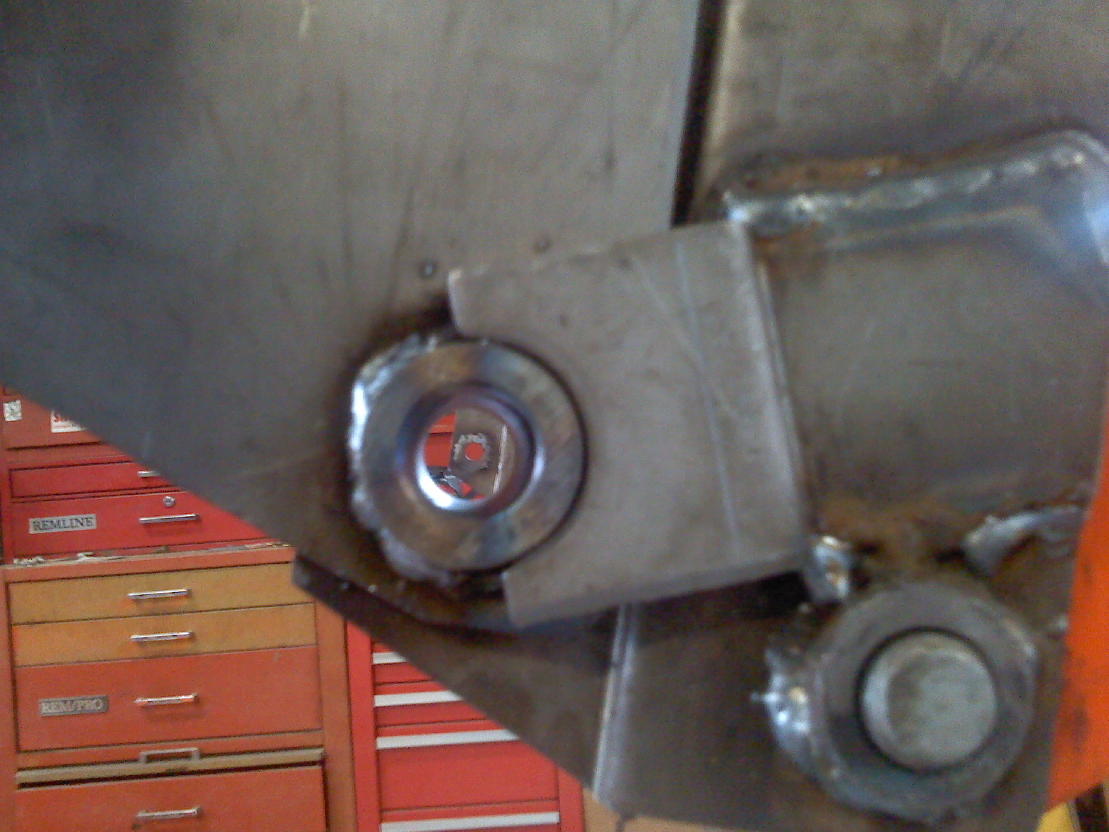

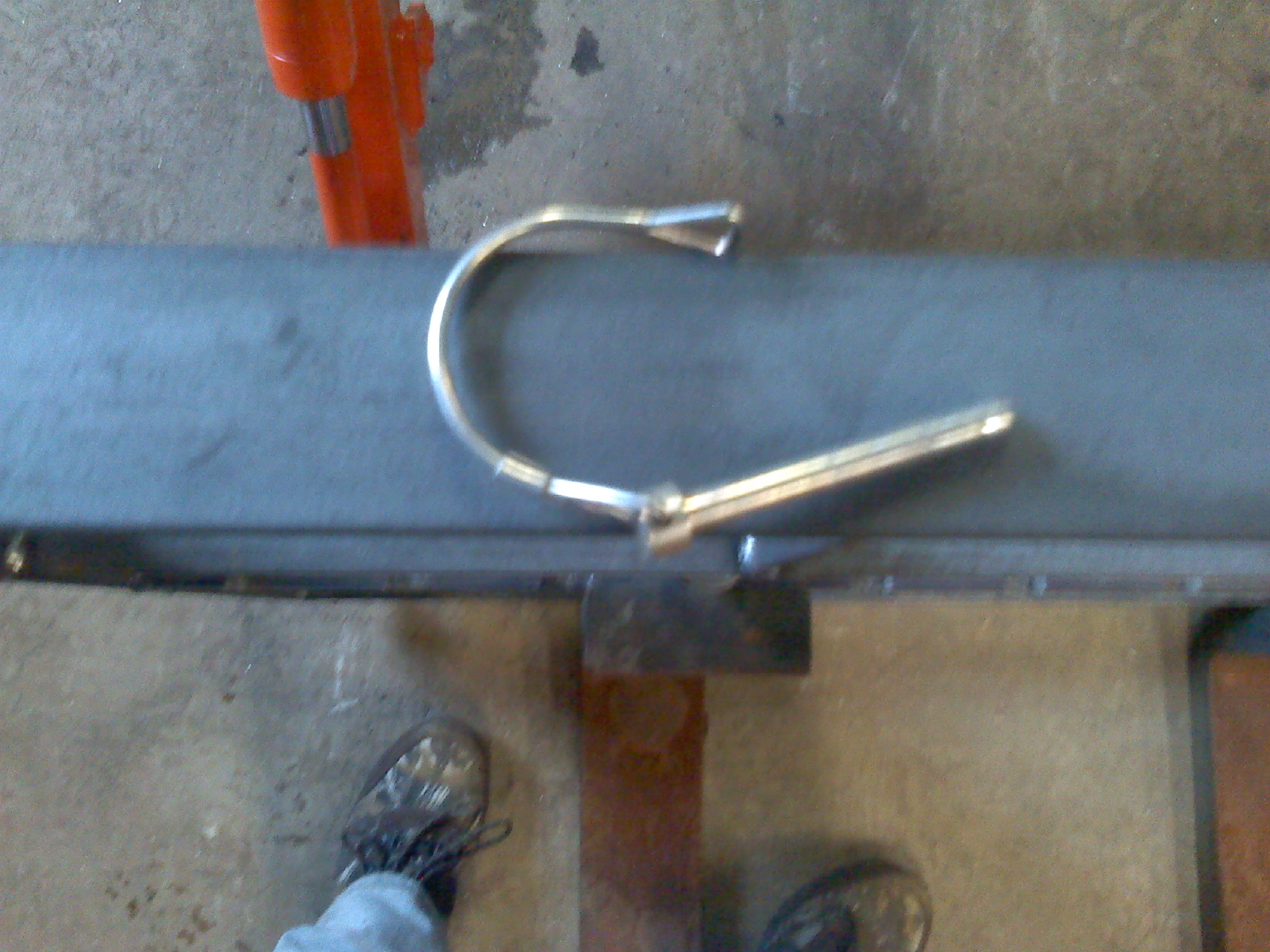

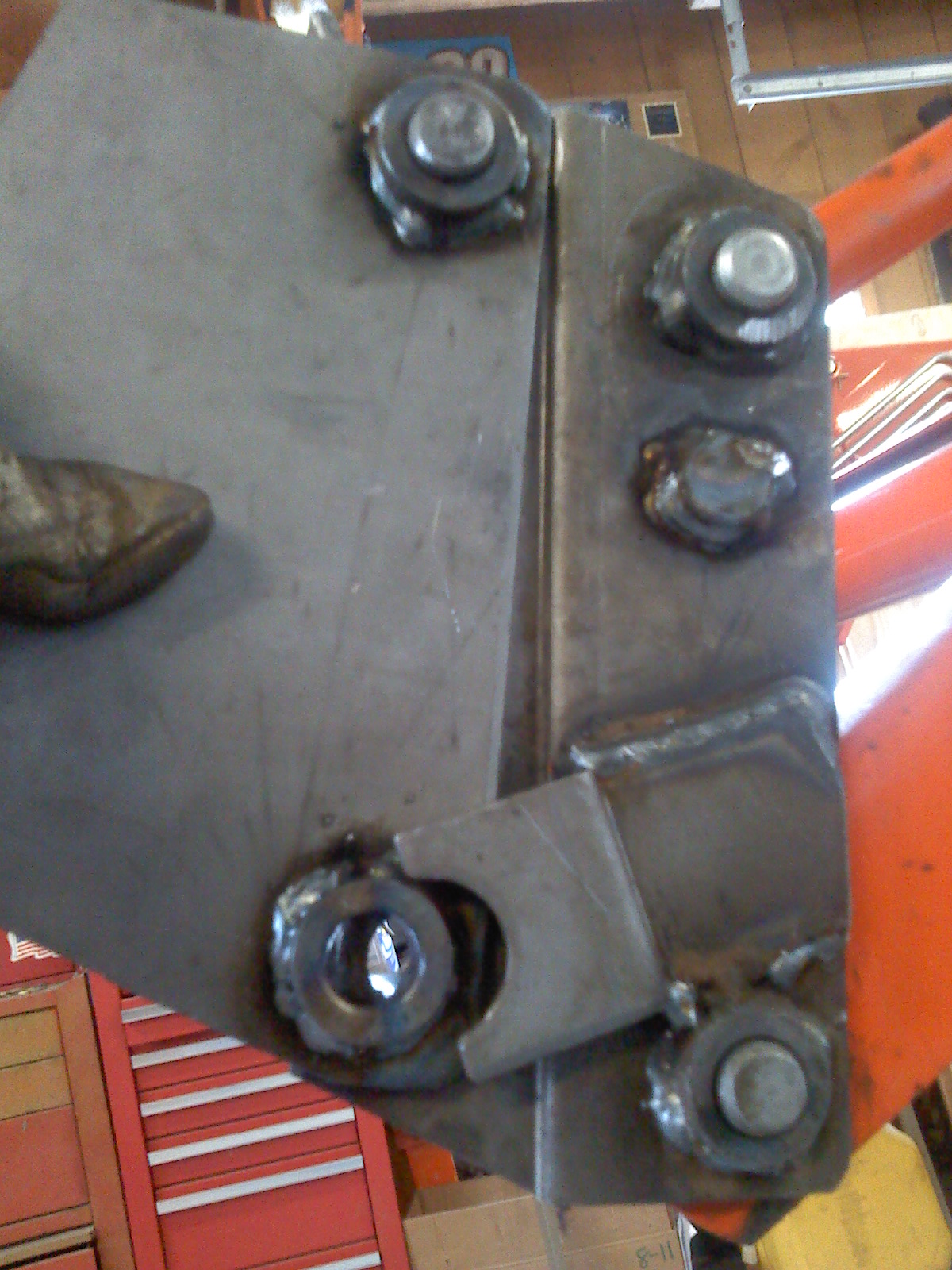

I took it off to paint it today and weighed it up and it comes in at about 19 lbs. Even less than I thought!!! :thumbsup:
I couldn't wait for the warm weather so here it is with a coat of paint on it.
I might get a second coat on it Monday.

You did a great job!!!:thumbsup:... Having a "Quick Attach" on a FEL is great!!.. I think all tractors should come that way!.. IMHO!
Now you can switch from your bucket to your forks QUICK!!:D
