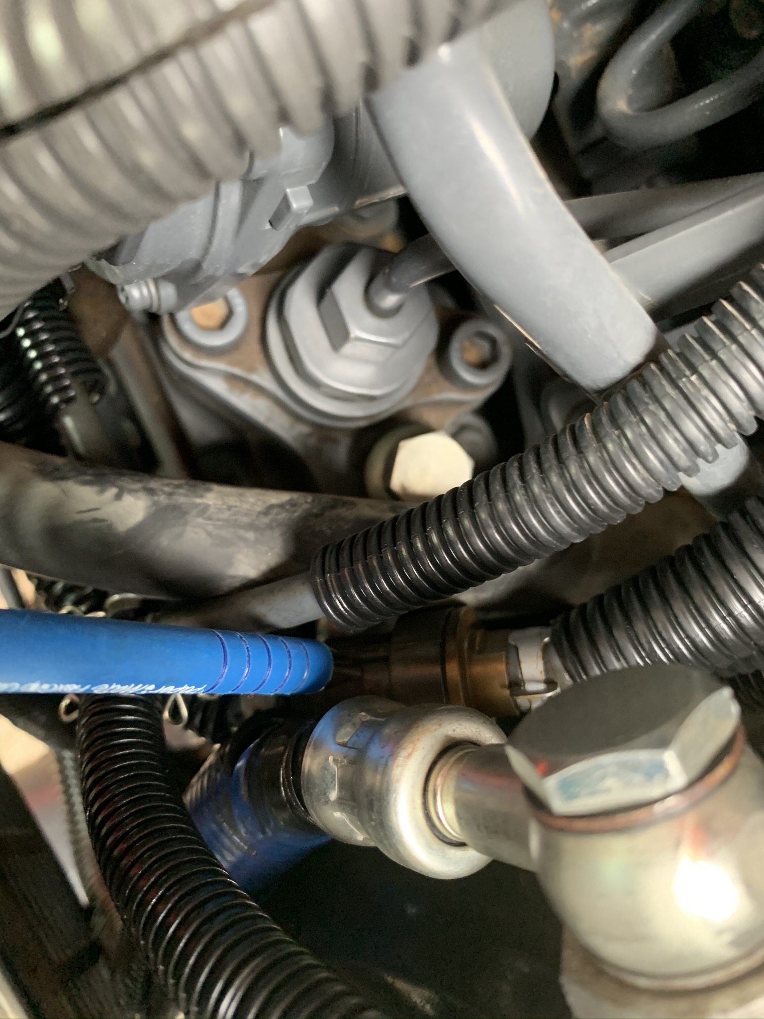

Well....it turned out to be one thing that I looked at but did not fiddle with. There was trash in the check valve that was keeping it open. When open, the fuel would just pump back to the return line therefore never building enough pressure to push the air out and never building enough pressure to cause the electric pump to shut off. At least this is what the mechanic told me. It starts fine now. This first pic is the invoice. My total was about $260. They also changed the screen in the water separator, which is probably where the trash came from.
Below is a pic of the check valve on the tractor at the tip of my pen.
And, another view of where the check valve is located (at the tip of my pen).

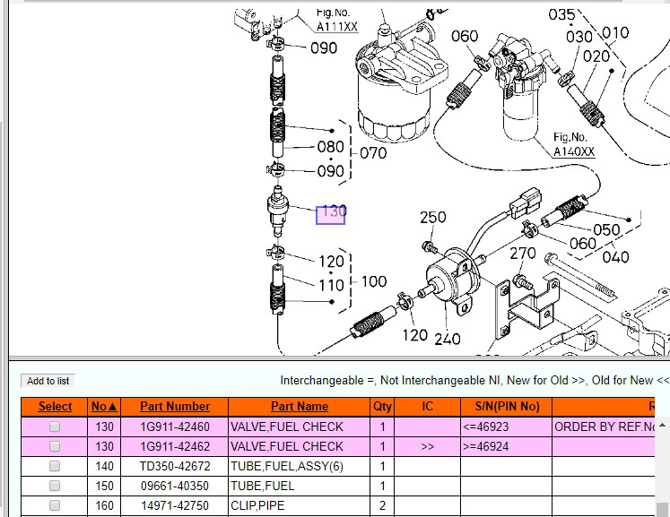

And finally, the check valve here in the parts diagram. I hope this helps someone in the future to save some time and maybe some money.

Awesome!!! Glad they got it going with no more money than that!!!!
Hopefully it'll give you good service for awhile now!!!!
   / L6060 trash in fuel tank #37
Gad you're up and running at reasonable a cost.
Thank you for posting the follow up info on where the check valve is located along with illustrated parts drawing! That's the way to complete a thread.
