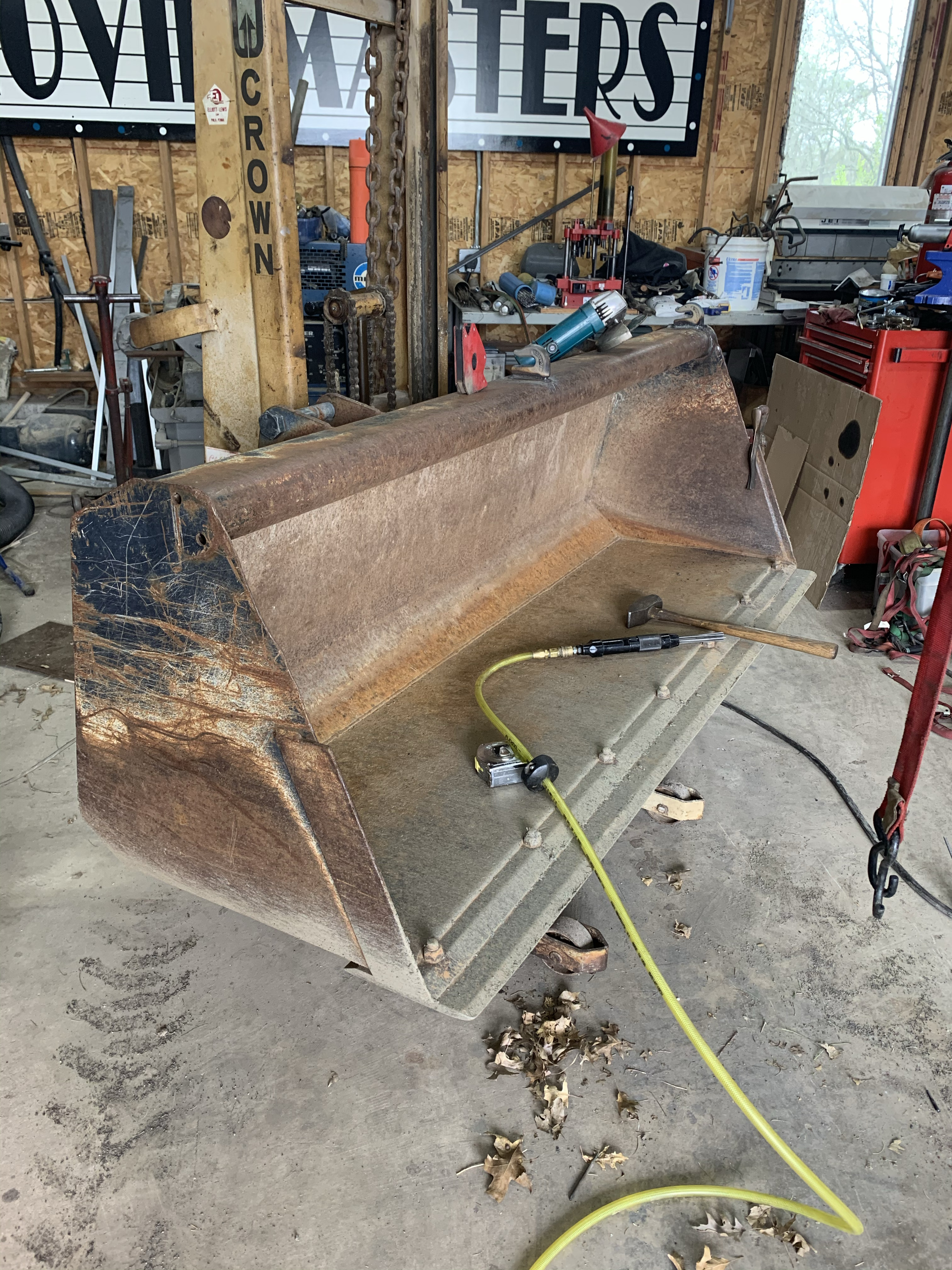

So today I was perusing online listings for SSQA buckets. Saw one that looked interesting, a nice 72” with bolt on edge in good shape from a Case skid steer.
Turns out it was less than a mile from me, I was able to snag it for less than $500. I just drove the 6060 over without a bucket and came home with one.
For some reason, I now have less buyers remorse about the 4in1.
I expect that you will find that a 72" bucket designed for use with a skid steer will weigh as much or more than your 4-in-1 bucket.

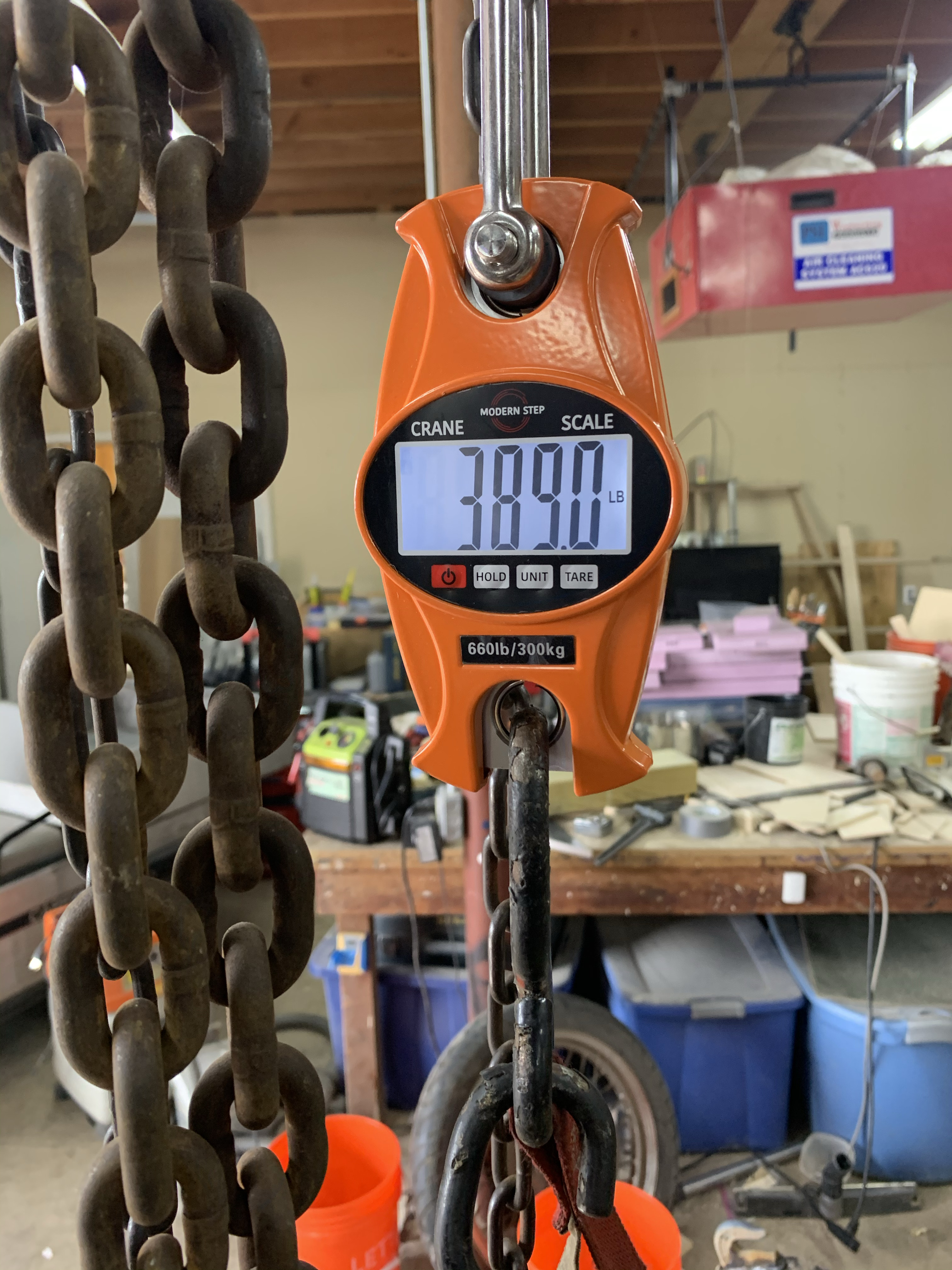

I brought it into the shop to weld Some hooks on it, so I put the scale on the hoist. The 4in1 is claimed to be 620 lbs in the spec sheet so my “new” bucket is at least 30% lighter. And that’s with a bolt on edge. IMG_3672.jpg
/ L6060 finally gets here. #34
Seems to be in good shape would say you got a good deal. Skid steer buckets tend to be heavier built. Some spray paint maybe if you get board on a rainy day and you’ll be in business for a long long time. Otherwise sometimes having old buckets is nice so you don’t feel obligated to keep it inside like a shiny new one

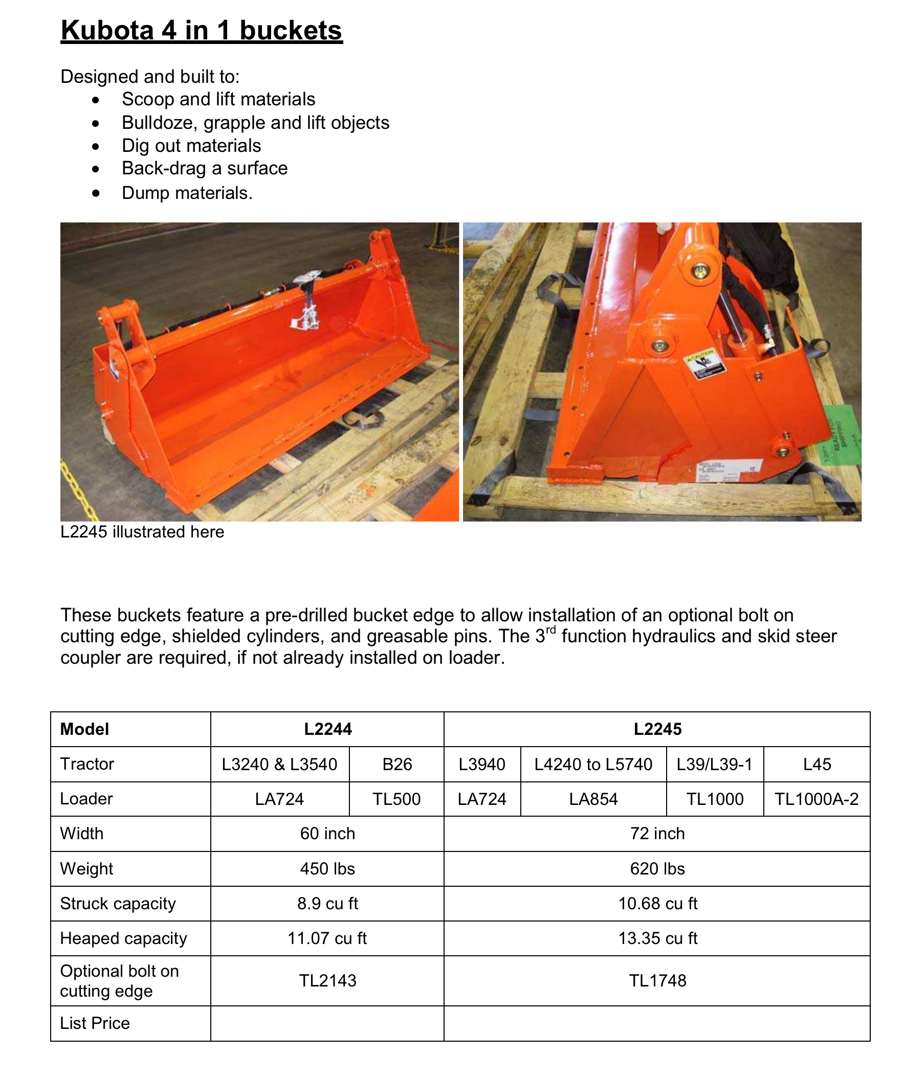

I brought it into the shop to weld Some hooks on it, so I put the scale on the hoist. The 4in1 is claimed to be 620 lbs in the spec sheet so my “new” bucket is at least 30% lighter. And that’s with a bolt on edge. View attachment 650694
The Kubota 4-in-1 bucket that I bought with my L6060 is considerably heavier than a regular bucket but no where near 620 Lbs. Indeed, the entire 1055 FEL (sans bucket) weighs 640 Lbs. The 72" light material bucket weighs 136 Lbs., and the 72" HD bucket weighs 180 Lbs.
No specs in the operating and installation manual for my Kubota 4-in-1 bucket but I'm guessing that it weighs around 300 Lbs.

I’ve got an L2245 4in1 bucket. Here’s where I got the 620 lb number from.
/ L6060 finally gets here. #39
That's the same one that I have but there is no weight spec in my operating/installation manual.
Doesn't look nearly that heavy but that explains why my 6060 will not back up a slight incline with an empty bucket unless in FWA.
Doesn't look nearly that heavy but that explains why my 6060 will not back up an incline with an empty bucket unless in FWA.
