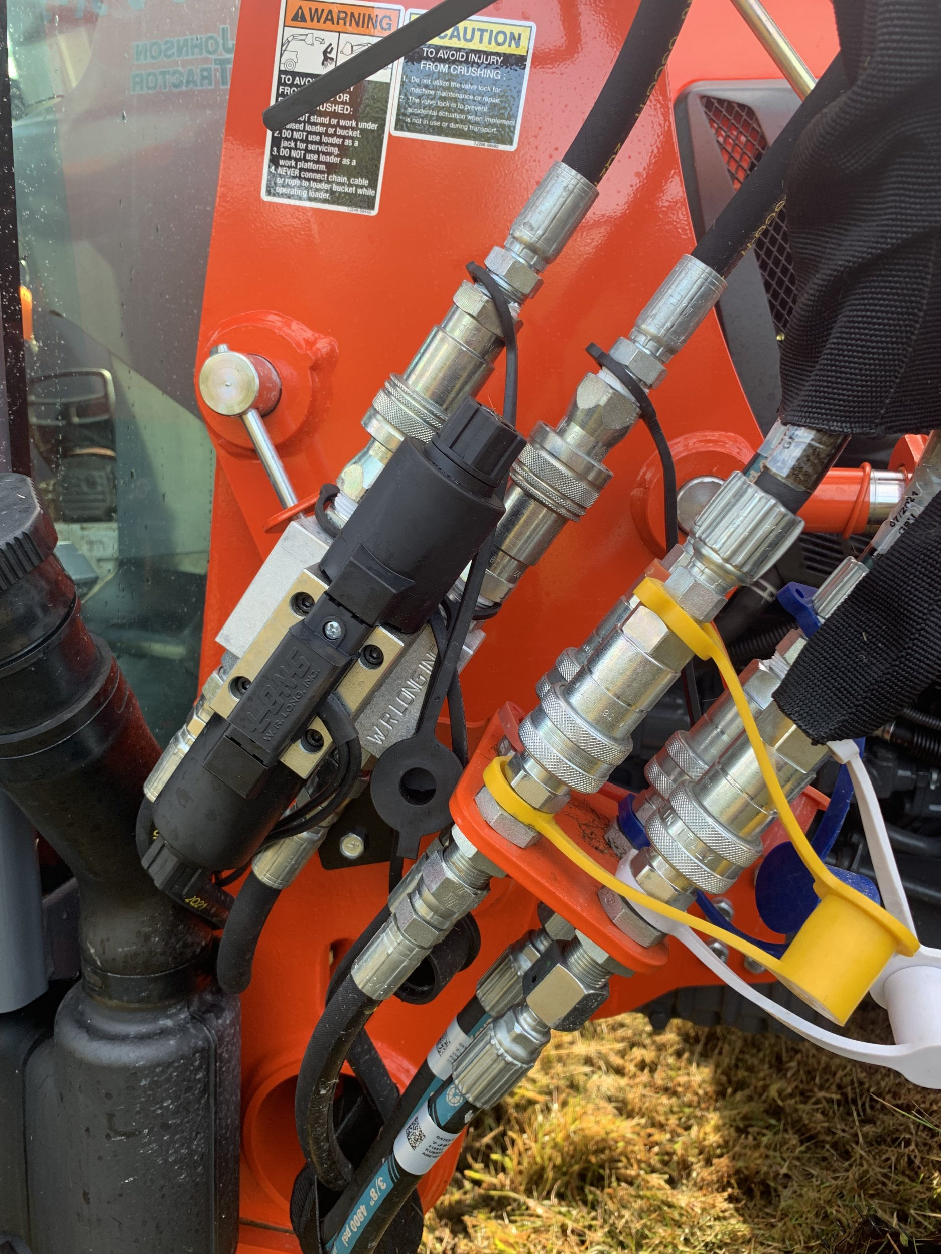

I just got a new L6060 today. I previously had an L5740. On my L5740, I could curl my grapple and open/close it at the same time. I am not able to do both simultaneously on my new L6060. I ordered it with the 3rd function remote. The dealer installed the WR Long 3rd function kit. Did something get installed wrong or is this not possible with the L6060?

Got a picture of the system.
Some people (like salesmen) falsely refer to a diverter as a 3rd function

According to the WR Long website the 3rd function will operate separately from the loader functions as long as the PB valve is live all the time. Not sure if that is the case with the L6060.

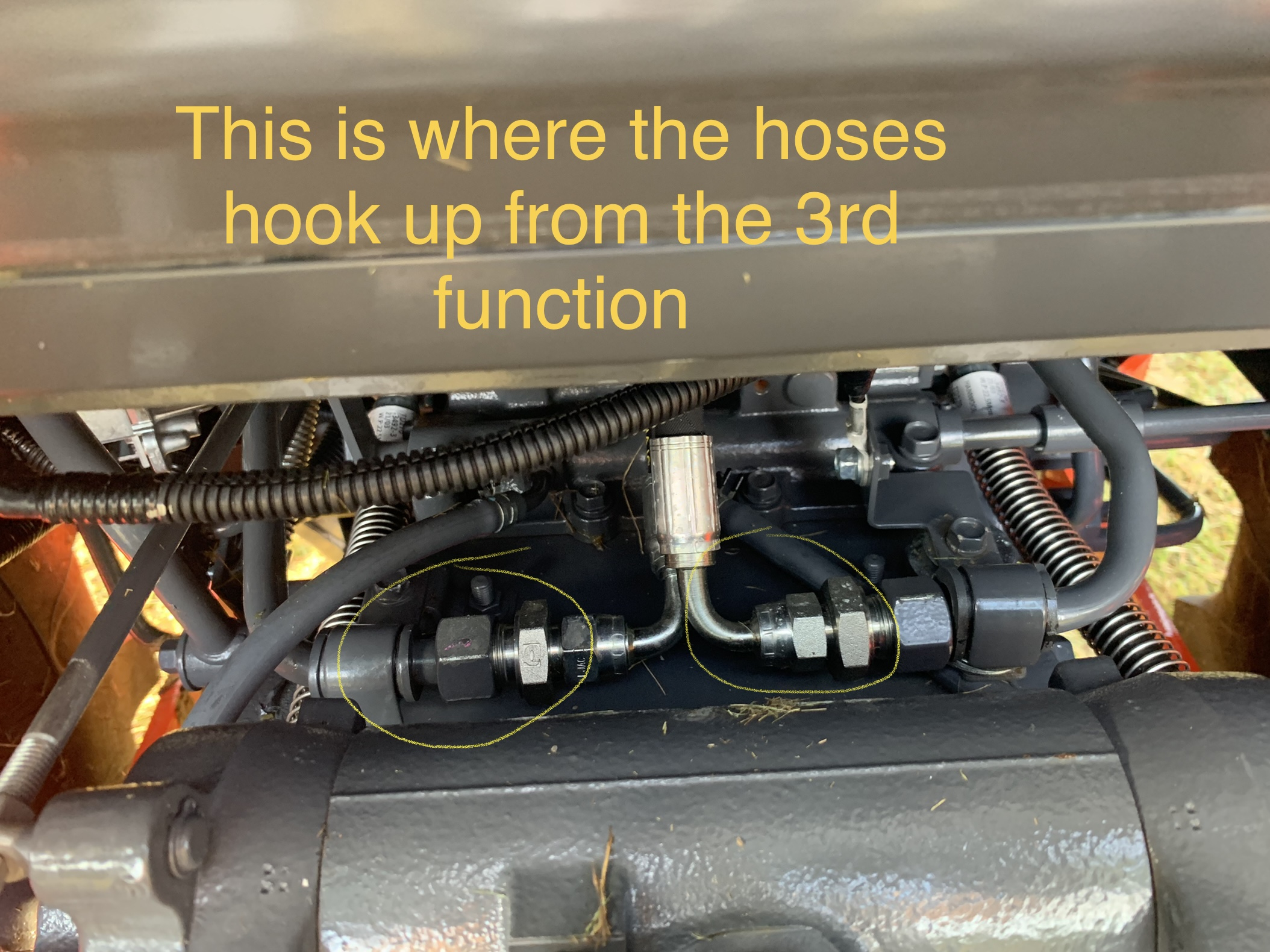

Another possibility is that the 3rd function was BEFORE the loader valve rather than after it off the PB

USSharrylee's system( as pictured - post#7 ) look just like mine. Except - mine is on the inside of the loader arm. In the space between the hood and loader arm.
/ L6060 3rd Function Curl and Close Grapple Simultaneously #13
I believe you have a diverter valve rather than a true third function.

I have a dealer installed 3rd function valve on my L6060HSTC. The FEL raise, curl and grapple functions all will work at the same time but at a reduced rate.
I would check the plumbing on your valve to make sure it was installed properly.
