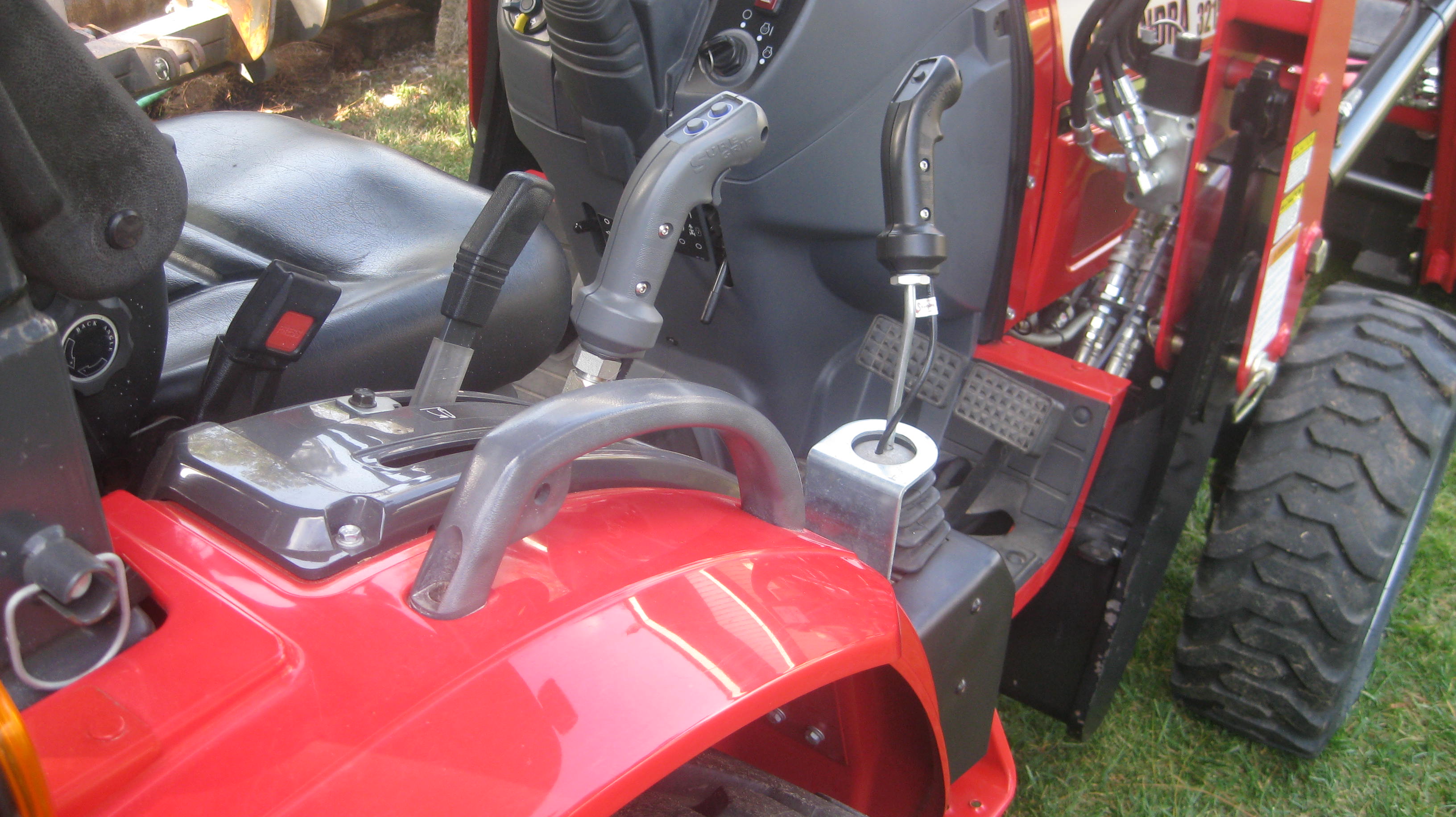

3 diverters, 1 control valve with control grip. 4 sets of couplers that all have feathering & full capabilities of the controlling valve.
I have had customers install this same setup on their L6060s. The diverters mount well right on top of the factory valves at the rear.

Yes I am furnishing valves and mounts as well as the T&T sets.
If you go to the Fit Rite website and go to the customers share section, there is a guy with an L6060 on page 3&4 that added a pair of diverters. You can see the diverters as well as the control grip installed. I have others that have added a triple diverter set in the same way.
I normally recommend that a customer go with the 3 factory valves and then 3 diverters if-when they need 6 sets of rear remotes. Makes for a very neat & clean installation with ZERO additional hoses.
