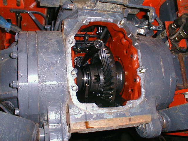

Is it the lift ARM that is breaking, or the lift LINK? What is the $150 bolt?
/ L5450 #5
Hi Sumner - and Gene !
Here's a pic that sorta shows the two lower 3-pt link attachment points on a L5450. 2spd3.jpg.
The "bolt" is not your everyday bolt. Hope it's the bolt that breaks and not the ear on the housing.
/ L5450
That's exactly what it is. It is an expendable bolt for the purpose of breaking instead of the ear of the housing breaking. It just broke twice in one month with the same implement. Just curious if this is an issue for other people or if it is just a coincidence.

/ L5450 #8
Those bolts actually mount in ears on each 32590-28163 brake housing. That part is around $600 (there's one on eBay for $250 that includes the bolt and other parts). The bolts have a fancy shoulder I think but I couldn't find them on the parts website.
Haven't heard of these failing - can imagine a long attachment being hit from the side?
/ L5450
#9
Well the ears haven't broken...yet. The bolt simply sheared off. I think the bolt was faulty and broke it broke a second because it had been welded. I know when my father in law check at Kubota it was about $150-200 just for the bolt. Fortunately the housing ears are still good.

/ L5450 #11
The bolt is probably a zoot alloy or has been heat treated so it needs extra steps to repair to full strength. Easier to just buy a new one if available.
The L5450 does have two clutches but not a conventional 2-disk progressive setup. The travel clutch is the multi-disk hydraulic clutch pack they call the Ever Clutch. The foot pedal actually just operates a fancy hydraulic valve. The pto clutch is a separate dry disk, operated by a linkage and hand lever beside the seat, disengaged up, engaged down.
It's a little unhandy - lever has to be up to start the tractor, then it's supposed to normally run engaged, lever down, to reduce wear on the release bearing.
