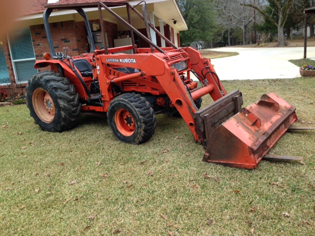

That L5450 is a whole lot better looking than I had imagined. Actually it looks pretty fair if you ask me. I am not seeing much of the skid plate, hopefully it serves its purpose well. You will get a lot of work out of that girl. Nice save.
/ L5450 feedback, please
#26
Dick I like your loader removal device. I like making use of what you have. Concerning using the QA for loader removal, I've attached a picture of the side of the QA where the arms would attach. Looking at the pages from the loader manual you sent, I'm thinking that a hole for the arm attaching bolt could be placed in the same approximate position as it is in the sketch from the manual so the arm will lock against the bucket as it rolls backward. Judging from the pictures the attachment holes would be about 2/3 of the way up between the arm pivot and the cylinder attachment points. The unpainted part in the picture below is the fork plate and would be replaced by the bucket. Is my thinking flawed? I really want to get to where I can remove the loader as intended.
Tom, Thanks for your comments. The skid plate is obvious as you walk up to the tractor because you are looking down on it. It would be necessary for use in areas where objects on the ground would snag hoses, filters, and linkage. I'm glad it is there. It is attached by about 12 bolts to the tractor and loader undercarriage, so it will drop down pretty easily. I'll drop it down and paint it Kubota gray and it will look a lot better.
