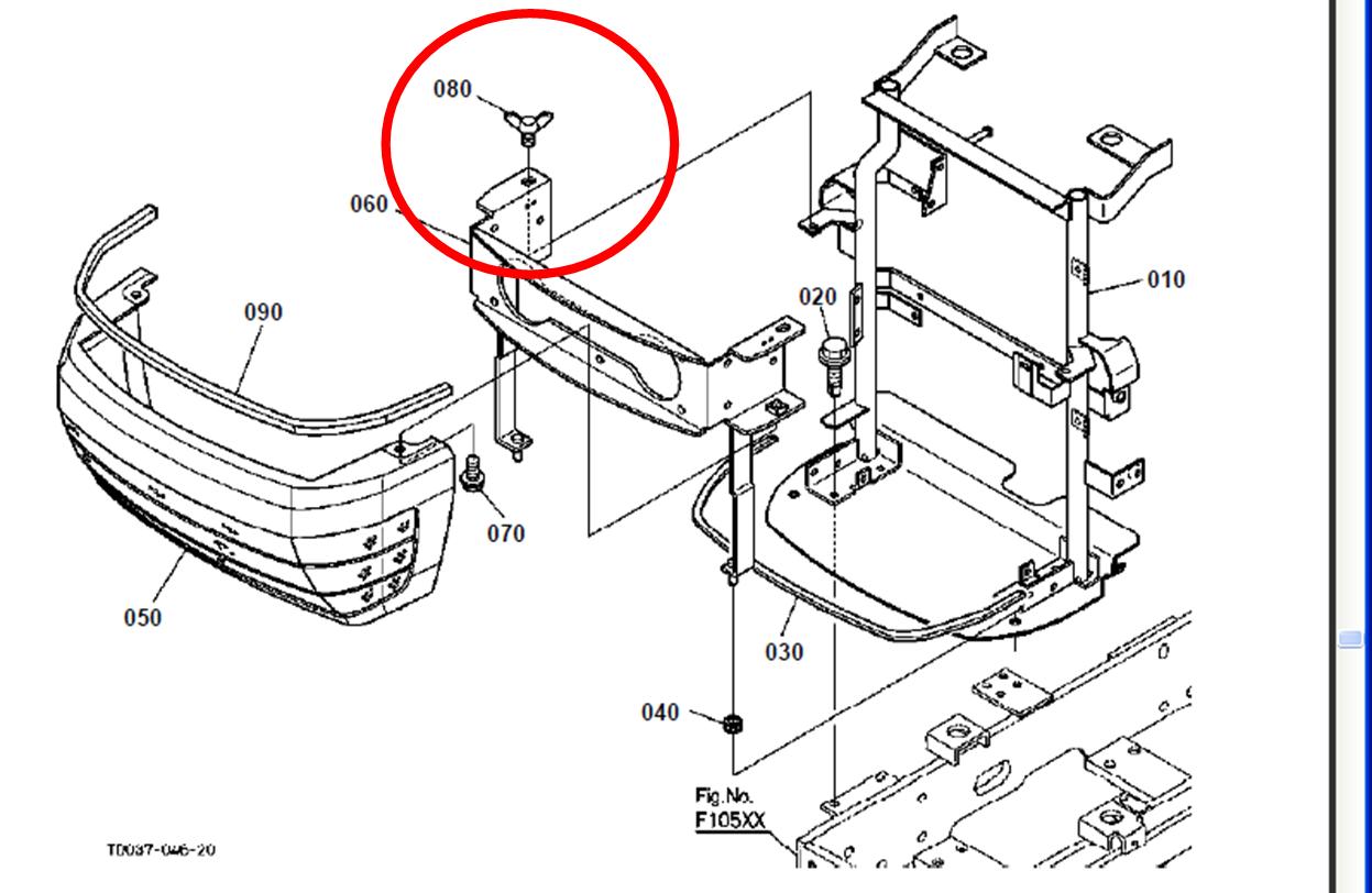

My battery is slowly wearing out. I looked under the hood and I see that the air cleaner has to be removed and the breaker bracket needs to be bent out of the way and then it might just have enough clearance past the rear of the headlight to be able to remove the battery by pulling it straight up, maybe.
Or is there an easier way?

It might not be the same, but on my L3130 the headlight/grill comes out with two wing nuts to gain access to the battery. Maybe yours is the same.
/ L5030 battery change out #3
Here is a picture to show what I was talking about in the previous thread.

I saw that wing nut! I'll check that out thanks.

I forgot to mention, but the bottom of the headlight/grill assembly has pins that are in rubber grommets. Tilting the assembly forward and rocking a bit helps get it out depending on how tight yours is. Also do not forget to disconnect the headlight wiring harness if there is not enough slack in the wiring.

As stated, the headlight assembly easily comes out by unplugging and the wing nut. I usually but Die Hard or Interstate batteries, but have not replaced the one in my L5030, so I don't know the model numbers. Good luck.

Thanks guys, the new Odyssey battery is in and the tractor is so happy. Two wing nuts and one electrical connection unplug, and the entire front lifted off. I didn't even have to take off the air filter.
