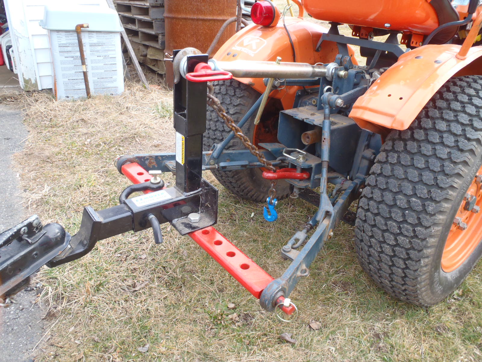

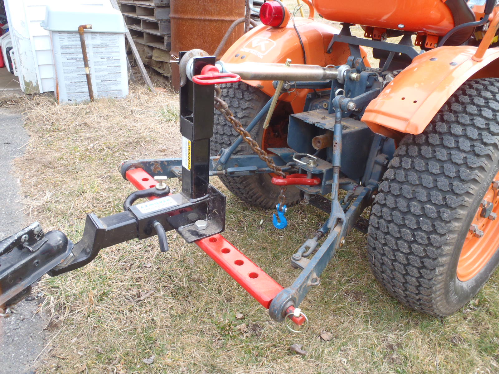

I pull my dump trailer with my L5740 attached to an A-frame hitch. Mine is a smaller trailer that holds about 1.5 yards. One reason is the drawbar hole is 25mm and 2 5/16 balls come with 1 inch studs but it is convenient to pull the trailer, unhook, load it, hook back up all without needing to crank on the jack. But when I dump I know the hitch will raise up so I always raise the 3 point to its limit. Towing I keep the hitch rather low so under braking the weight of the trailer won't raise the hitch (receiver below the lower arm front pivot points).
/ l4600 three point capicaty question #11
When towing a trailer with the 3pt, I add a chain connecting the draw bar on the transmission to the top link on the implement.
This prevents the 3pt from rising if the load center shifts aft:
Great idea for sure. I have not seen this before. However, may I caution anyone to at least give the chain a couple inches of slack, if your weight distribution is more towards the back causing the 3pt to lift, your going to want a way to know your load is unbalanced. Knowing this may effect how brave some may get in tough terrain or what have you just by knowing that you won't have X amount of weight on the rear tires. Seriously though that's a good i-dear Baby Grand.
