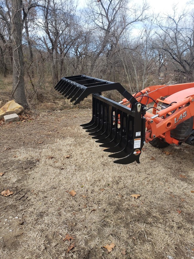

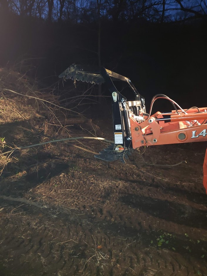

ended up going with the Land Pride unit from the dealer. my quick-connect hydraulic fittings on the front turned out to be quite a mystery for the dealer. Since my unit was ordered with a 4 N 1 bucket the fittings were some odd size. The dealer was through in a set of male and female coupler ends so that i could get to work today. I am really impressed with the unit and ease of operation, however, just kicking myself for not buying this thing years ago. i moved everything today from a 4' x 4' x 4" concrete slab to a pile of leaves. Ultimately I purchased to help with the clearing of some land that I have been working on for quite a while this thing is a total game-changer for that.
my only complaint will be my first modification. I noticed a limb come right through the 2 open areas on the back of the grapple almost contacting the hose. I have some medium-duty expanded metal that I plan on welding in place to protect the front hoses and the tractor. Probably should build a better brush guard for the entire nose but time is precious these days.

Thanks for the comments, I'm thinking of getting one of these grapples and that's a good hint about the expanded metal. That also reminds me that I also need to add some expanded metal to the grill guard of my stock M59. It's strikes me as odd that although the brush guard is built to stand up to a boulder, nothing stops a sharp stick from getting into those expensive radiator parts up front.
Or maybe not so odd, I designed machinery for a company for a dozen years and during that time there was a lot of design input from managerswho had never used their own products.... but never once did I hear from a person in the field who actually used the things. At the time that seemed normal..... now I wonder why....?
Anyway, that's my bad; I should have taken the time to go visit with customers myself on my own nickle. The product was good, but if I had talked to customers it would have been better.
When I order the grapple I'll be sure to specify that it comes with expanded metal shielding on the back.

After another days use i see no need for anything wider than the 60" unit I purchased. Now if I had gone with the more rock bucket-style then possibly a 72 would come in handy however for my immediate need as well what I see myself doing down the road with it the "root" style seemed to be the best fit. I have a 4 N 1 bucket also that I use on a regular basis but for brush, it is not very effective.
I am amazed at the ability to rake the ground with the grapple, after using the backhoe and thumb to grub trees I can then turn around to finish the area with the grapple.
