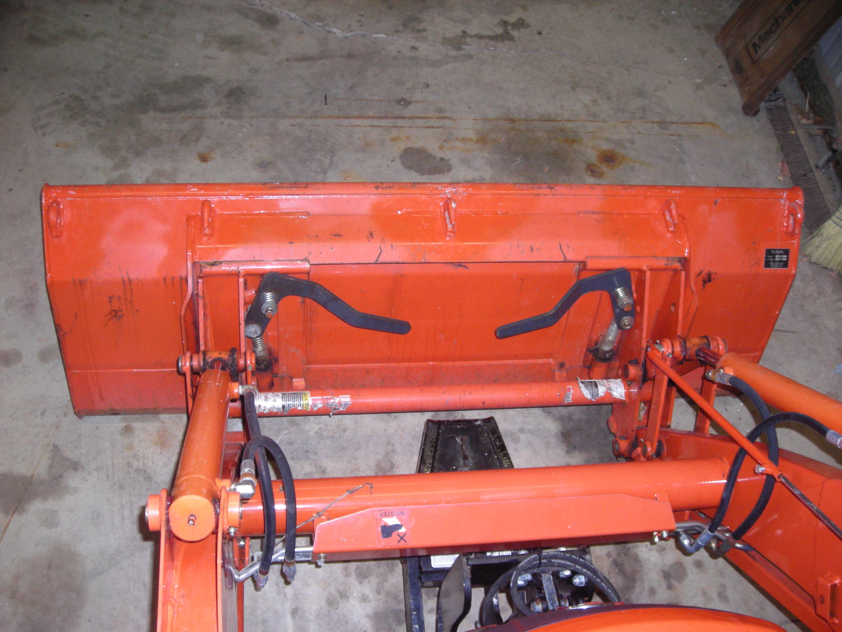

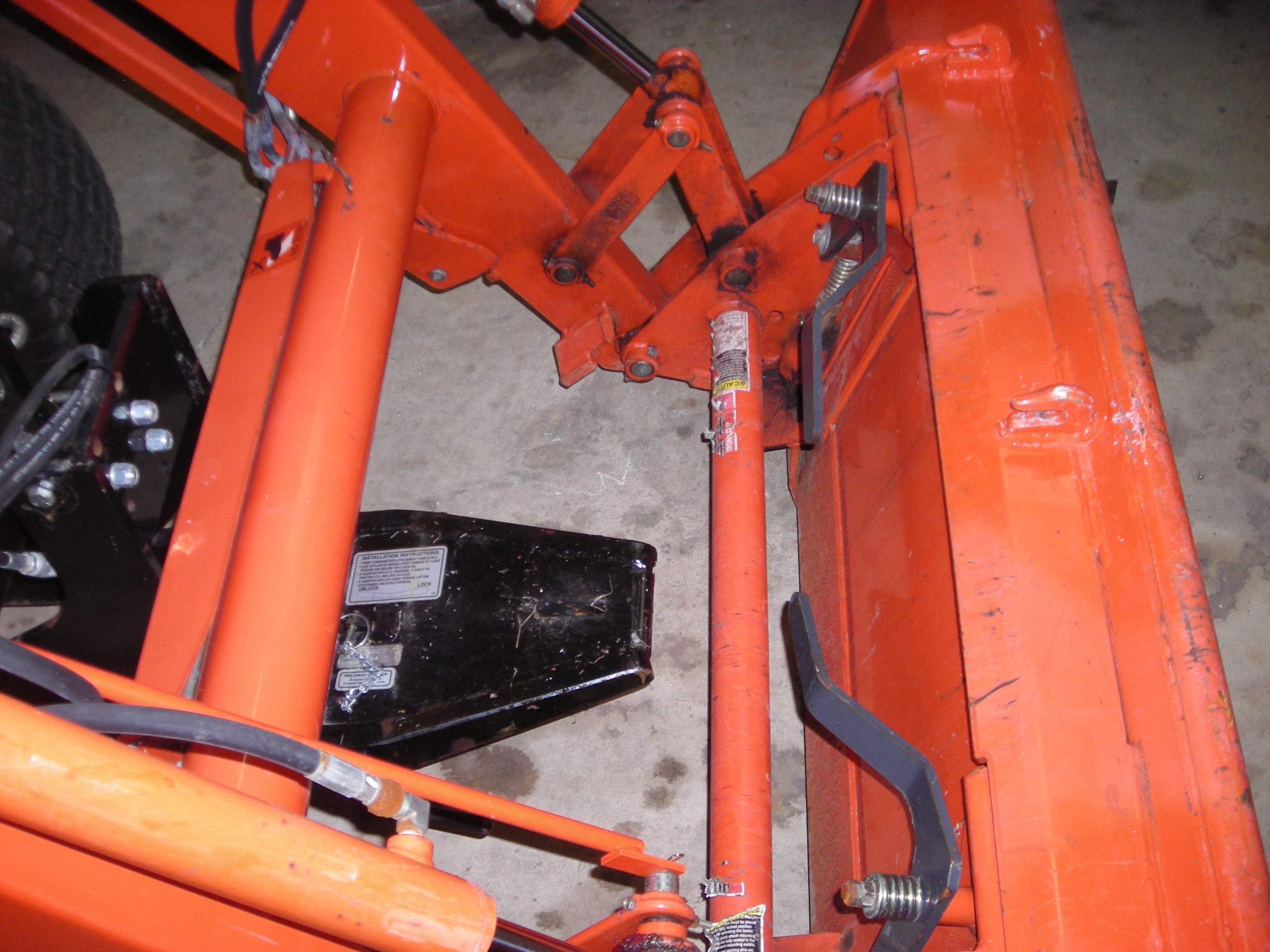

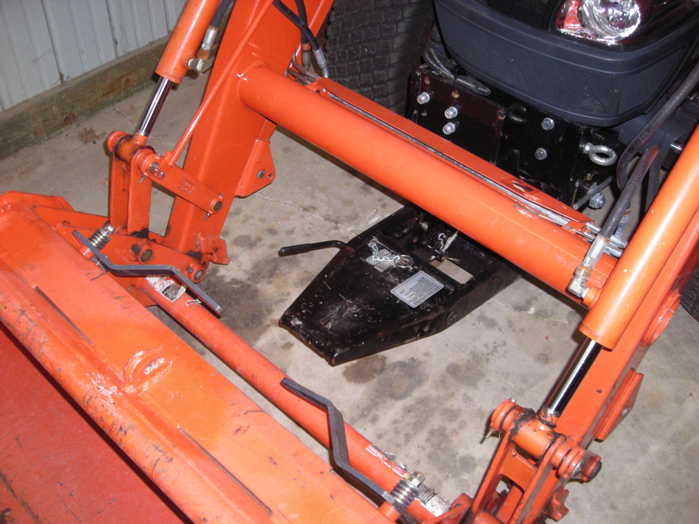

Mounted the sub-frame for my plow this week. Just for kicks mounted the FEL with sub-frame attached to see if it would work. #1, the grill guard has to be removed, it interferes with the sub-frame hydraulic cylinder. The FEL is operational with the sub-frame mounted, but there is interference between the loader bucket in the lowered position and the nose of the sub-frame if the bucket is rolled back too far. Depending on what your needs are, you can use the FEL with the sub-frame attached. Philip.

I would have to try again but I think my 4240 with the 854 fel doesn't hit. The tractor was new so I may have not tried it in every possible position. A fellow, thought it was you, TBNer said he was able to put the grill guard on with the front subfame mount without issue but I didn't try it. It's nice to know that if I ever need to push a snow back back I only need to remove the blower from the quick hitch.

A fellow, thought it was you, TBNer said he was able to put the grill guard on with the front subfame mount without issue but I didn't try it.QUOTE]
The grill guard and the front sub-frame bracket will mount without issue at the same time. Grill guard and sub-frame, no. Philip.

I read your other thread after I read this one last night. Unfortunately the two upright mounts for the hydraulic cylinder on the sub frame end up in the same spot as the lower cross member on the grill.
