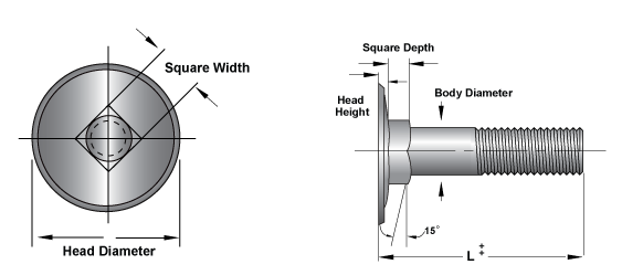

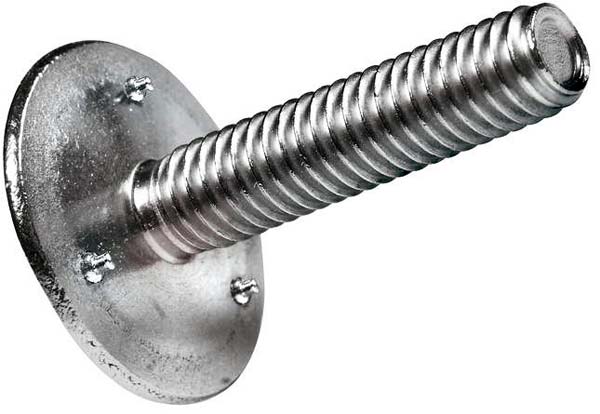

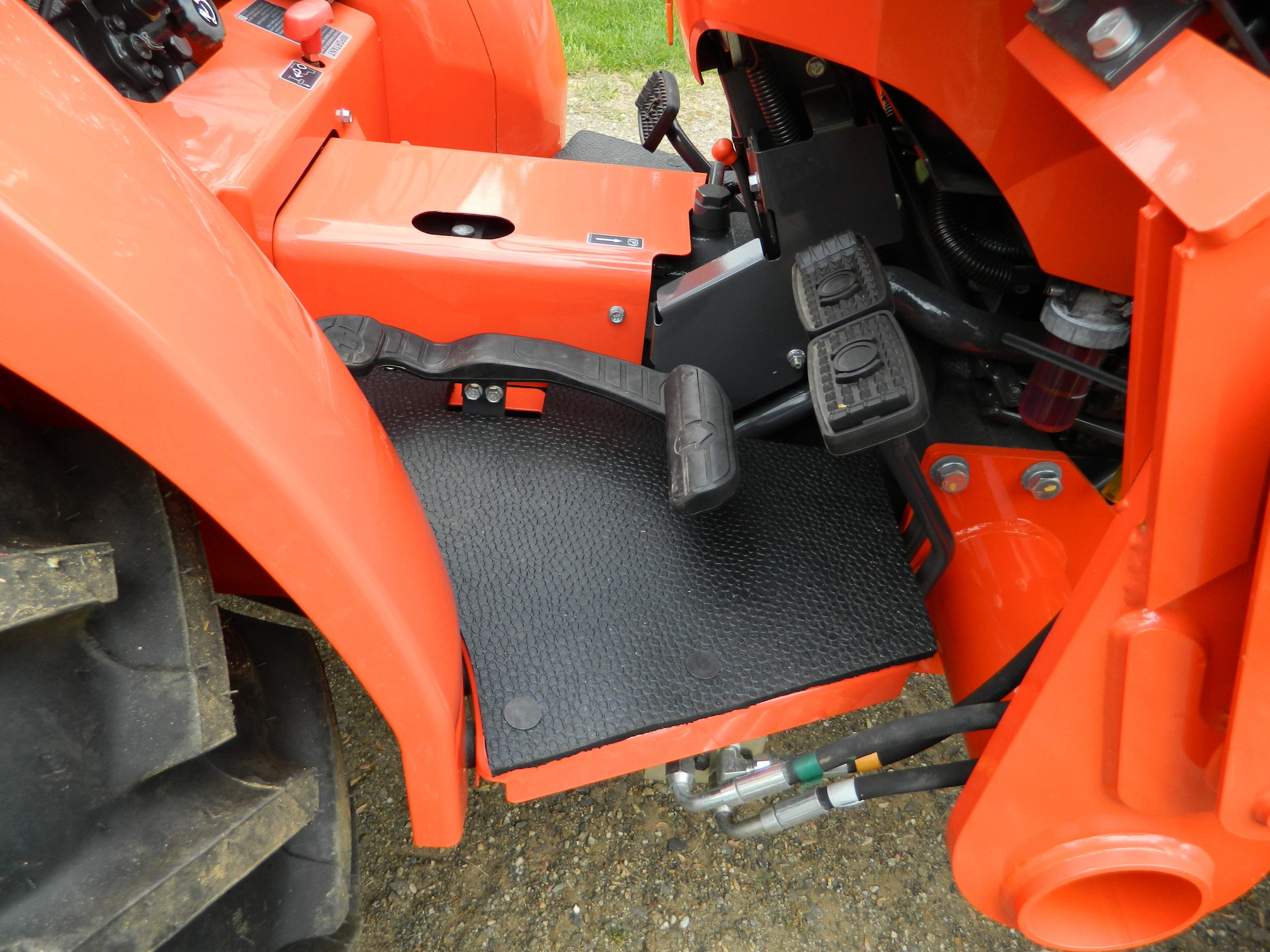

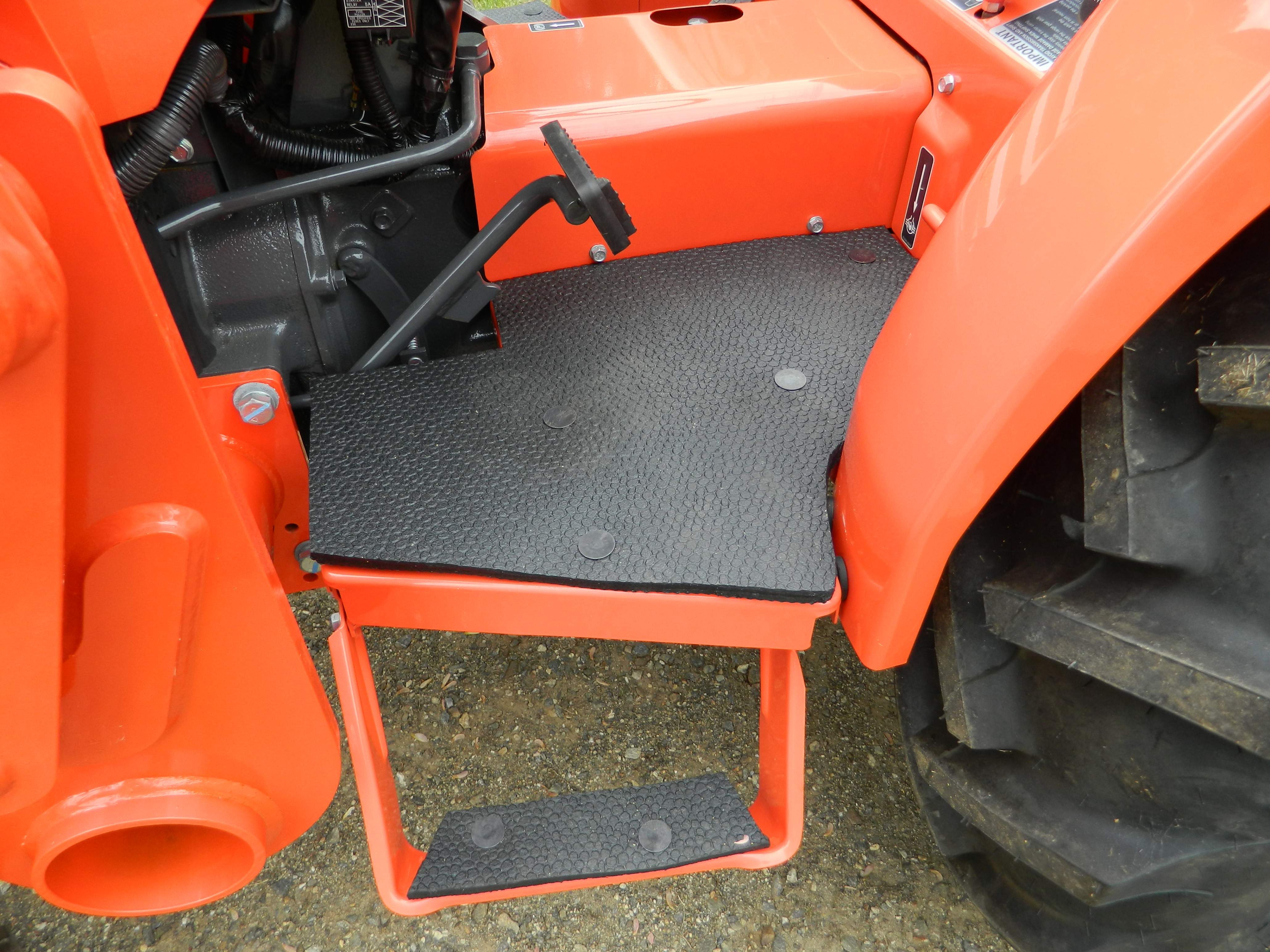

So I made the first mod to my brand new L3901. I thought it would be a good idea to cover the deck with a mat to protect it as well as to reduce any potential slippage......plus I thought it would look better As they do not make any factory mats, I picked up a small stall mat at TSC and some elevator bolts, fender washers, nuts, and was in business.
After tracing and cutting a template, the hard part was cutting through the half inch rubber. All in all, I think it came out pretty good. I may make a piece for the center and attach with velcro strips. Did not have to drill any holes as I used the existing perforations on the deck.:thumbsup:
