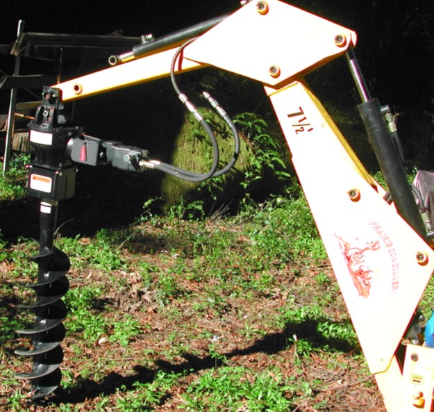

Anyone used a PHD on the end of a backhoe before? Pros? Cons?
I haven't used one, but am in the same position as you, in that I am looking for a hydraulic auger for my TLB. The ground is so hard in my area that I really need down presure, and lots of it. A year ago it took my neighbor all day to drill one 9" post hole with a 3 point PHD.
I am thinking more along the lines of something that mounts on the front of the machine rather than the backhoe. Like this one General Equipment DIG-R-TACH 671-753 Earth Auger Attachment or one of these General Equipment DIG-R-TACH 471 and 553 Earth Auger Attachment
The main reason is that I find it is many times easier to use an implement on the front of the machine rather than on the back. And, my 110 has a creeper switch which makes maneuvering from the backhoe seat much easier than your L39 will.
I don't know if this would fit an L39, but I would look into it. (The L39 has a skid steer like front bucket attachment, the 110 has a skid steer front attachment.)
A PHD is something where you want to be able to quickly drive to the exact spot you will use it, set up, and move to the next post hole. I can take quite a bit of time to set up to use the BH, but a PHD should be a lot easier.

I've used a skid steer with PHD, and it is really nice. I'm not so sure a quick-attach PHD on the FEL of a tractor would be as easy to work with - you can get to the hole quickly, but making the minor adjustments to get the auger into position would be much more difficult with a tractor than a skid steer. However, although it would take a little extra time to get TO the location of the hole using a backhoe mounted PHD, it would be much easier to line the auger up exactly where you want it to go, and make the adjustments as you drill down to keep the holes straight. You're much better able to see the hole from the backhoe seat than from the tractor seat using an FEL mounted PHD.
Not sure if the L39 has the forward/reverse drive lever like the JD110 (I love that feature), but if it does, it's pretty easy to drive the machine around from the backhoe operator's seat, which would make digging with the backhoe mounted auger even easier.
I have a Worksaver 714H adapted to my Prairie Dog hoe. This unit
comes with all the hardware to bolt it up to the side of a FEL bkt. I
fabbed the bracket to mount it to my b/h dipper stick. Do a search
for the many good discussions of Hyd PHDs on CUTs.
Downside to hyd vs. PTO 3-pt PHDs? Only the price, as far as I
can tell from having both. $1500 for the hyd, and $500 for a medium
duty 3-pt PTO PHD. They use the same augers.
Note that if you operate a hyd PHD off your loader bkt, you have 2 less
ranges of motion than you have with a hoe mounted unit. The hoe
mounted unit has main boom up/down, dipper stick fwd/back, and
swing left/rt. That assumes you use the FEL curl circuit for the hyd
motor.
