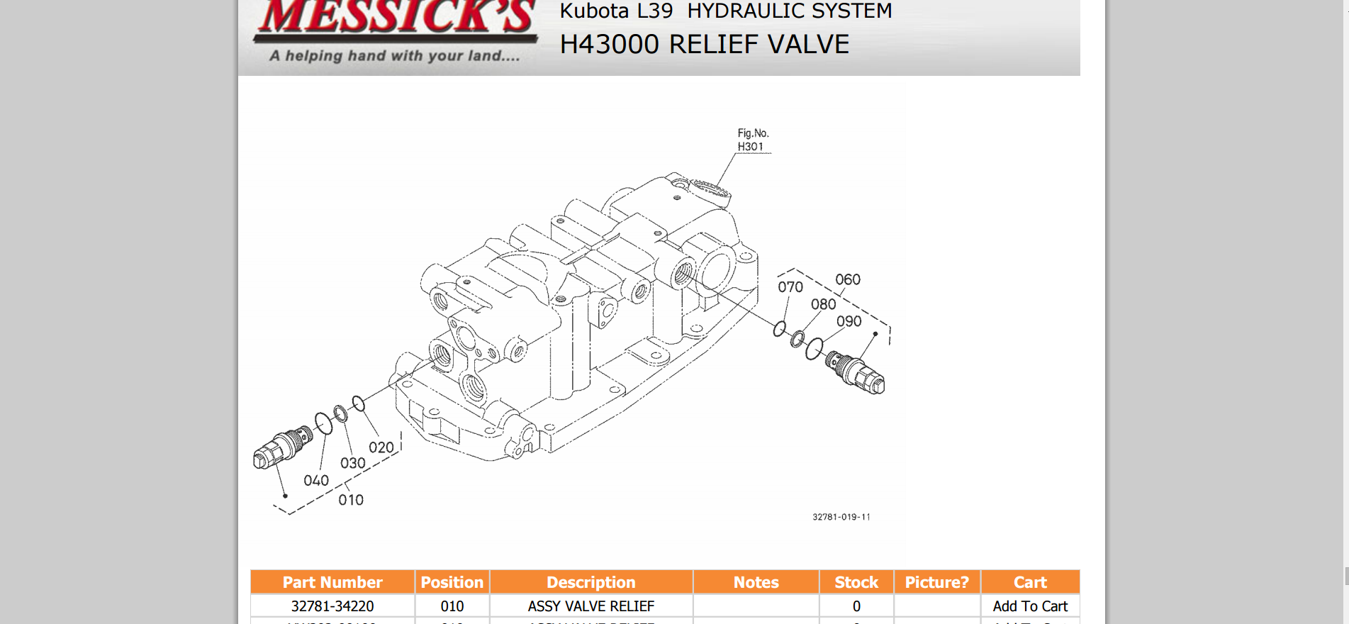

When you check the reliefs, check upstream first, as that relief sets the max pressure. Check the relief is this order. FEL, remote , BH, 3pt.
You also have work port reliefs.
Relief #60 is swing relief

I believe there is a relief valve on the BH valve itself, and it sounds like your testing the main one on the tractor side is that correct? Does your WSM cover the BH valve bank in detail and offer any testing for it specifically?

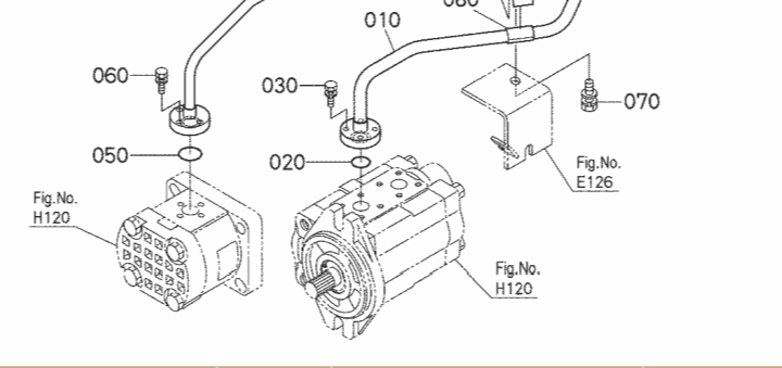

You have at least two relief valves on the rear of the tractor, and several of the valve stacks have work port reliefs, which are probably set reliefs.
It is doubtful that two pump would be that weak or bad.
You actually have two pumps.
The one pump has two sections.
One section is probably for swing, and the other is probably for attachments.
So if you set the FEL relief, that would probably set the relief for the BH.
So, do this to check this out.
Install the gauge in the pump line going to the FEL.
So in theory, if you maxed out a FEL cyl. you would see attachment relief psi setting.
Then max out a BH cyl, and you should see similar pressure on the attachment relief setting.
If you want to check the swing circuit, install the gauge in the swing pump circuit before any valve.
Then max out a swing cyl and observe the relief psi.
Let us know what you find out.

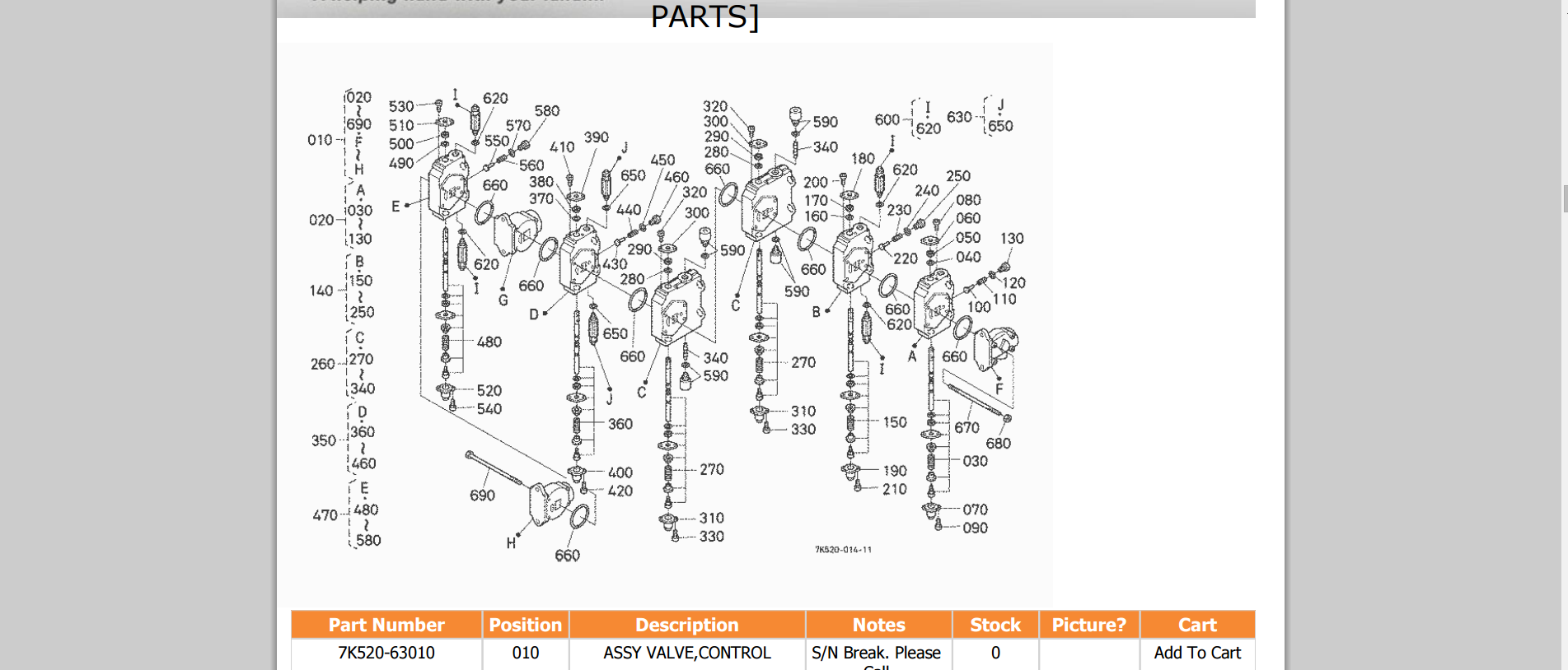

There are also two relief valves on the loader control.

-Boom (both directions) and dipper extend fail.
When you did that, what pressure did you see?
You could switch hoses on the BH valve and see if a spool is bad.
On the boom spool, you could extend the cyl and then remove the rod end hose and try and extend some more. If fluid comes out the rod end port, the cyl is bypssing.
If the cyl checks good, and you still can't get pump max pressure, then the valve spool is bad.

You might put the gauge in the failed cyl circuit and see what the work port pressure is.
Check your manual for the work port relief settings.
Did you switch hoses to a known good spool to check pressure.
Was your hyd gauge in the BH circuit when checking out the BH?
Can you list the max pressure readings for each function extend and retract.
