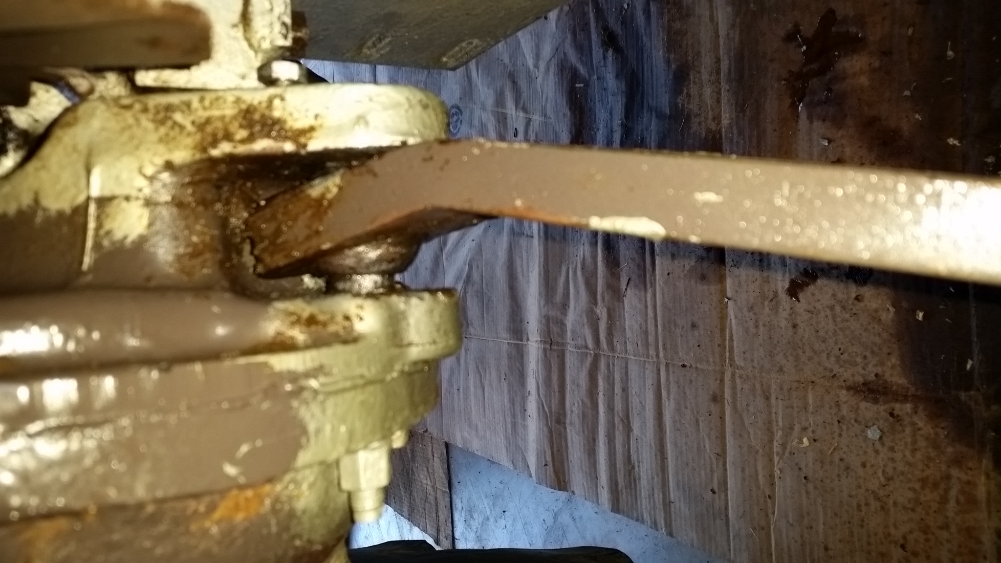

I am trying to replace the lower arms on my L3710 and it looks like the pin holding the arms in terminates in the brake case. The pins are very rusted and won't budge. Please help?

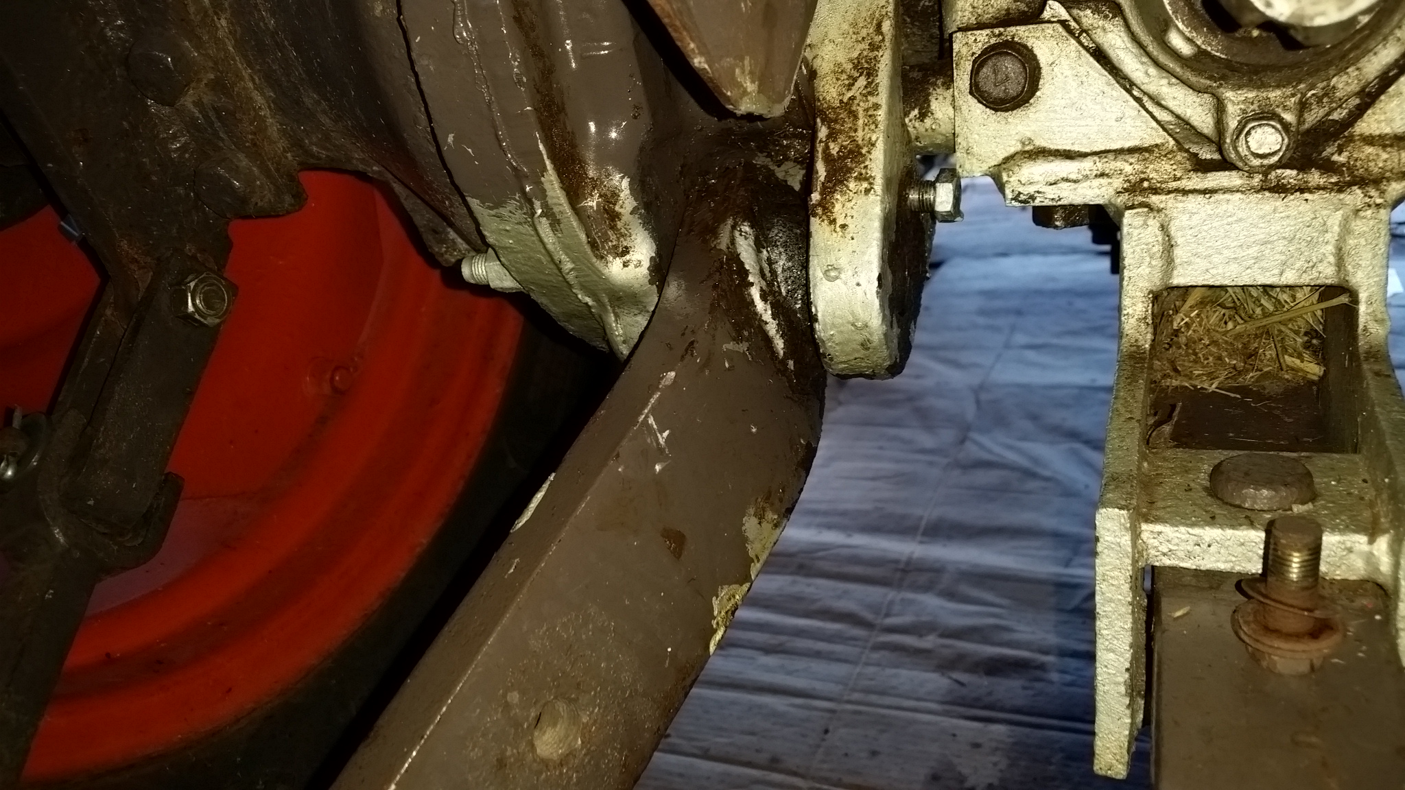

Here are a couple of pics of what I am fighting to remove. The balls inside of my 3 point arms are rusted and are very loose in the arms

With the bolt out, try welding a lever to the end of the pin. After it cools use some PB Blaster and some heat on the iron around the pin. If it won't lossen, may need to take off the brake housing and drive it out from the inside?

Yep. Kubota dealer confirmed its a blind hole and does not extend into brake case. Said they would probably have to cut it off with a torch and then burn the remainder of pin out of blind hole in brake case. I tried some heat not red hot and nothing. Tried Freeze Off penetrator and nothing. Been soaking with pb blaster for 3 days and not budging. It appears the ball is froze onto the pin, cause the arm moves freely, is wallowed out and the ball does not move. I'm stumped?
/ L3710 Removing lower arms #7
Will the ball slide side to side on the pin at all, if not try heating the ball a bit and then tapping on the arm to get the ball to slide. Once you get it loose then you can work on getting the pin free, take the bolt out and try tapping on the pin ear and see if you can get it to rotate in the bore, if so it should start to loosen up. Just go slow and easy so you don't take a chance on breaking the case.

The factory pin has an ear with a hole that allows the pin to be secured to the case with that bolt shown in your photos, as bumpkin says. The pin itself is not threaded and simply slides into the two holes. It looks to me from your pictures as if the ear is no longer on the pin or the original was lost and a simple straight pin was used to replace it. If that's true, there may be more than just corrosion holding it in place; someone may have welded the thing. Here are the part numbers for the pins and that bolt, if and when you can get the old ones out of there:

Thanks for all of your help with this project. I used an angle grinder to cut the arm and get it off of the ball and pin. Then I bought kroil online and soaked the pin and ball several days and then put a pipe wrench on the ball and got it to start twisting but not enough to remove it. So I then cut the pin, carefully with the grinder and finally got it all out. The part that was in the blind hole came out much easier than the part of the pin near the Pto.
The pin is narrow on the blind hole side and thicker where the bolt attaches it to the tractor.
Luckily I was able to remove everything without damaging the housing.
