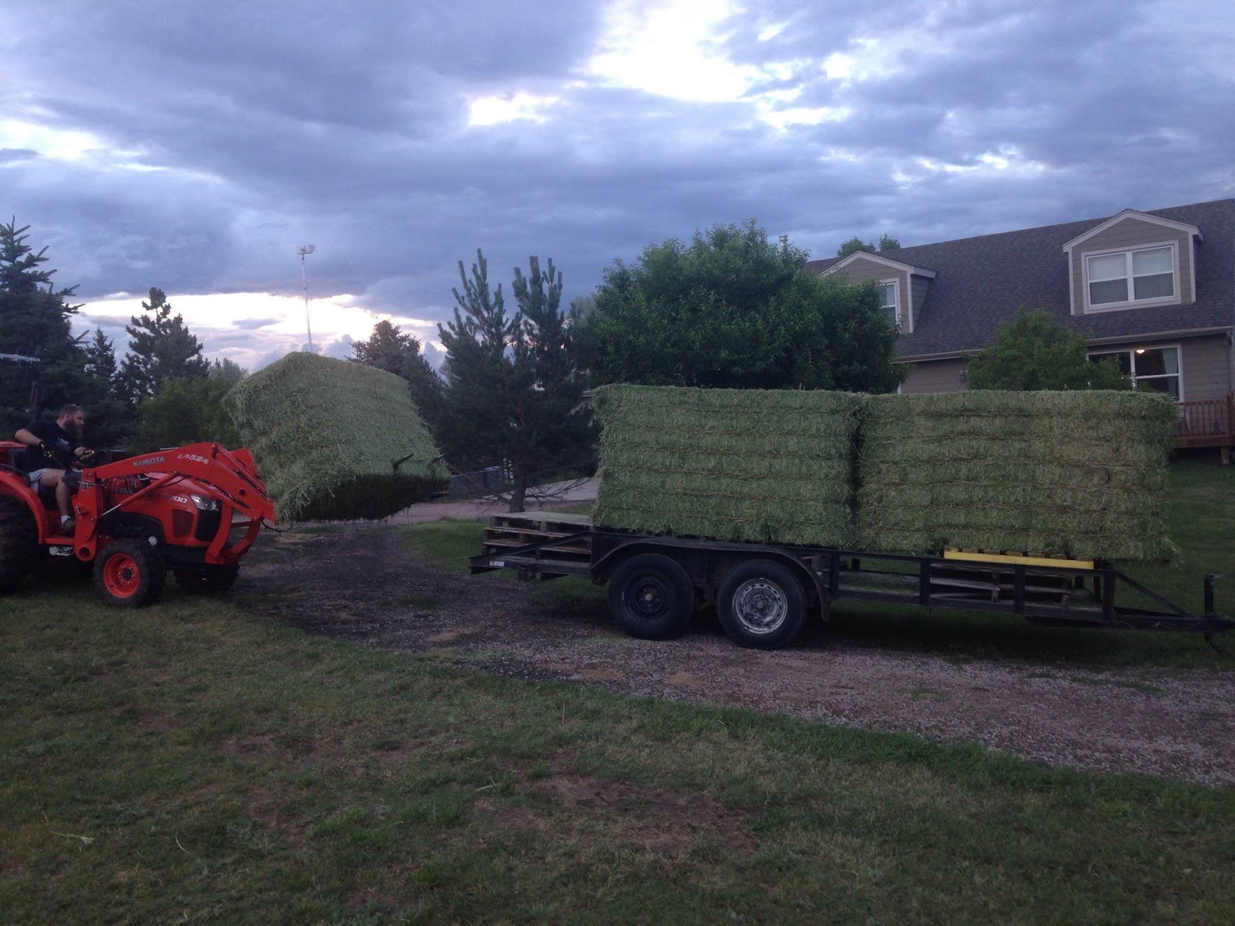

I've got a L3200 & am thinking about upgrading to a premium cabbed machine.
There is a 2015 L3560 100ish hours with a LA555 loader machine & about 4 implements nearby for under $30k.
I was getting a bit interested until I realized you can fit the LA555 or the LA
The lift at the pins on my L3200/LA524 is 1131lbs & the LA555 is only 1190. So basically not any better. The LA805 is rated for 1720lbs. I could use the extra lift as I find my L3200 a hair lacking for some stuff. Recently helping a friend/neighbor get rid of some large square bales & can only lift em about 3' reliably.
Any thoughts? Will I likely end up regretting ending up with a LA555 instead of a LA805? Anybody have either & able to comment?

I'm upgrading to a cab & bells & whistles, not really in HP. I'm generally happy with the 3000 frame size, although I have thought about a 4000 occasionally. I occasionally regret getting a L3200 instead of the extra 5hp on the otherwise same L3800 for an extra $2k. But not very often. Mostly when roading & tilling, the rest is terrain or traction limited.
When I refer to my L3200 not quite being enough I'm talking about lifting some large square bales & if I can lift them, the hydraulics stop lifting at around 3'. A few hundred lbs more of capacity would sort that issue. I have a pressure gauge & my relief is properly set at the upper limit of the specs. So, no I don't know what my real world lift capacity is in lbs for sure, but it should be in spec. And with my 5' rotary cutter on as ballast & loaded rears I know I'm a hair from being ballast & stability limited on loader capacity if I cranked up the pressure beyond spec.
If they made a L3x60 frame machine at 40hp or so I'd be all over that, but Kubota doesn't. I can live with it slowing down on hills when I road it, or go a hair slower doing heavy brush mowing.
My main question is on the smaller loader on what sounds like a pretty decent deal for a L3560 & some implements.
Not quite ready to upgrade, but could make it happen if I really liked the machine & got a good deal on it. Not afraid of selling off some of the duplicate implements & my L3200.

Ya, pretty hefty bales. Alledgedly they are suppose to be 1,200lbs bales. At least as wide as my tractor, so 5' or 6' wide. My 5' rotary cutter & loaded rear tires were barely able to keep the rears on the ground. Depending on the bale I really couldn't lift them any higher that what is seen in the photo. A few I had to bounce the go pedal a bit so the loader would bounce a hair & raise on the up stroke of the bounce so I could get em high enough to put on the trailer. 3 more getting delivered this weekend then 6-8 left before he's out & we reclaim the barn. No more hay for them now that their goats are gone.

If you have an option, I'd buy the la805 loader no questions asked.Kubota does offer the QA loader standard on the LA555 which is nice. Going from the LA524 on my last tractor to the LA805 is a very large noticeable difference. Especially when moving large round bales.

What is your altitude in Parker, Colorado? My L3560, open station, has plenty of power for me at sea level. But if you add a cab +AC, and your altitude is over 7,000 feet, you may find it underpowered.
I have the LA805 with optional SSQA L2296 Heavy-Duty, Round-Back bucket. Great combination on which to mount a made-in-Wheat-Ridge-Colorado Bucket Solutions Bucket Spade.
LINK: Tractor and Skidsteer bucket spade shovel
My L3560 tractor-loader is 5,400 pounds, with R4 tires, filled with air.

I paid $27,500 new for my L3560 with LA805, L2296 HD, RB Bucket, Draft Control, open station, in 2013. Of course the one you are inspecting has a cab and presumably air conditioning. (No sales tax on ag tractors in Florida.)
