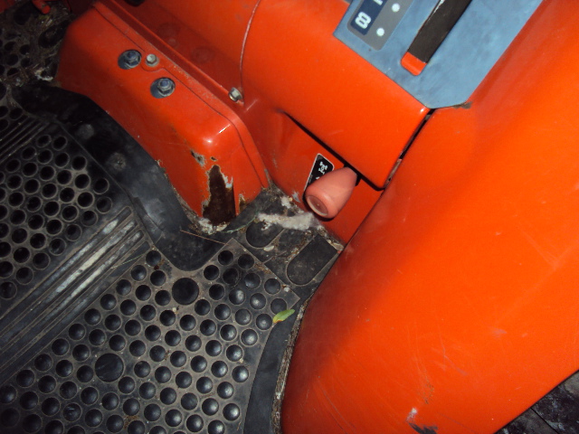

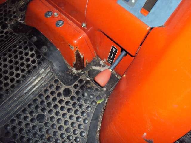

Rented an L35 for the weekend. Not sure how to get it in 4WD. Rental place is closed. Small yellow short shifter directly below steering wheel?
Help is appreciated--Thanks--Has been painted and alot of the info stickers are gone as is the manual.

Steve,
I have an L35 and that is what turns on the PTO.
The lever for engaging/disengaging the 4 wheel drive is down below your seat and to your left, as you're looking down. It is engaged when the knob is almost touching the sheet metal and disengaged when the knob is out, towards front of tractor by a few inches.
/ L35 Rental engaging 4WD #5
Here are some photos:
Left: 4WD is Engaged
Middle: Disengaged
Right: PTO Lever
These pictures were taken from Step Side of tractor, looking back to rear of tractor.
Hope this helps :thumbsup:

Ok! First thanks to everyone who replied. I see the lever on the left of the seat. The knob is gone but that is doing it:thumbsup: Thanks all. Yes I was activating the PTO which wasn't it. Fortunately I had a little back hoe work and I will do the bucket / brush work in the morning. Thanks to all the L35 owners for answering so quickly and yes the pics help too.
