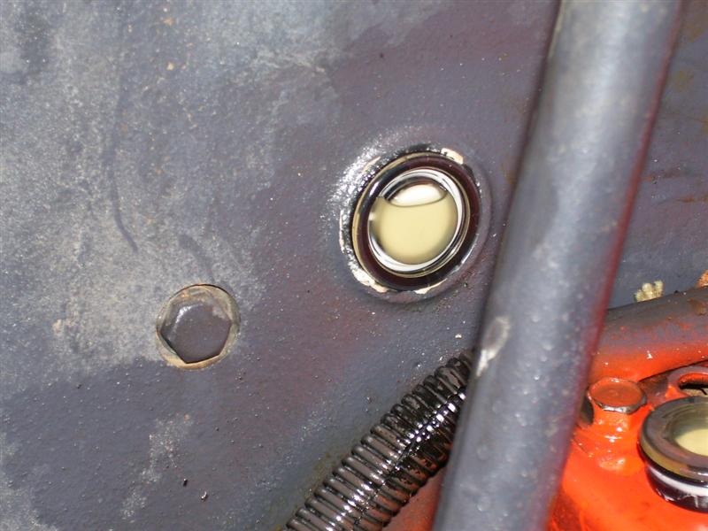

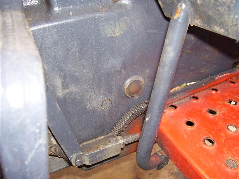

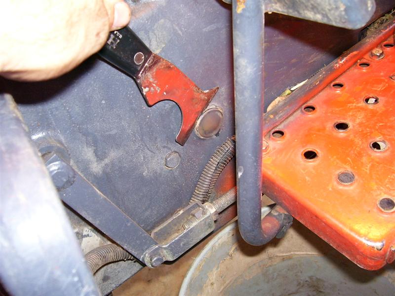

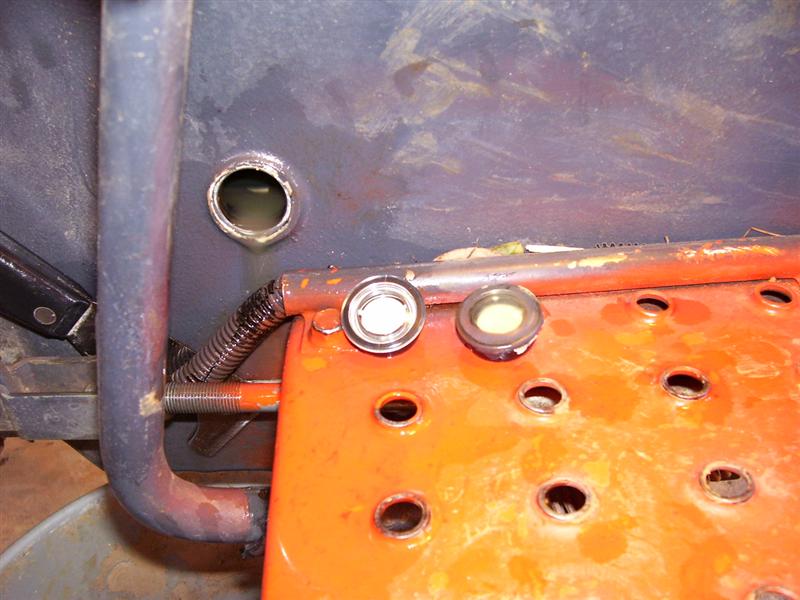

All you had to do is put a little sealer on it. I replaced mine because it was scratched up. No threads, I added a little black RTV sealer.
So spend a minute on some sealer and you will save more minutes by just looking at the site glass!! :D

In my case the plastic cap was actually cracked into two pieces. The outside plug had only one thread left and was barely hanging there. the rest of it came out easy.
