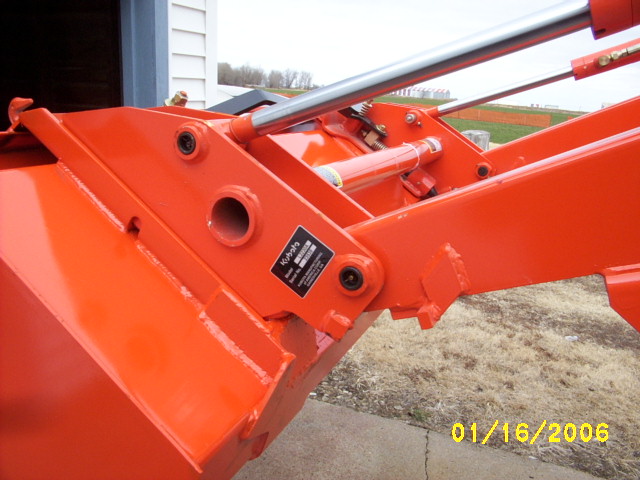

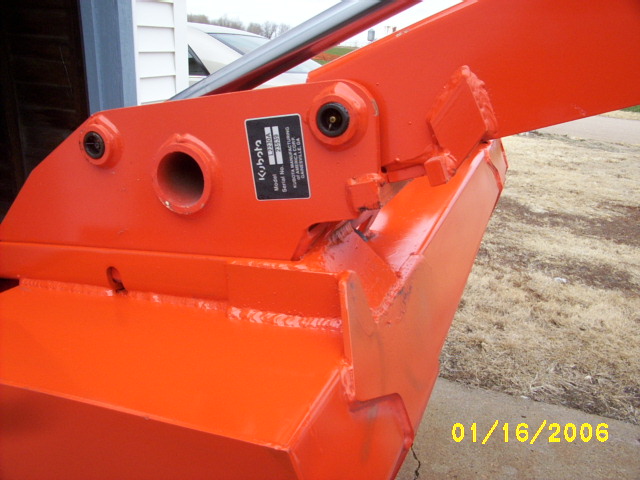

And I must add: Nice job, nice job posting and good photography!
