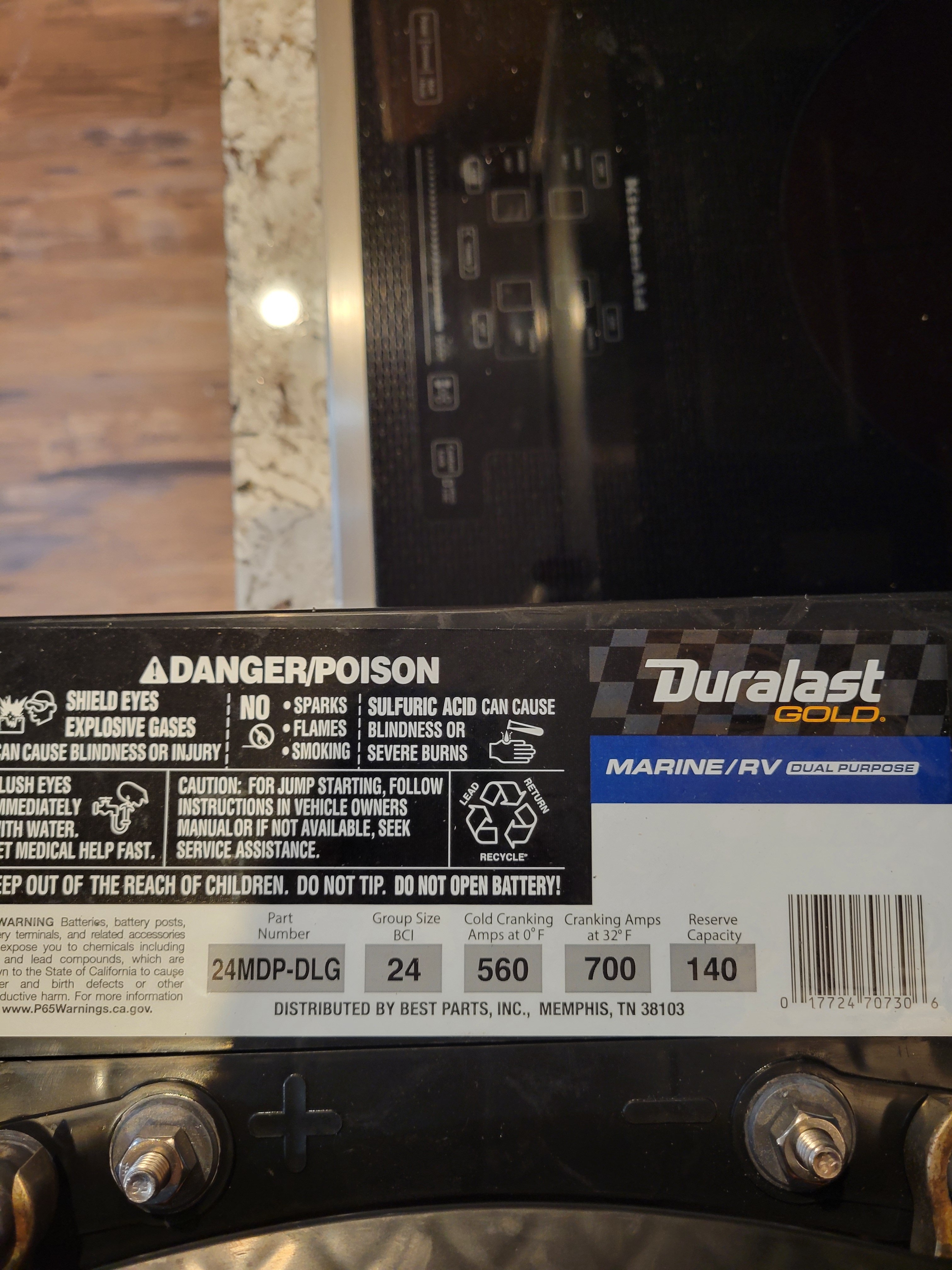

Works great in my 10-year-old, manual L 3400.
   / L3400 Battery size #19
Works great in my 10-year-old manual, L 3400
