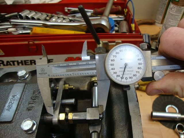

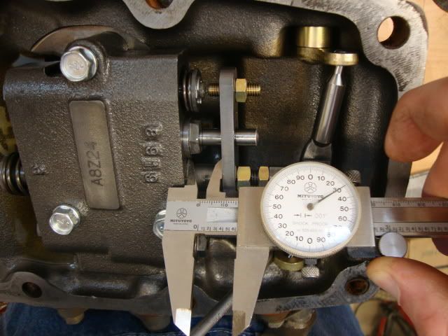

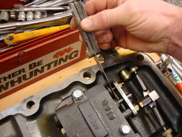

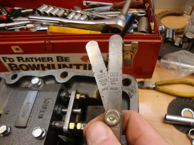

Ok, I made some initial measurements this morning and the adjustments are definitely not in line with the data I have.
A little bird (or three) told me what the dimensions should be for three of the measurements you use during set-up.
This should be 47.5 mm (1.87"). Mine is set at 48.5 mm (1.91"). I'm not so concerned about this one just yet, since I think it sets the valve position in relation to the control lever and the feedback rod. There is mention made that if you change this, be sure to also adjust the feedback rod.
This should be 16 mm (0.630"). You set it at that position by moving the control lever or rod to get a 16 mm measurement, then hold it there while you check another measurement. In effect, the instructions would read, "While maintaining a dimension of 16 mm in location "X", dimension "Y" should be "Z" mm.
I stuck a screwdriver under the feedback link to hold it in place and rotated the control rod to give me 16 mm (0.630")
This is where it gets interesting. The dimension here should be 0.1-0.2 mm (0.004-0.008") with a 16mm (0.630") gap between the plate and valve body. Mine measured 1.14 mm (0.045")... almost 10 times what it should be.
I guess you know I'm about to make some changes and see what happens.
Sean

...almost 10 times what it should be...
Sean, excellent job, hoping for the best. :thumbsup::thumbsup::thumbsup:
10 friggin' times! Holy Cow... Isn't one of the first things that you read in the Hydraulic Section says:
"IMPORTANT, Set screws and spool joints 1 are adjusted to VERY CLOSE ACCURACY." Is this kubota's best quality? ...and then to say that there is not a problem with their hitches?
