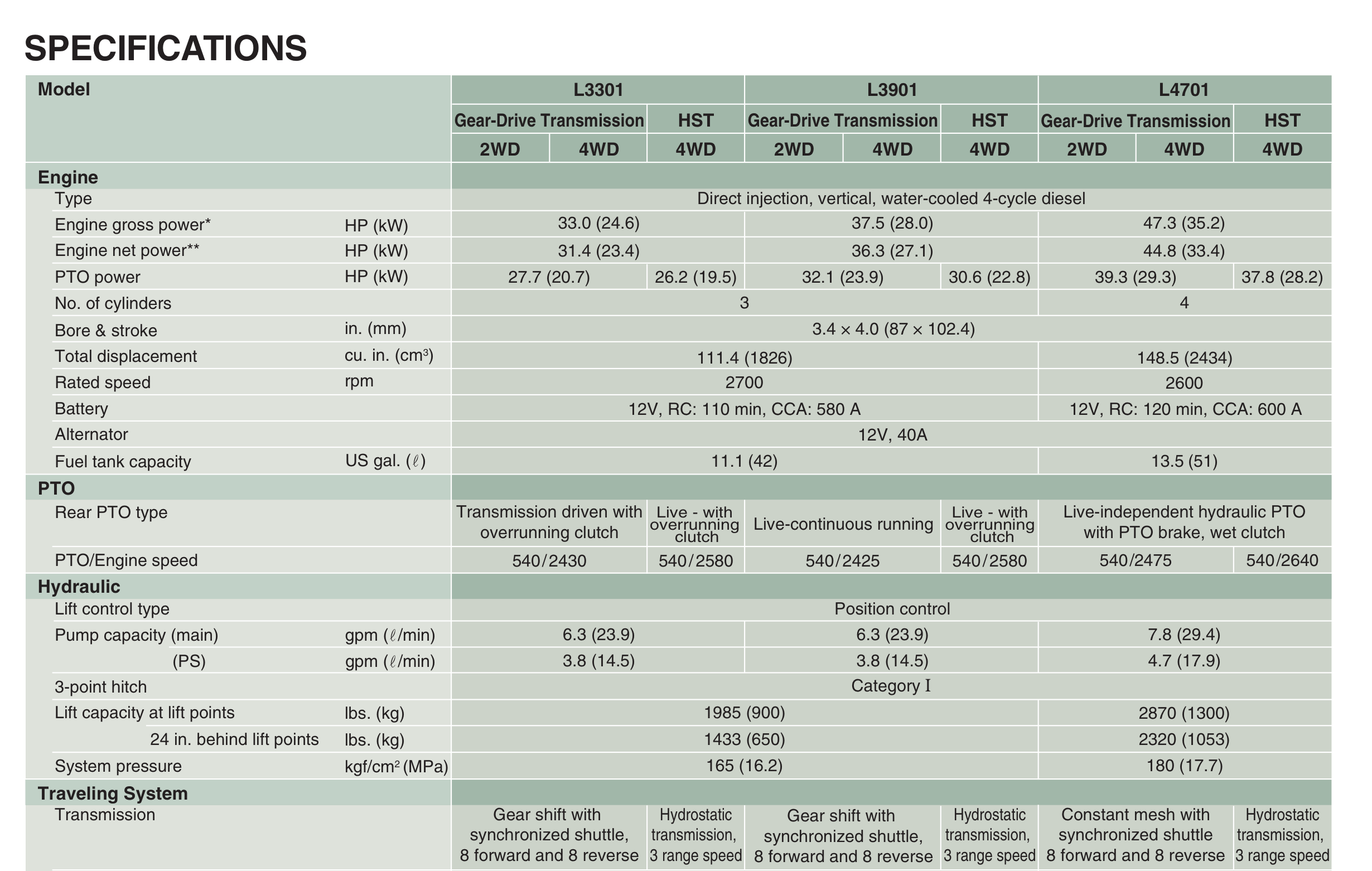

I went to the dealer yesterday and looked at the L series and the LX series.
The gear drive does indeed NOT have a live PTO. Could be a problem tilling and coming to a complete stop.
The HST has independent PTO. Makes more sense to me.
LX is just a little smaller, and has the mid PTO which will suit me better in the long run for a mower. Looks like the LX2610HSD would be a good fit for me. Since I need a tiller, loader +QA bucket, QA snow blade +left/right, and mower, cost is adding up quickly.
Our property hasn’t been plowed in the last 20 years according to aerial photos I could find. So this is stubborn ground. NE Ohio. I will charge the tires so the LX2610HSD with loader, bucket, tiller, and me would be about 3200 pounds. Guessing a BX is about 2400 and the L 4200.
I’m sure the LX3301HSD would be even better, but aside from the regen concerns, … my biggest fear is not having enough power. But I don’t want to buy too much. Upcharge is $4800.
Can I manage “forward tractor speed for tilling” by just going slower with the HST? That must be what you guys were talking about “creeper speeds” , mph, etc.
Can I also get some opinions on forward rotary tillers or reversing? Hoping for a decent sized garden in 2023 after all the heavy yard work is done.

Gear drive 3301 doesn't have a live PTO. That's the only reason that I bought a hydro.
3 years later I STILL stall it more often doing loader work than I ever did with my geared L275.
I had to check that in the spec sheet online, but right you are. Good catch!
The gear transmission is has an additional F & R shuttle lever which IMHO makes it much preferable over a traditional gear and clutch type. That's a nice transmission on the L3301.
But I thought transmission-driven PTOs were a thing of the past. That's a deal breaker for some people. I've use transmission driven PTOs, but it was years ago.
You can use the PTO while sitting still in neutral in a transmission driven PTO, but then you have to clutch to shift into gear and the PTO is unpowered at that point. So the implement slows down or stops until you pick up speed. A transmission PTO is downright archaic compared with a live, independent PTO.
