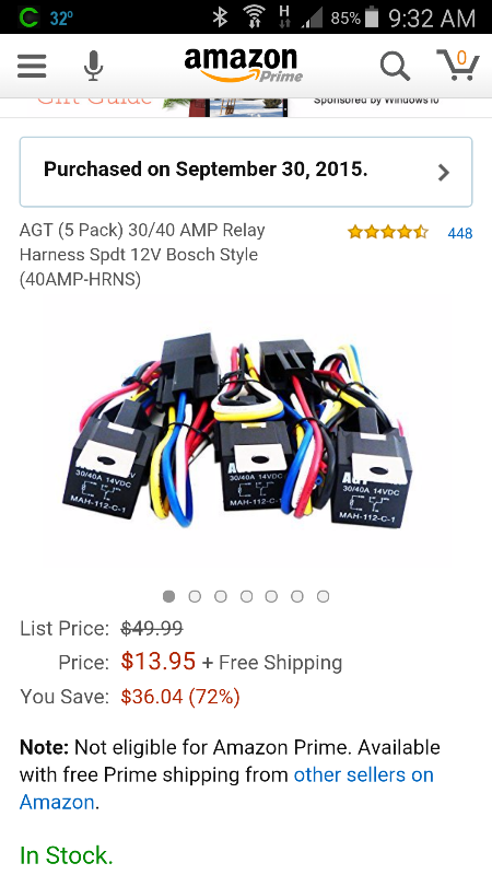

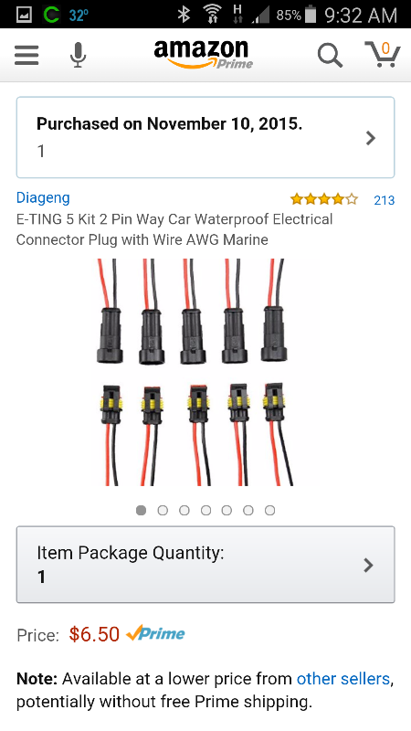

It was around $6 to ship it. If anyone uses this be aware that the switches in this are only rated for 0.1 amps and the solenoid valve pulls around 3 to 3.5 amps. I had to solder new switches in finding out the hard way. I just used some automotive type relays and sockets I sourced from amazon. The relays actually pull more than the switch is rated for but I haven't had an issue as of yet. The relays seem to pull around 0.15 amps to engage them. I tested them all and installed the lowest of the bunch.
