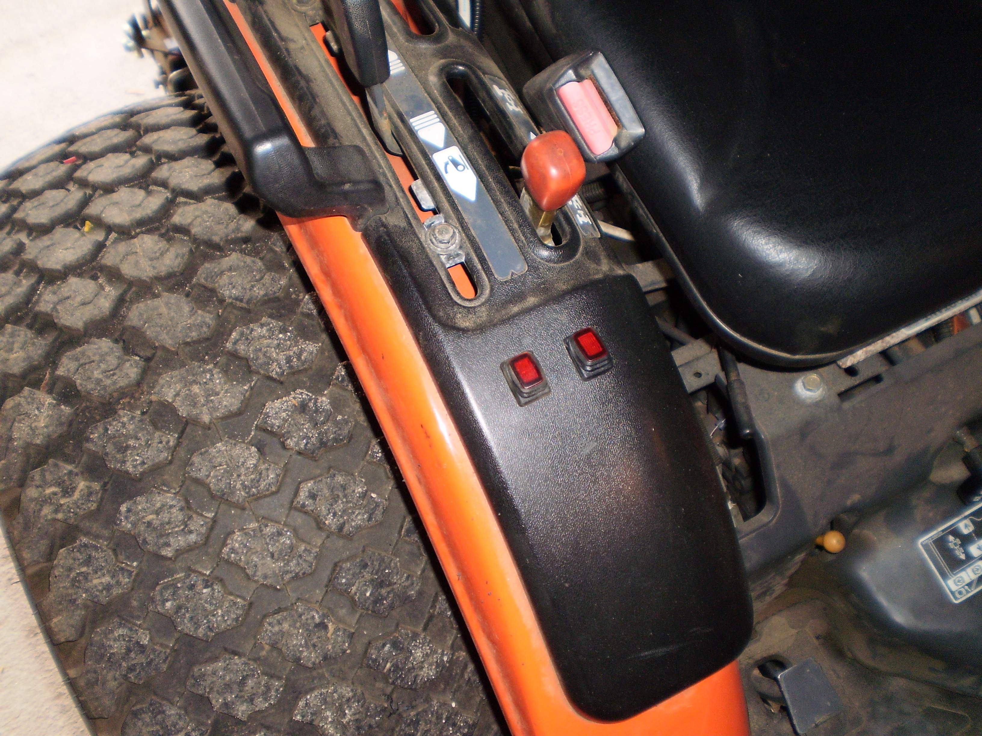

I installed a pair of weather proof in the fender... B7510, not sure if it would work for your application

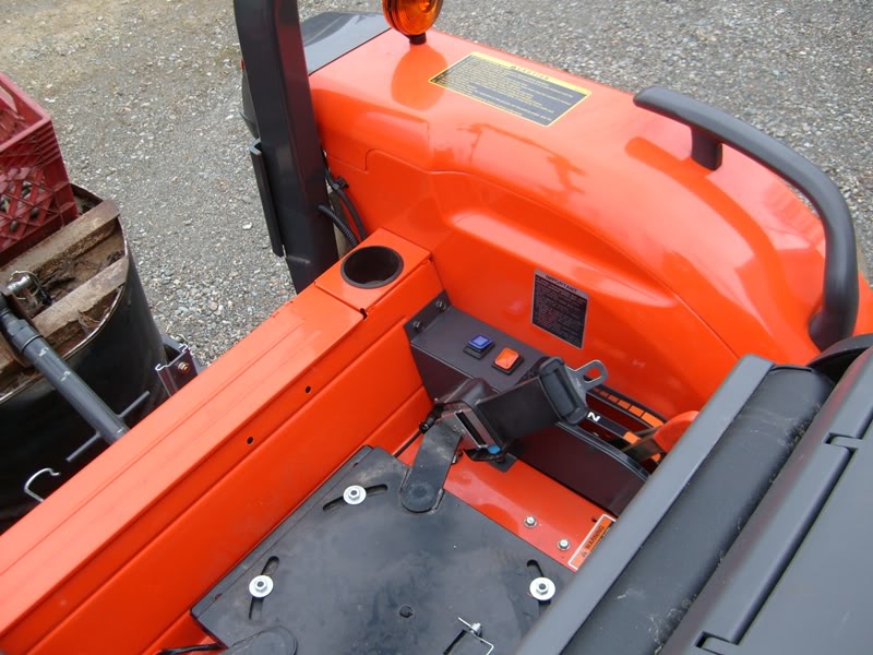

I installed my switch on the bracket for the Range Selector. I just used a small toggle switch. I ran the power from underneath the left (sitting on tractor) fender out of the factory switched pigtail. Took probably 10 minutes to have it operating and installed. Look close at the pic attached and you can see where the switch was installed.

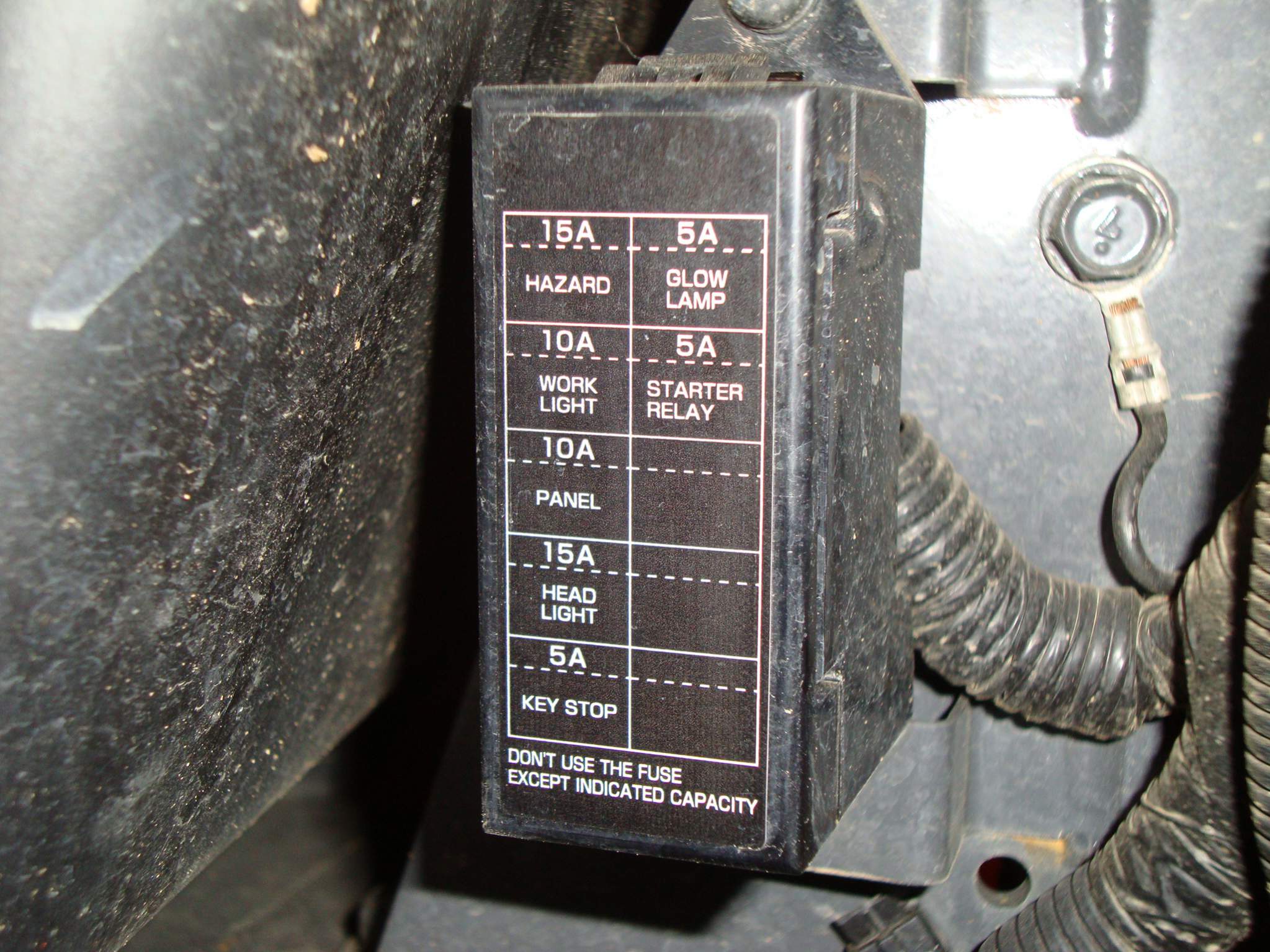

The connections under the fenders run to the fuse block, on the L3400 I have there is a 10A fuse that's labelled "work light". I broke into the wire that runs to that fuse and put a weatherproof switch to the left of the steering column for my work light. Easy to do since the wire runs past that area anyway.

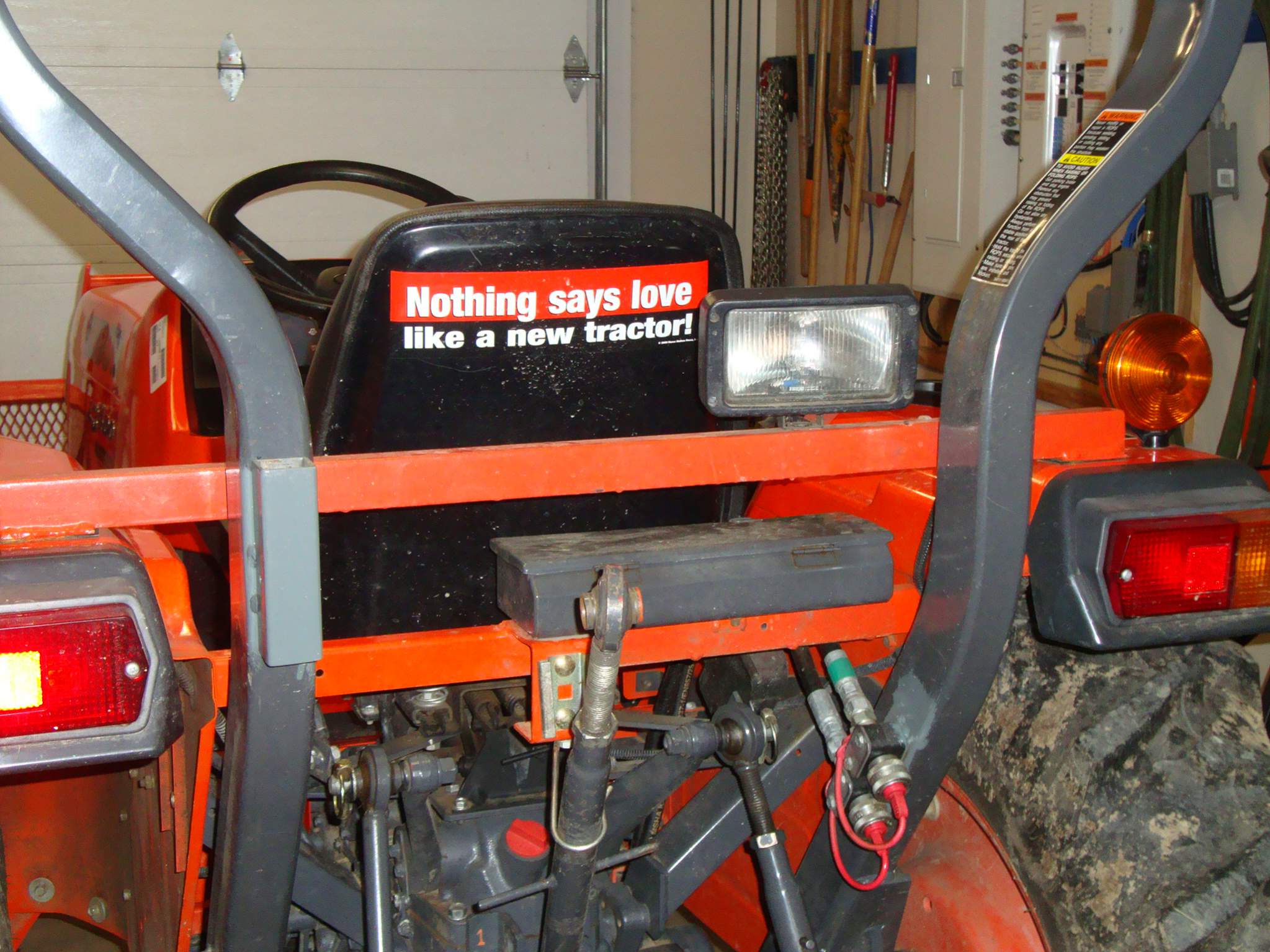

I used a 55w halogen light mounted on a cross bar between the fenders, I use the tractor around trees a fair bit and didn't want the light getting broken by branches if I mounted it on the ROPS.

Not sure if the 3200 has the same metal panel over the H-M-L lever as the GLs have but I mounted my switches right behind the lever.
