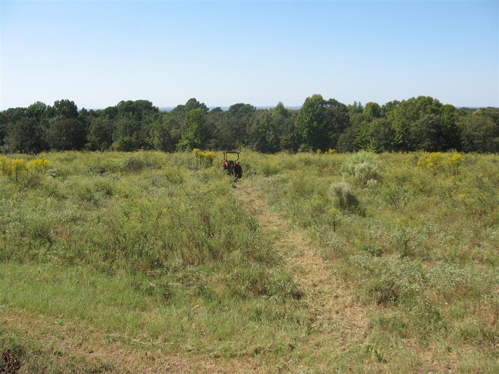

Your needs are like mine. Gear tractor is fine and a lot simpler to if it ever breaks. Surprizing to many, my tractor is very useful without a FEL or BH. I could use a bigger BH if I keep doing this...(that's a 4' bh) :D
I bought my L2500 off ebay for $5000, 4' BH and 5' Woods FM came with it. It's a 1999 model with 1200 hours, used in a lawn business. Comming up on 3 years.
