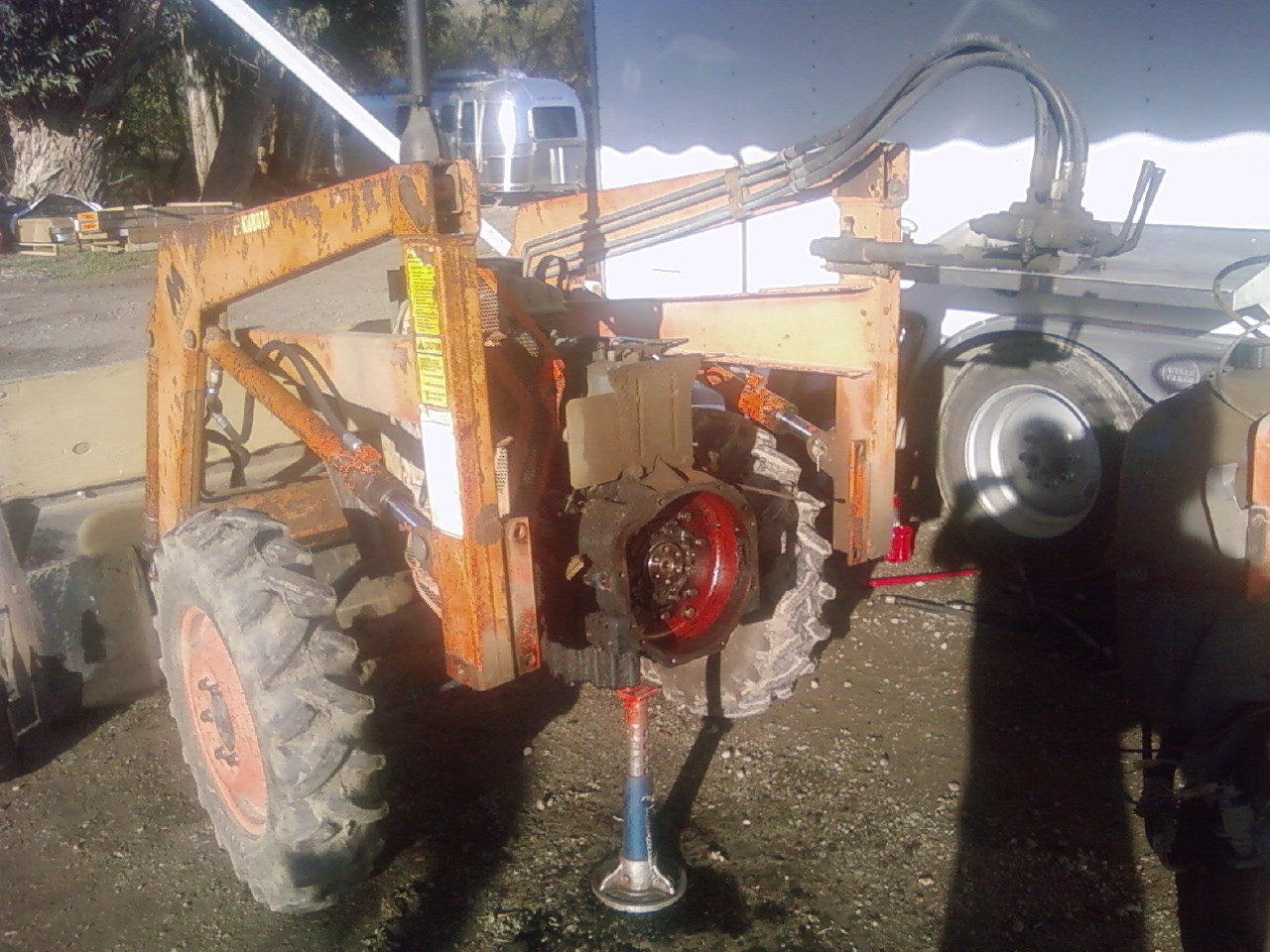

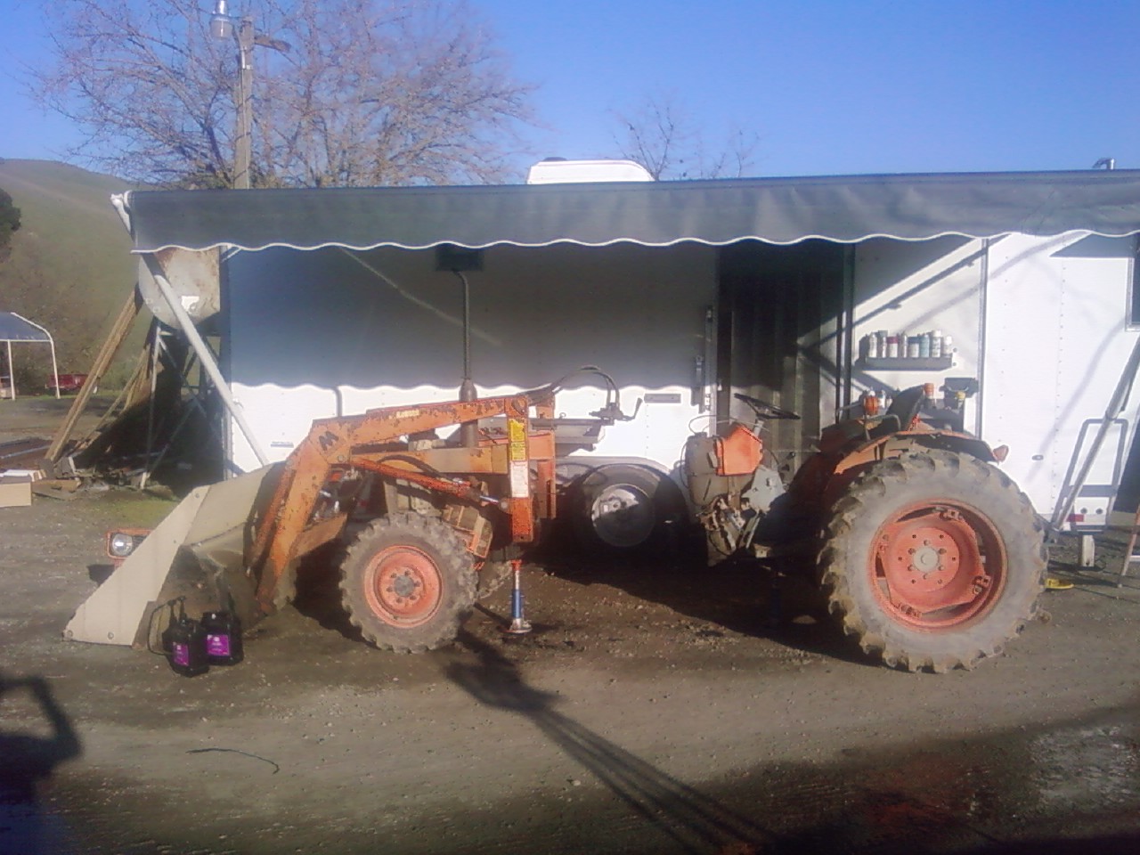

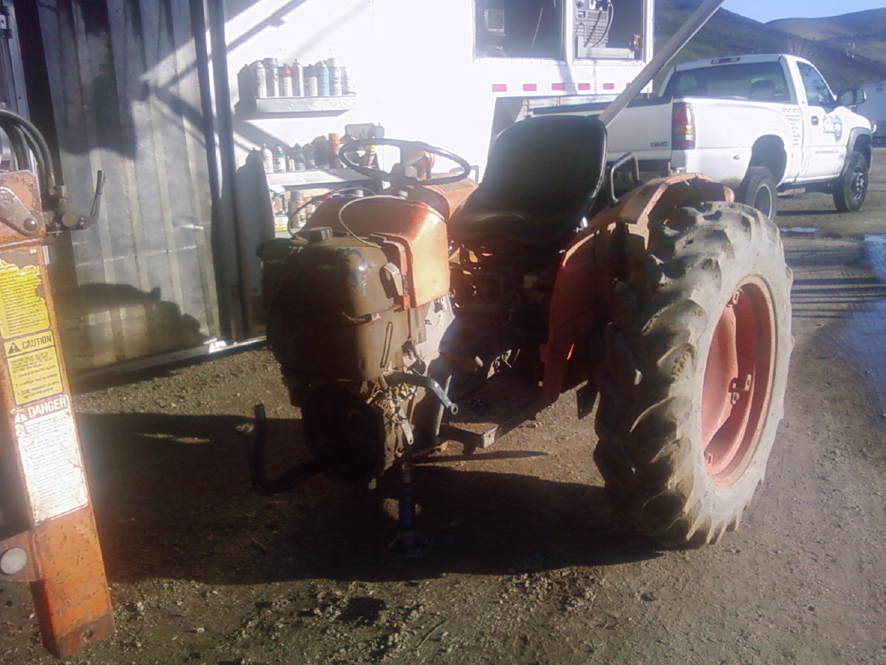

This is a tractor I started working on yesterday for a customer of mine. I'm replacing the clutch, I repacked all of the loader cylinders, will be replacing all of the hydraulic hoses, and putting new o-rings in the loader valve. It's getting a new seat, exhaust pipe, drag link and tie-rod ends, the left hand bevel case seals, all of the fluids changed, the decomp wire, hourmeter cable, and high-speed reverse lock-out cable. It should be about 20 hours work by the time I'm all done.

Are you replacing both clutch disks or just the travel clutch?
That's a big list - and a lot of work- it would take me way more than 20 hours (I'm slow). :eek:

Just the drive clutch and the drive plate, the PTO is seldom used. I will replace both belleville spring though. I should be finished today. All I have left to do is reinstall the clutch, push the machine back together, replace the o-rings in the loader valve, and replace those cables that I mentioned, plus replace all of the fluids.

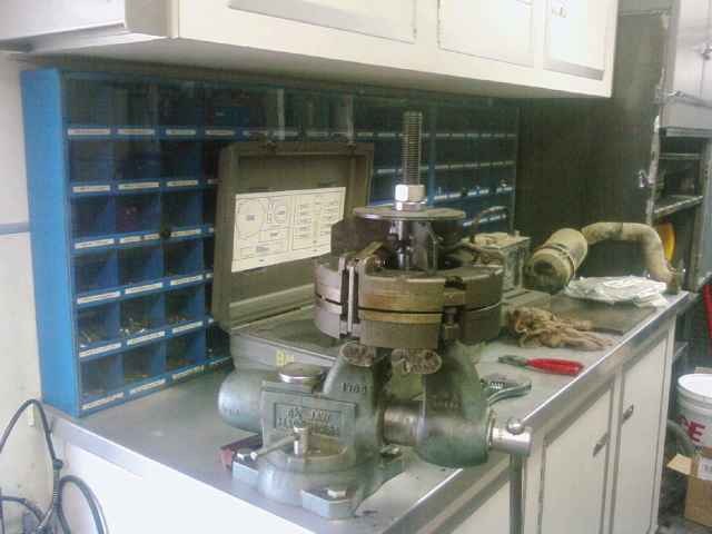

I guess you could do it that way. Personally I'd rather use a wooden dowel with masking tape wrapped around it to the right diameter.
Here is the assembly on the bench mounted in the Kubota tool.
