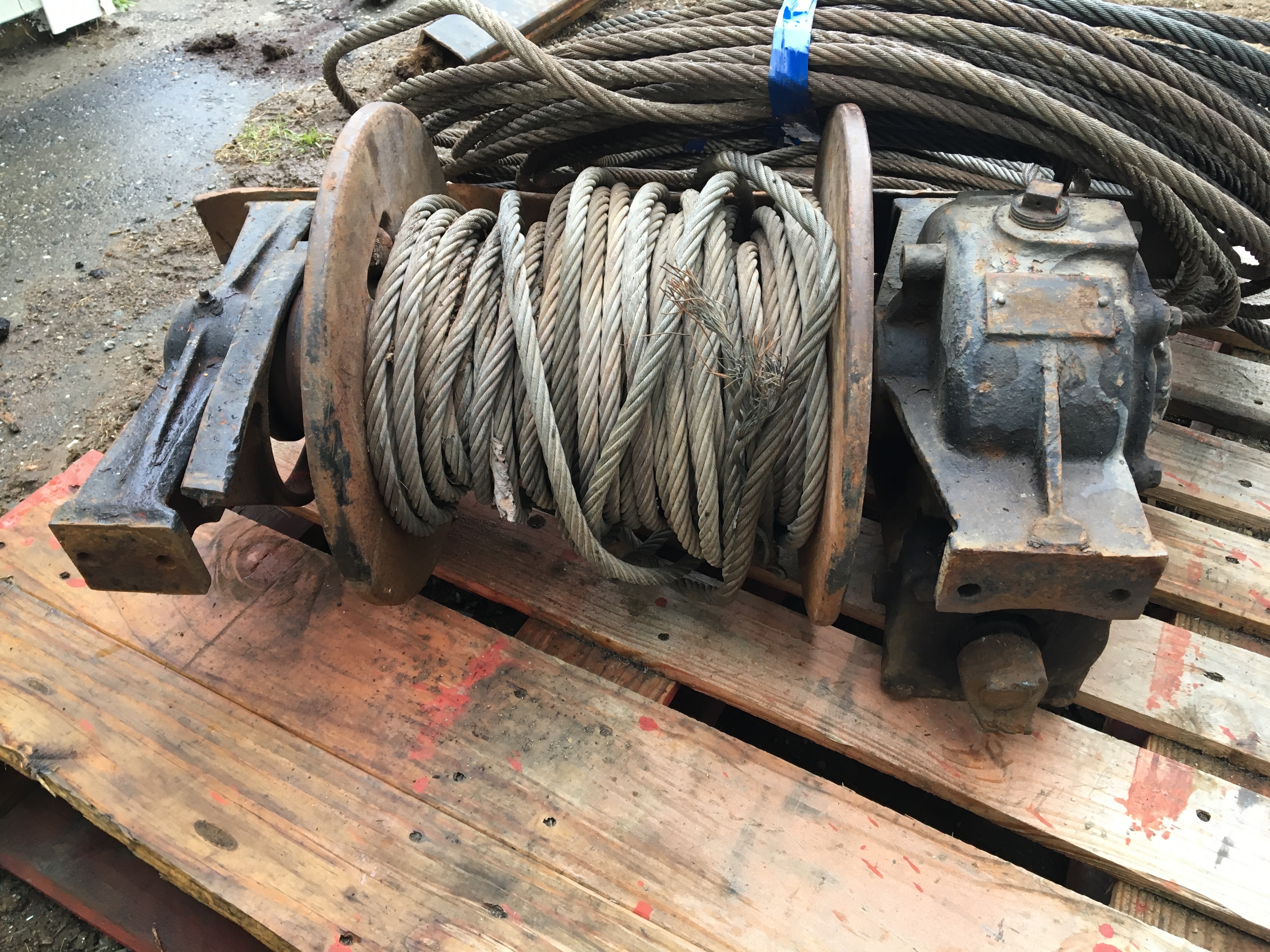

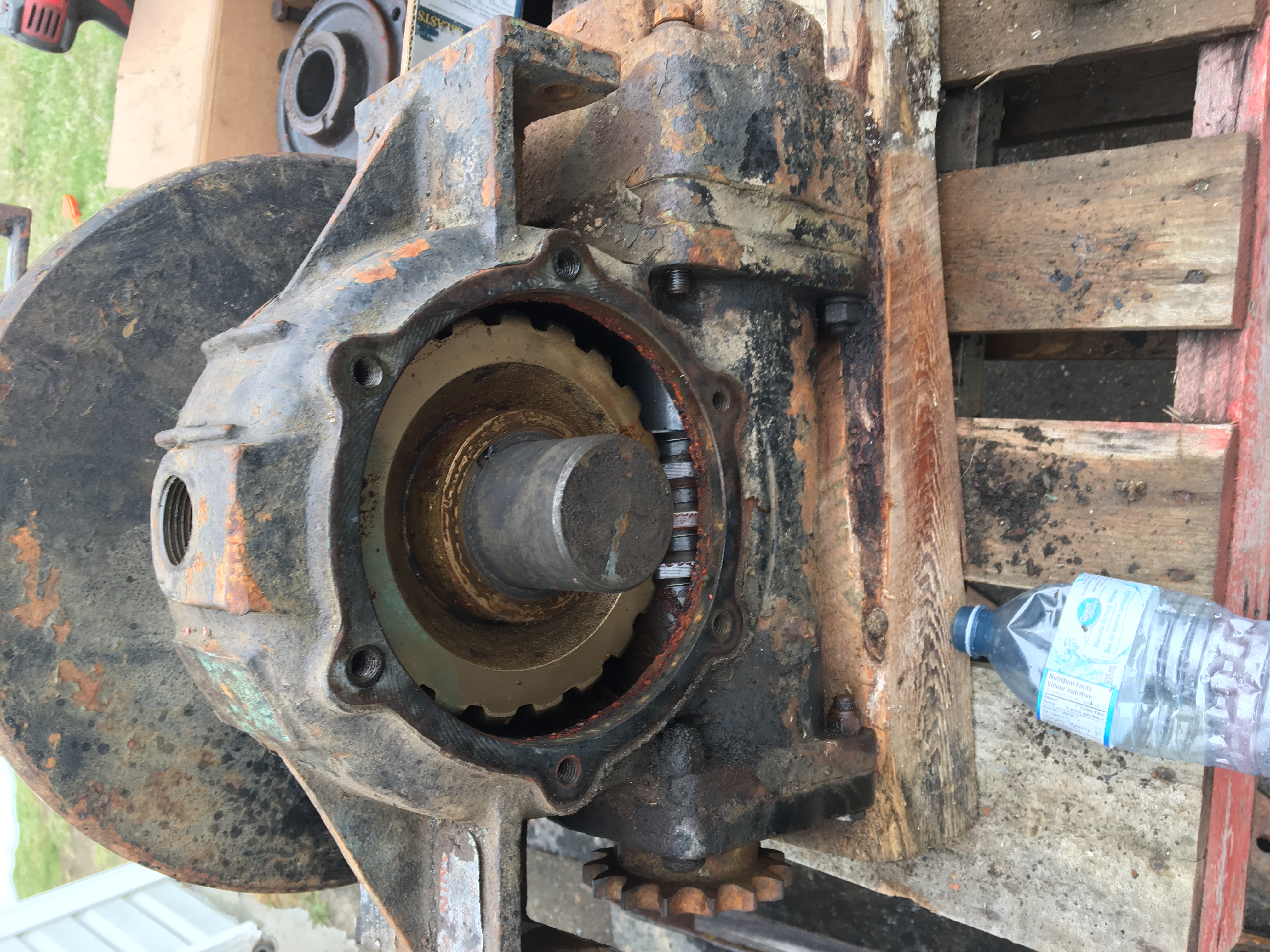

So, i have decided to build a 3pt skidding winch to go with my L2501. After some research i have decided to go hydraulic vs pto. Mainly because with the 20000 lb braden winch i have, there would be no way to release the drum if the log gets stuck or caught in a rock or stump. So i don't have rear remote only a true 3rd function valve to the front which is for a future snow plow. I am thinking that i can feed a hydraulic motor from that valve to run my winch. The winch i have has a 21:1 gear reduction.
My tractor has 5.15 gpm and 3.13 gpm for steering, so my question is does these add up when i'm not using the steering or not?
Do you think my tractor's hydraulics would be capable of running a motor to run the winch?

F5772296-43EC-4C8F-84CF-1841691311B0.jpeg793A2B4D-9343-4CCB-92D0-46FBEA4859B5.jpeg585C7CC7-A438-47BE-91E7-082ACE155E6E.jpeg
   / L2501: Hydraulic Skidding Winch Build #3
Sorry;don't think it will work.PTO powered makes more sense.You don't have anywhere what you need for flow to drive a hydraulic motor.
   / L2501: Hydraulic Skidding Winch Build #4
I don't think the flows would add, they're probably separate. You would get about 5 hp from a motor. You could drive a winch with that, but it would be kind of slow compared to pto driven. 5 hp would pull 6000 lbs 27 feet per minute, assuming the winch was 100% efficient, which it isn't.

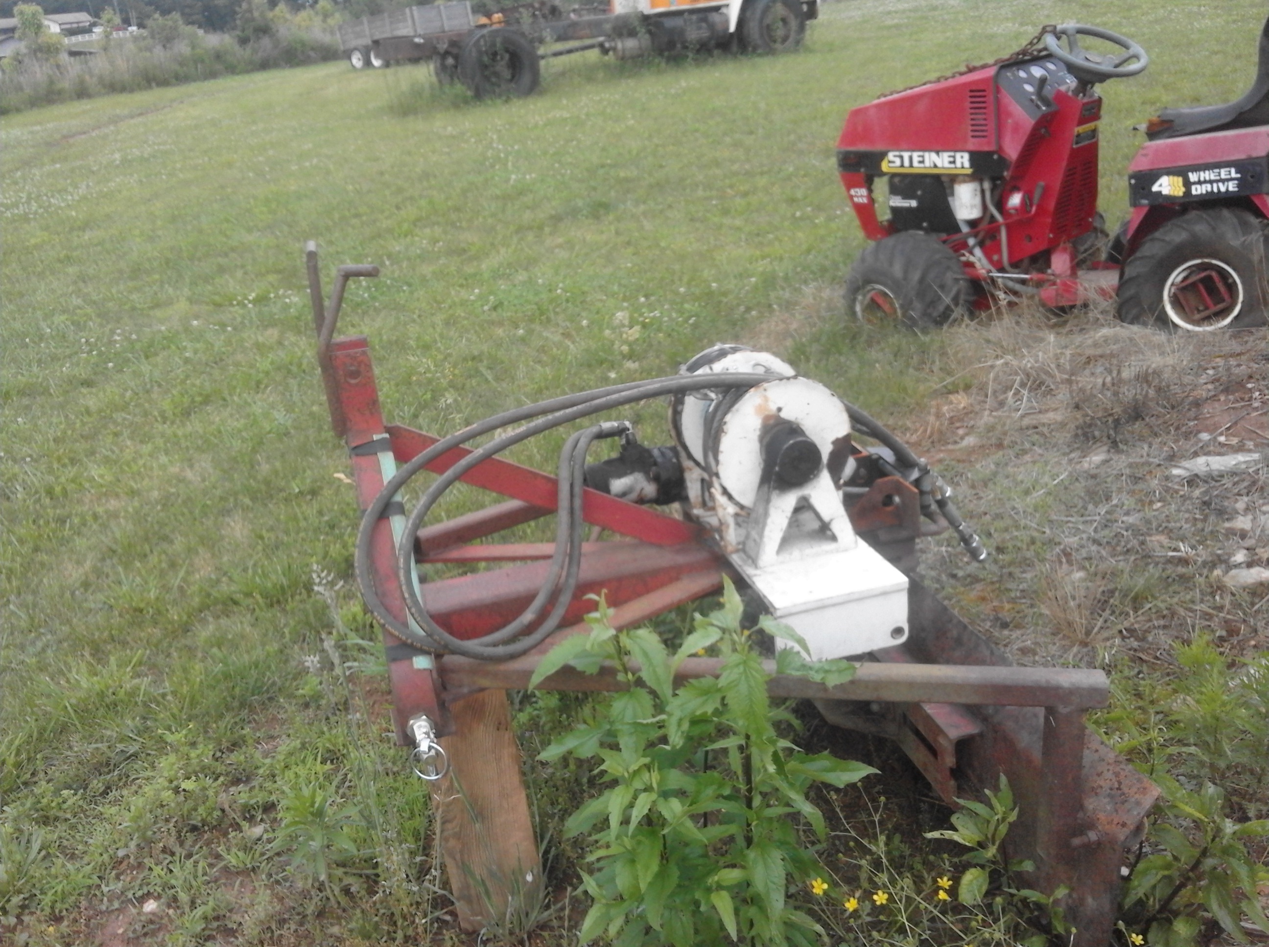

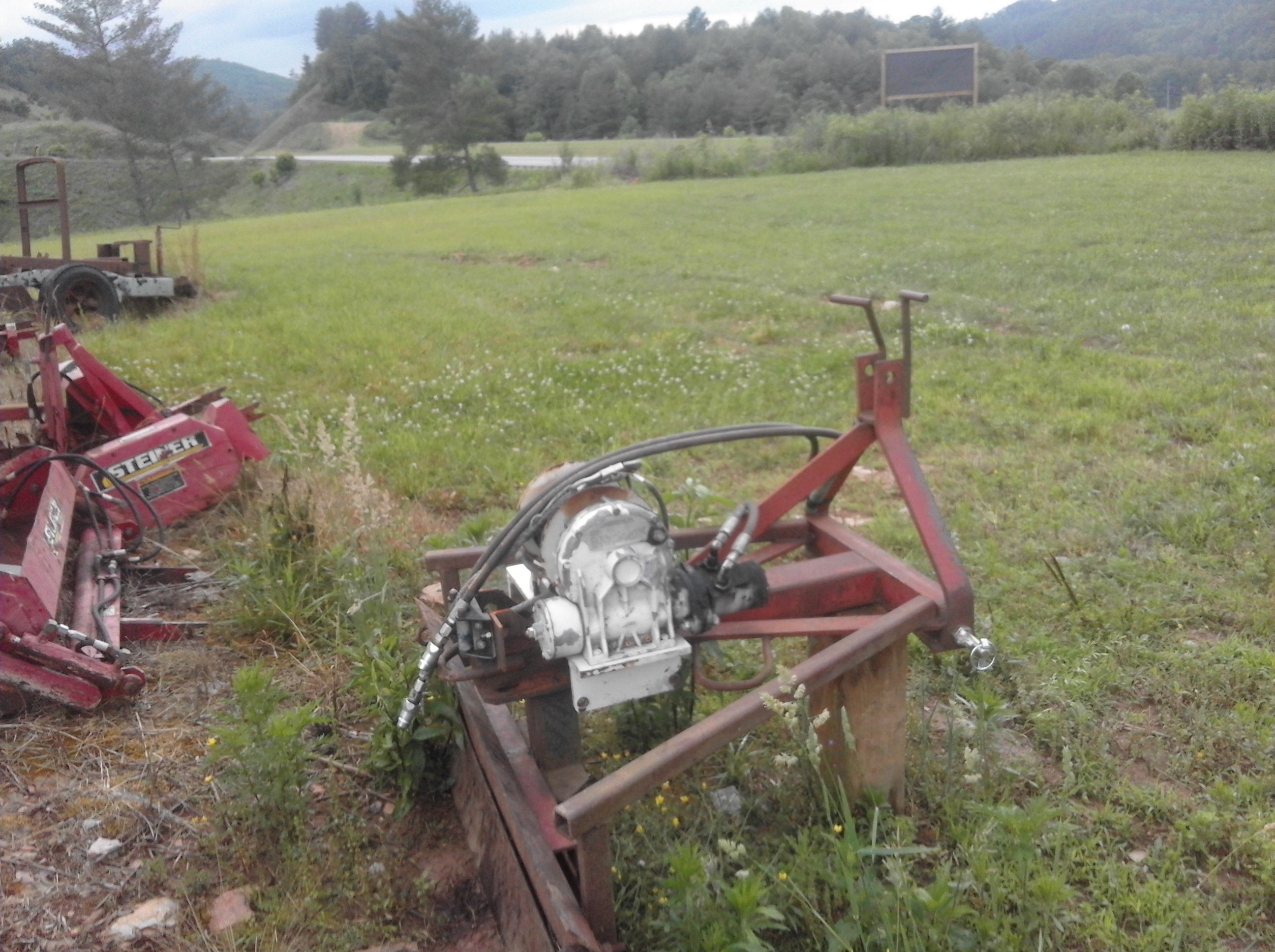

Thought I would post a couple pics of my $16 hyd logging winch.winch 1.jpgwinch 2.jpg
The winch is a 8000lb off a mechanic boom I got in a trade a couple years ago. It came with about 125ft of that blue rope. The 4ft scrape blade I got gave to me. The blade had been turned backwards and welded. I had the hyd hoses and only had to buy the QC's. I spent more time thinking about how to put it together than it took to build it. Just threw the winch on top of the blade and welded in place. The fairlead is a little small, but it came with the winch. I have stalled the winch a couple of times, which is really a good thing. It wont hurt the tractor and didnt break the rope. I have a bigger hyd motor I thought about putting on it to give it a little more grunt, but aint made up my mind about that. I do have to wind the rope off as it is power off/on only, but it winches fast enough for me.
