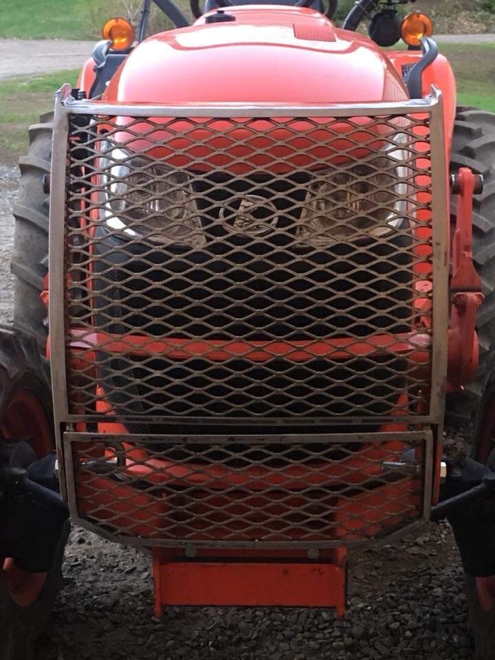

Made mine from 1/8" raised expanded metal.
I tend to go heavy because I do a lot of tree and brush work.
/ L2501 grill guard question #4
Mine is a lot like wagne223. It's split near the bottom to allow the grill to fold forward.

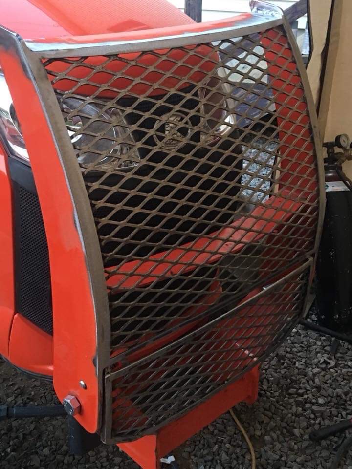

Mine ain't a 'bota but this one is 1/8" plate :) I've smacked it with a couple good ones at least 4" in diameter and held up fine.

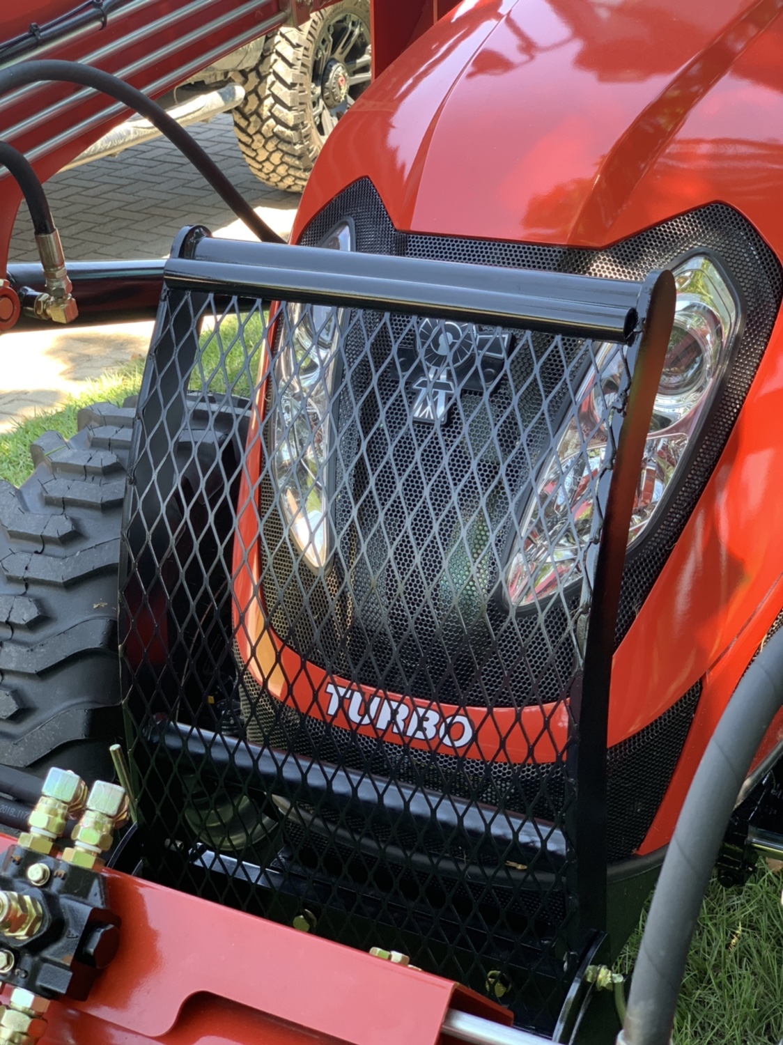

I put some flat 3/4 expanded metal on my l3901 grill guard and contoured the top to match the cross bar radius. So far it’s held up really well.
