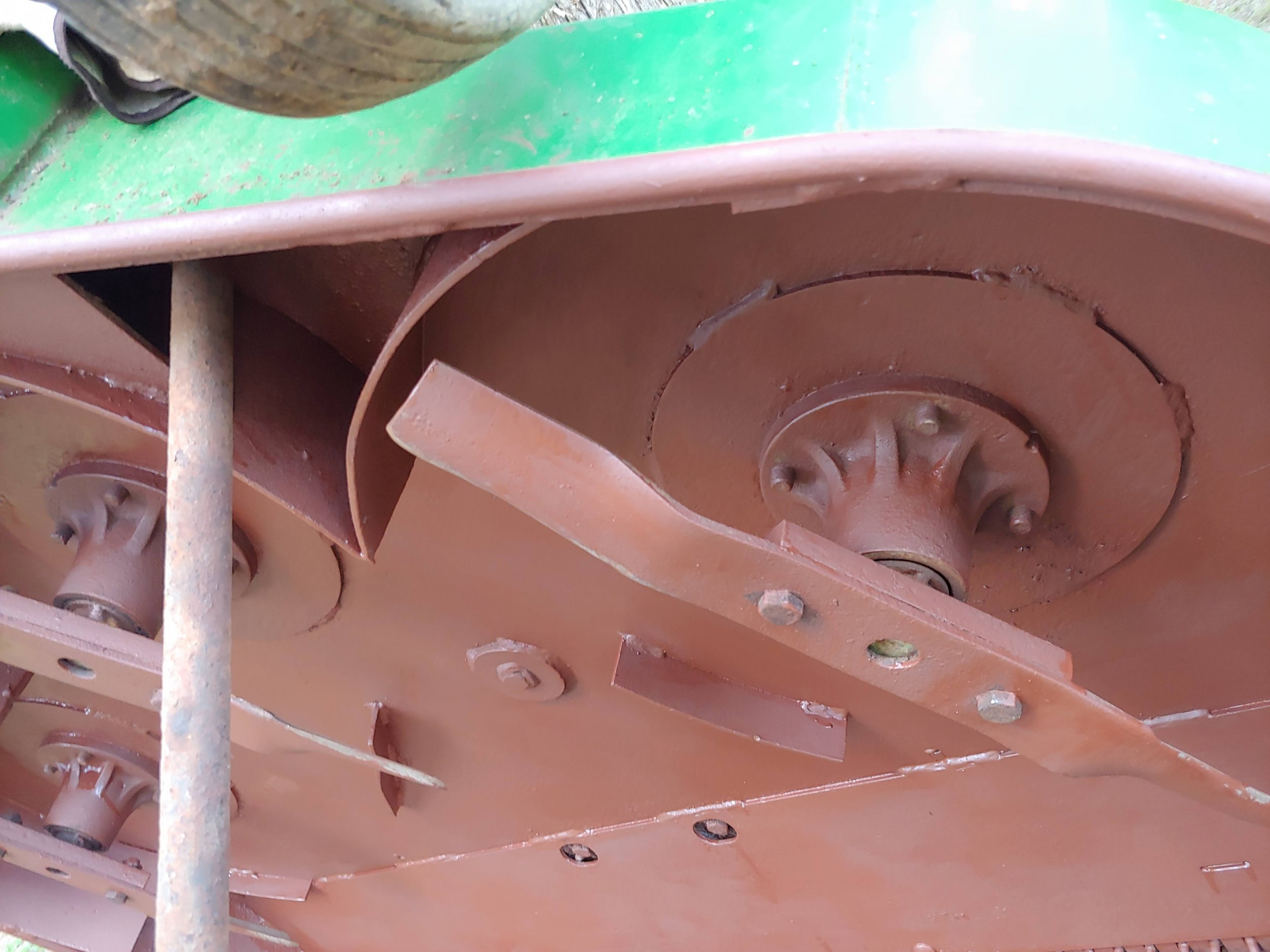

/ L185 Kubota
#44
Got started on the spindles this weekend I got them removed
and the old bearings pressed out. I installed one set of bearing
races but still have the other set to go. Then press everything
back in. Here are a few photos.
Dave
/ L185 Kubota
#45
Got the ol mower back together today and tried it out so far it
works like new and is very much quieter than before I can actually
hear my tractor running now so I am ready for mowing season.
Dave

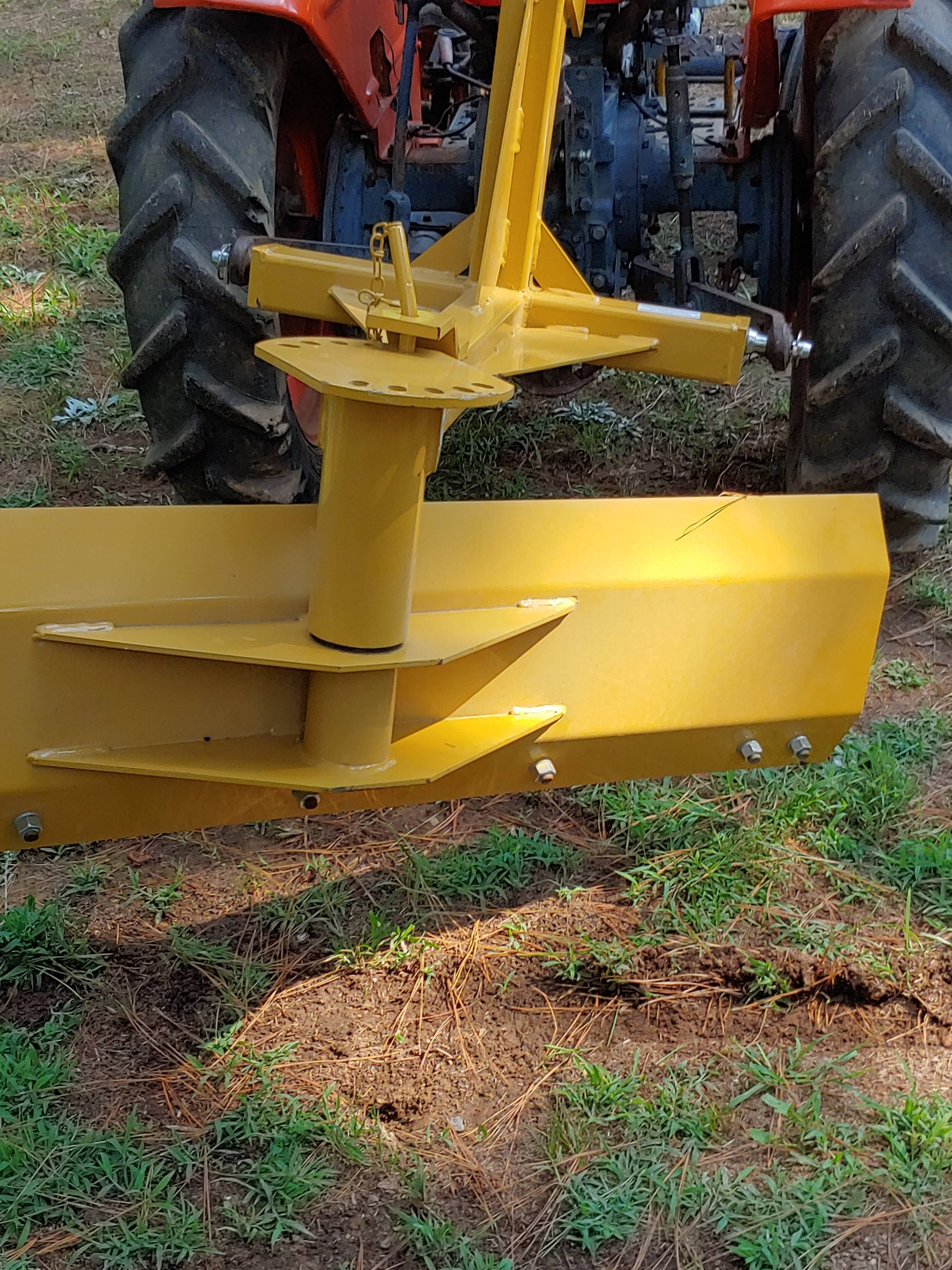

/ L185 Kubota
#46
Another picture of the ol' tractor ready for work.
So far I was nothing but impressed by what the
little guy could do last summer it more than paid
for itself in the amount of dirt I moved with the box
blade and grader blade. Leveled out alot of area and
about to start back to work on it again as the rain allows.
Dave
