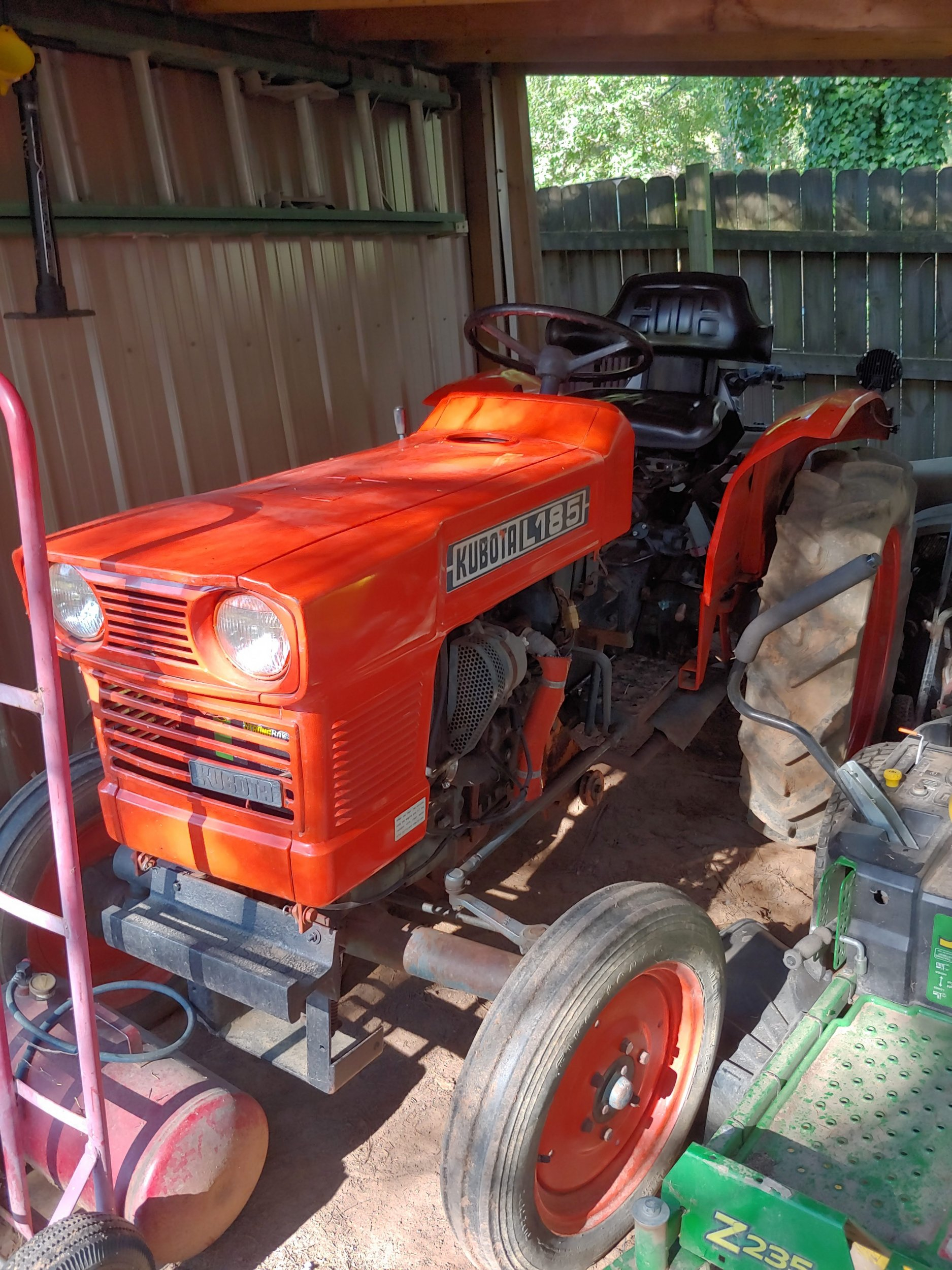

Kubota L185
Picked up a new project today in descent shape and I plan to make it much better, it is a Kubota L185 with 669 hours in very good shape
and I am fairly sure it has the original tires if they were Firestones because that what it has and they have minor wear and look the age of
the tractor due to dry cracking in places. I am going to use it around my place for mowing, blading, tilling, plowing, skidding small trees and misc.
I am going to start out by picking up a change of oil and filters for it. I have ran about every kind of equipment there is including tractors but this is
the first one i have ever owned. I need to buy some equipment so if anyone can give me some advice on what size mowers, blades and etc. I need
for it I would appreciate it.

Dave, Nice find. It's a Gray Market version, yet still durable.
I attached the engine service manual. That's all I have on this model.
Additionally, the L185 is related to the L235 & L275. The OPS manual is attached for those.
Typically, a 6FT mower or less width, straight blade is no more than 1-FT wider than the rear wheels each side.
Because it's a Gray Market, you would need to measure the rear PTO spline shaft diameter and count the splines to verify it can match American implements. AND, ensure it spins the right way. ;)

Judging by tires, you have the 2-WD model L185FP.
There is only so much a 17-hp, 2-WD tractor weighing a scant 1,595 pounds can accomplish.
I am going to use it around my place for mowing, blading, tilling, plowing, and skidding small trees.
Mowing with a 48" Rotary Cutter or a 54" Finish Mower should be fine, plowing with a 12" single bottom plow marginal but OK in moist soil, roto-tilling more likely to be satisfactory than moldboard plowing, blading probably not too realistic, skidding small trees OK.
Fitting contemporary Three Point Hitch implements to your tractor may or may not be tricky. Research fit carefully before buying. T-B-N is a good place for "fit" advice.
Your implement choices will pretty much be 48" to 54" width in the lightest weights due to traction limitations.
A good find and a good tractor to learn with.

What a good looking tractor. If it were me, I get some implements but leave the basic tractor alone. I wouldn't do any mod that could not be un-modded quickly. Change all the oils, etc but that tractor is great as it is for light work around a home or farm. It's a keeper if it only pulls a lawn mower.
I don't think it's gray market at all. I've seen a number over the years and gray market never entered the conversation.
