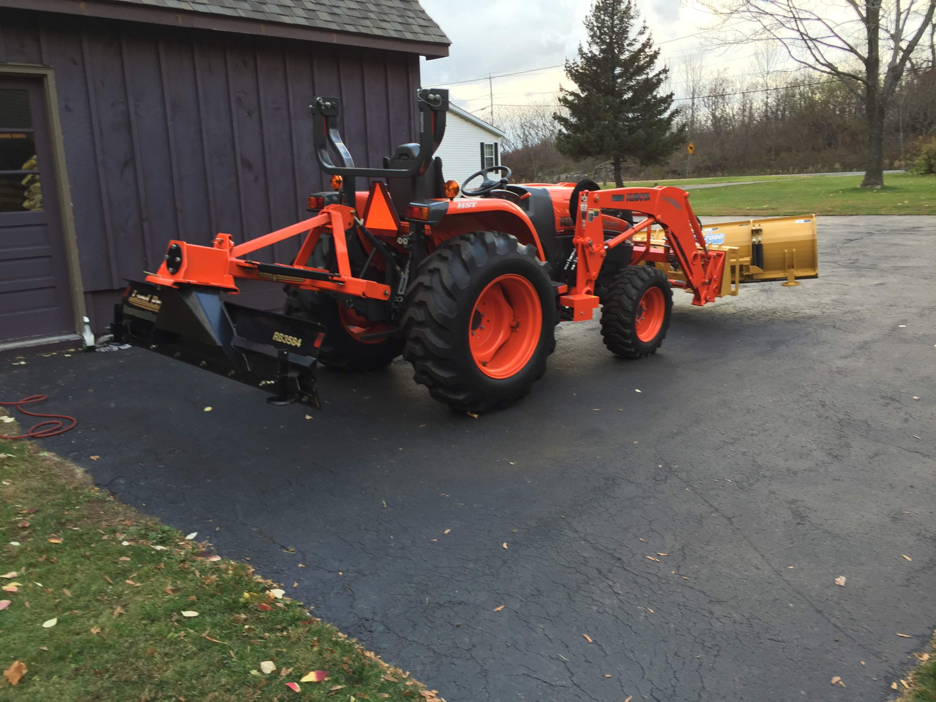

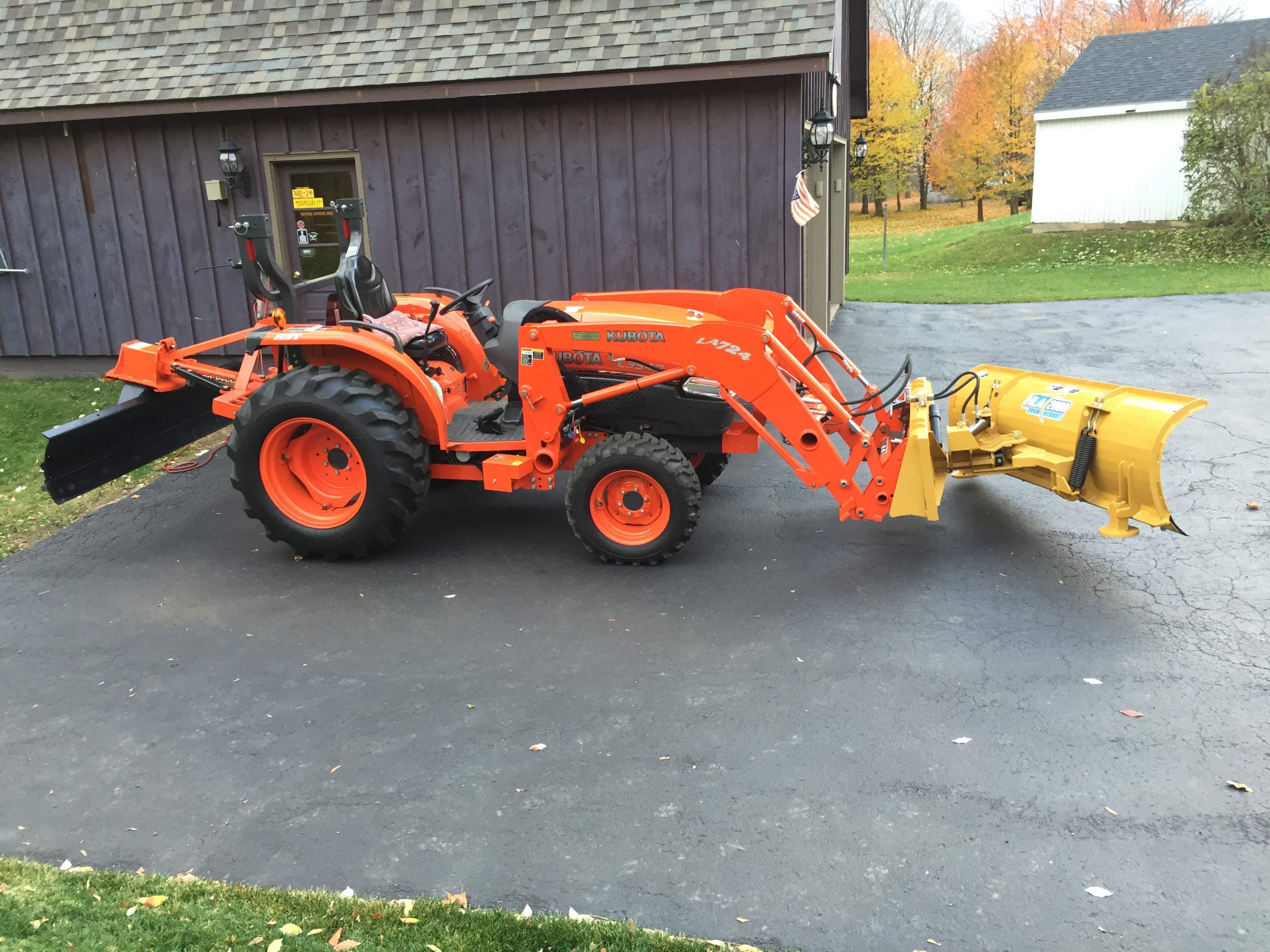

I have a Grand L HST 3540 which I just can't say enough about it, Great Tractor for whatever task I have to do. Summer time it runs a Woods 72' RFM and does some landscape work. In winter on front either the HLA front blade or 72" HD bucket, on the rear either the 84" Land Pride back blade or the L2674 rear three point snow blower!

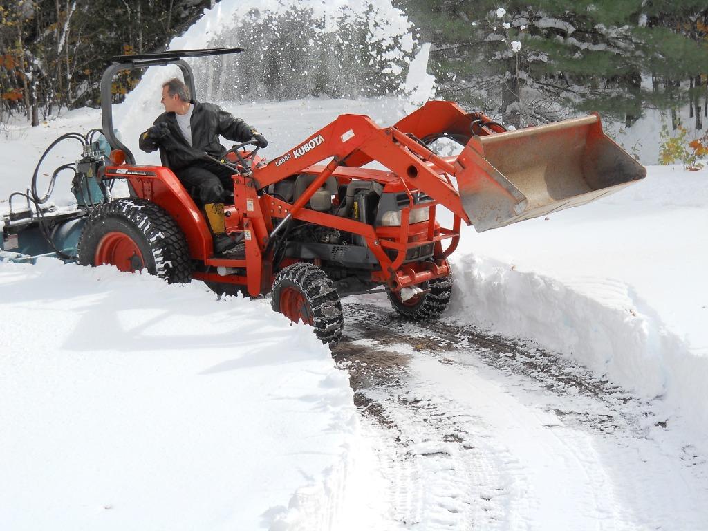

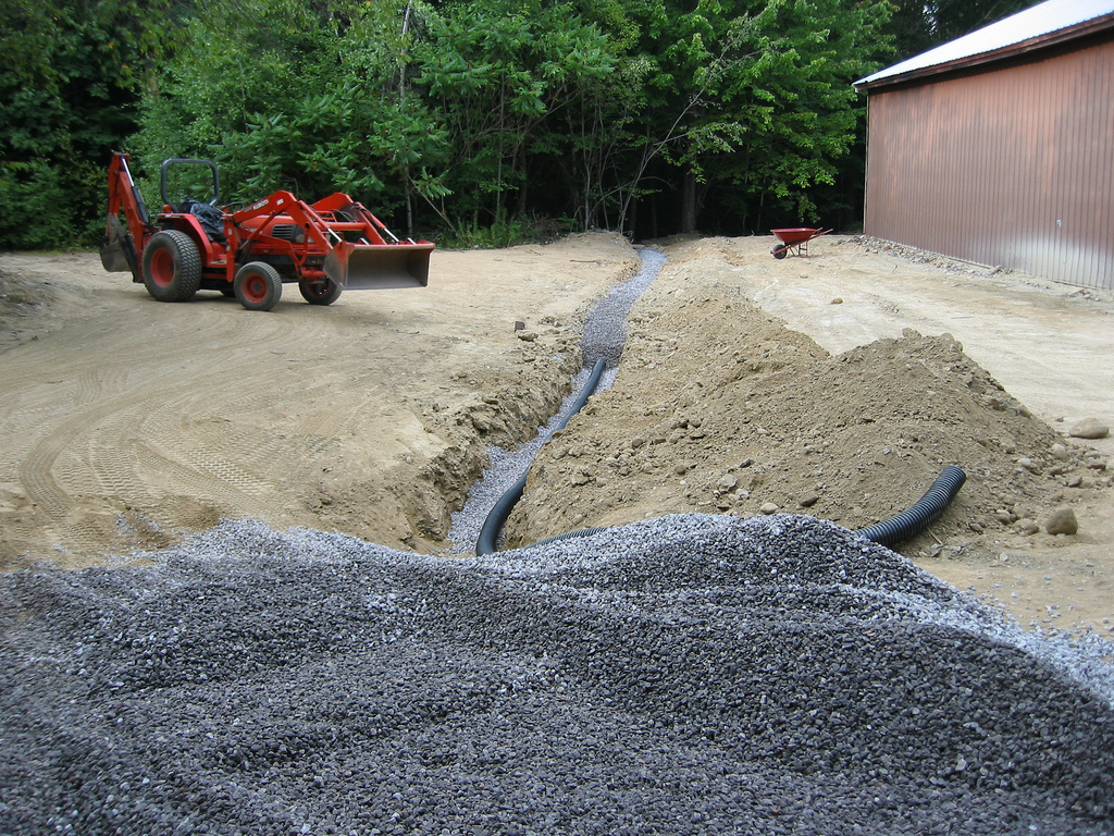

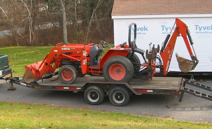

Any L series owners here? I'm a first time tractor owner with a nearly new(13 hours when I bought it)L3200. Any advice or suggestions?
Yes. Find your nearest BX and run it over. L's rule. My L4200 had 2000 hours on it when I got it. Now it has 2700 hours - I had to replace the starter, and that's all I've had to do for it in the 10 years I've owned it. In the meantime, I've done no less than $50,000 worth of work on my own properties with it.
